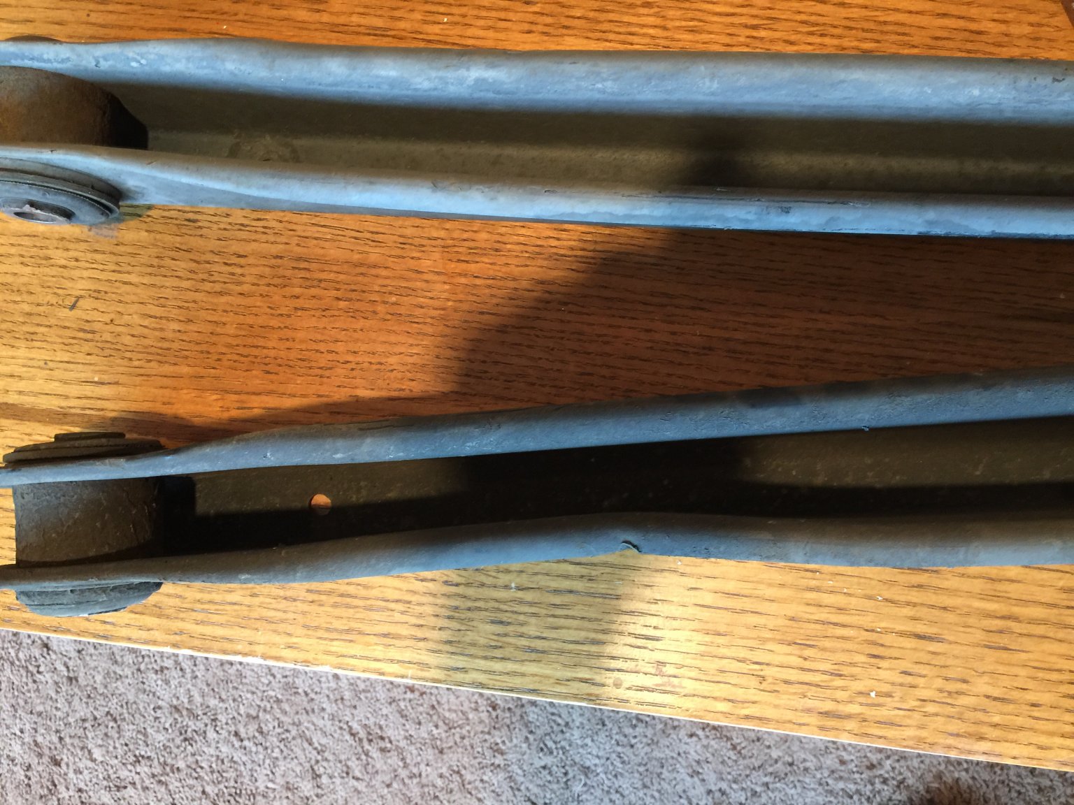

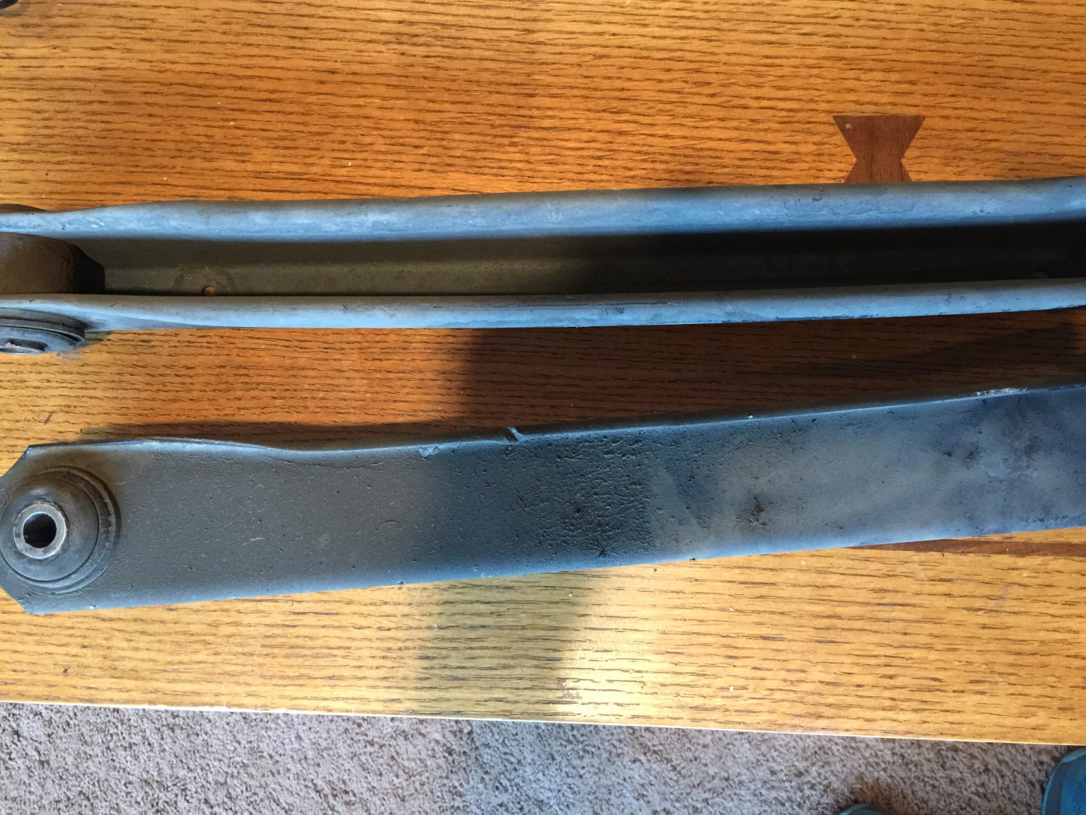

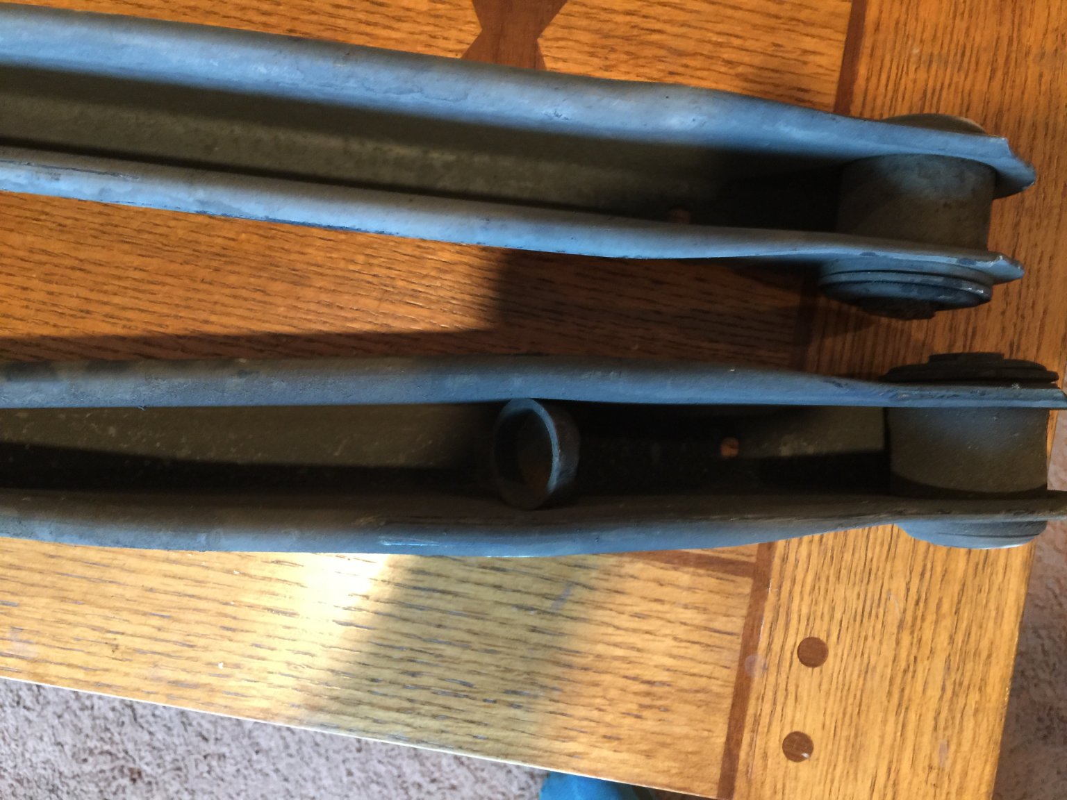

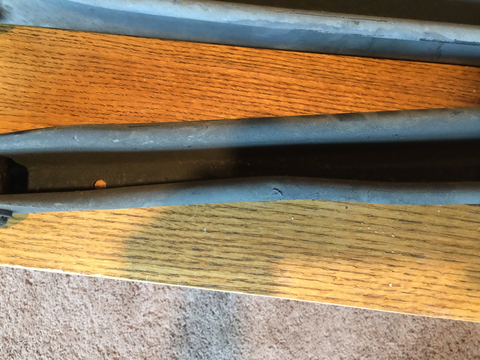

I dug the old lower control arms out of the trash to re-take pictures of them and noticed one had been bent at some point and also had a round piece of metal wedged inside. interesting but it also shows how weak the stock ones are. The Spohn are beefier than hell.
