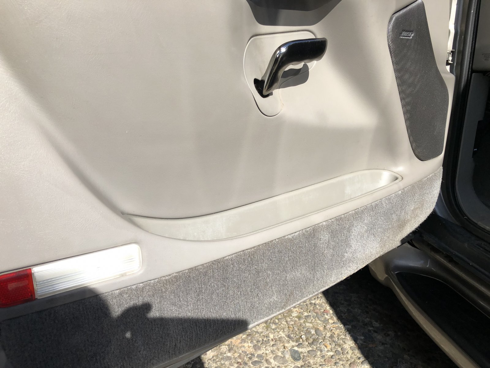

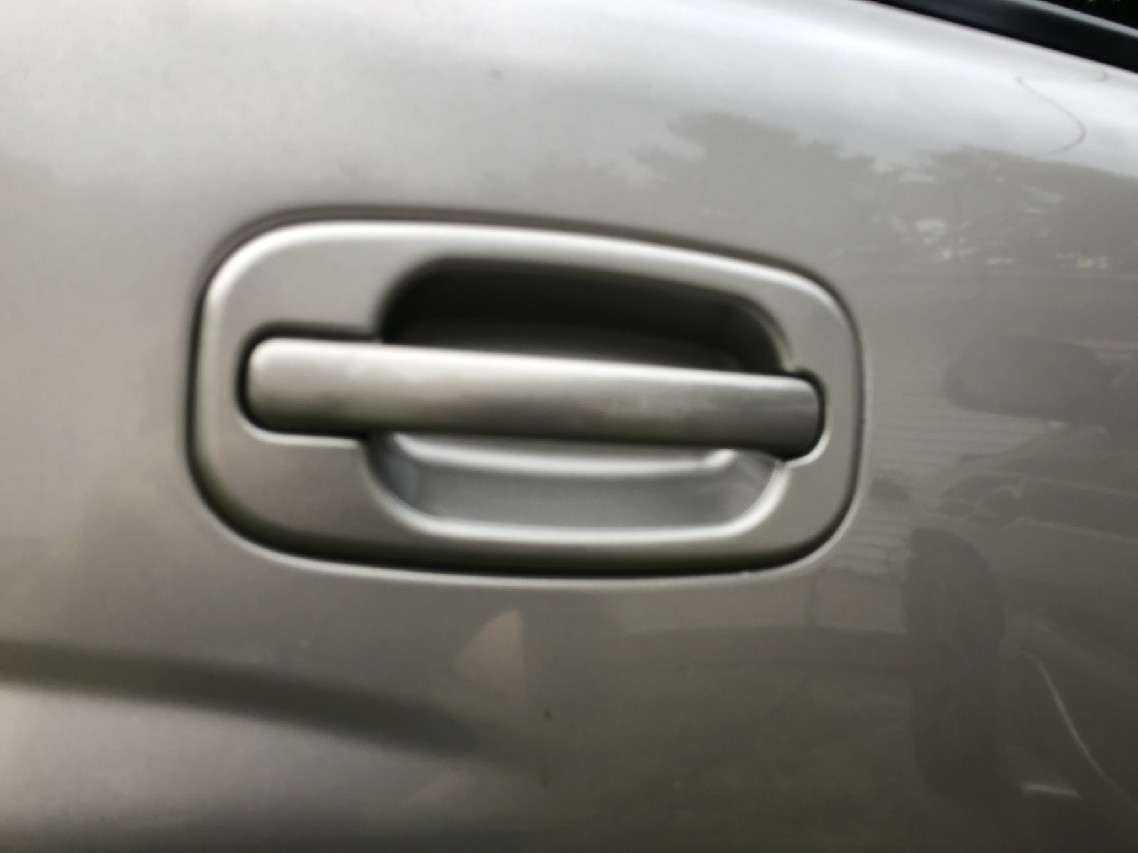

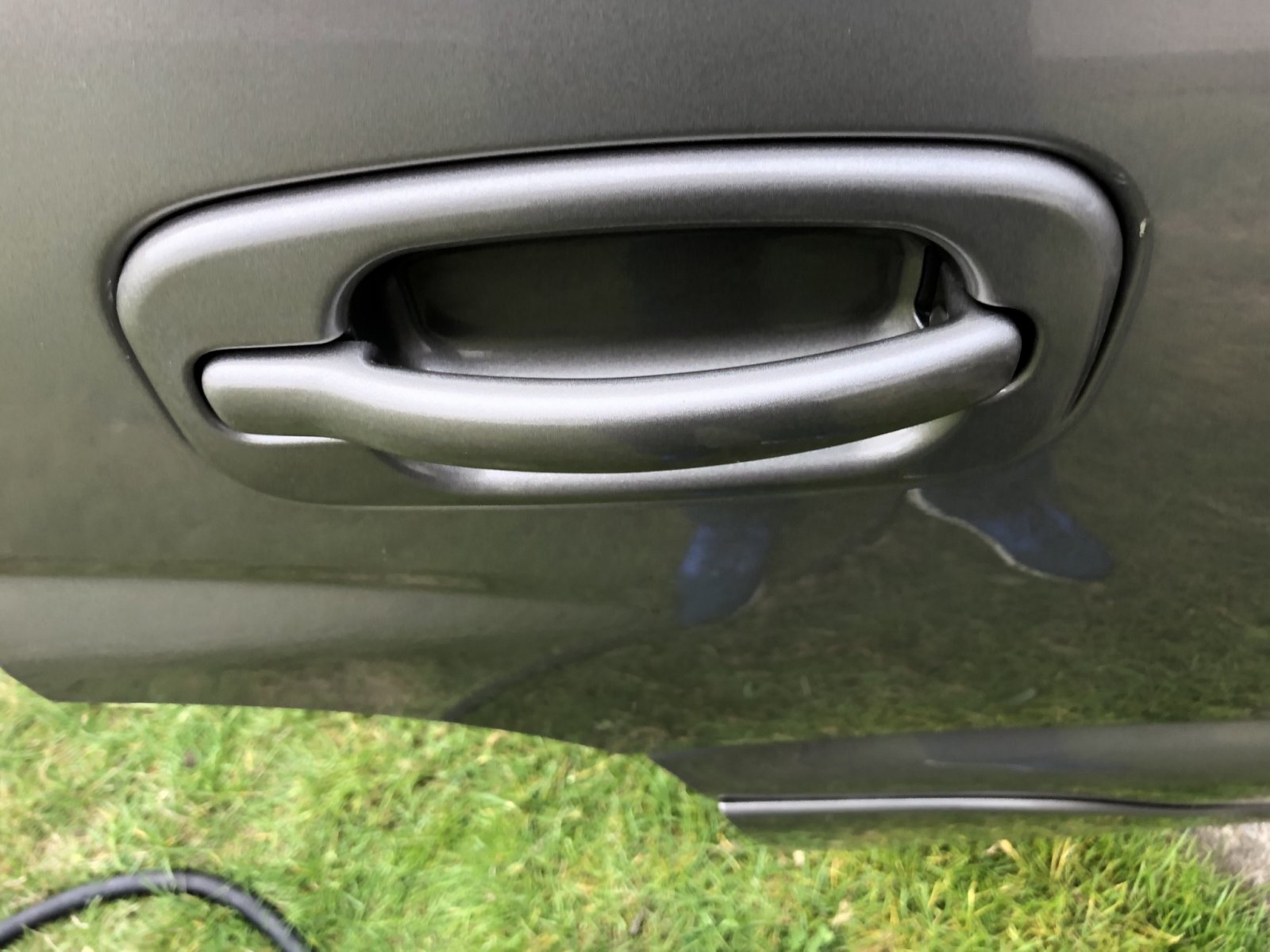

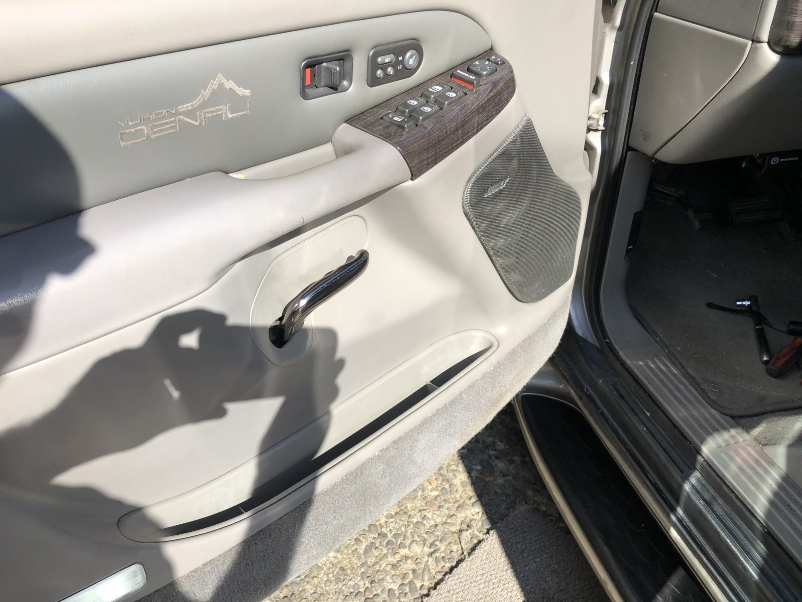

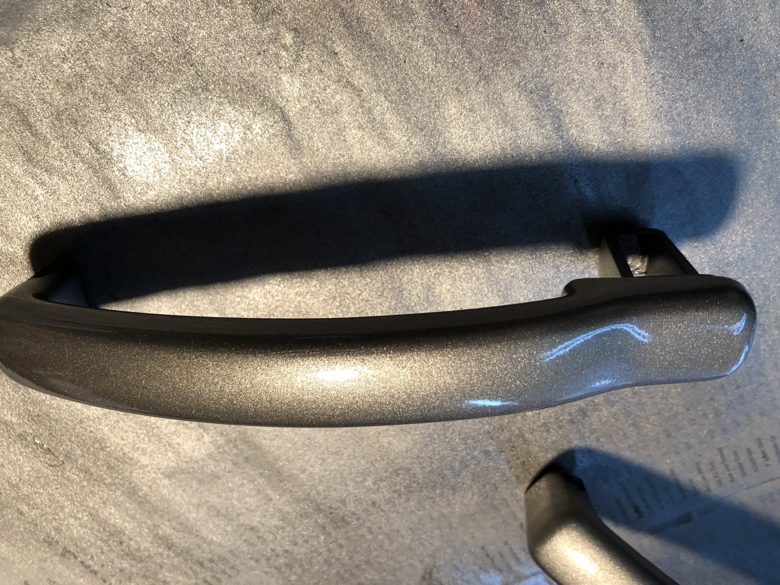

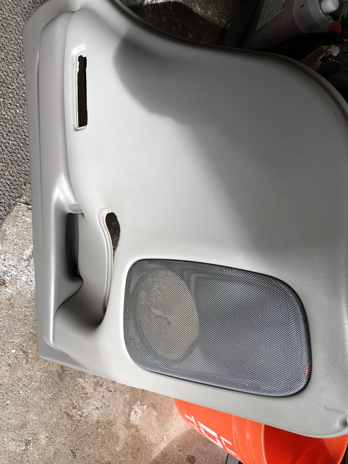

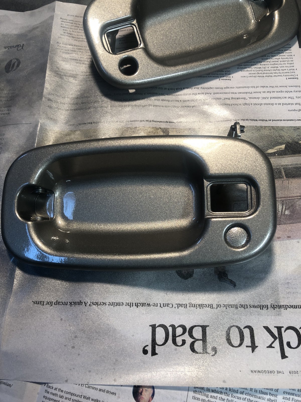

I’ve been doing some work on my door panels and painting the exterior door handles that were worn and had white plastic showing through. I painted the speaker grills with the same color paint that the console is done in, kind of a dark pewter I think it is. Not too much of a change but I like it, a bit of contrast.

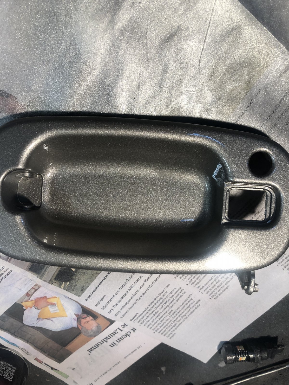

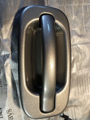

52,956

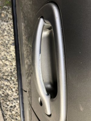

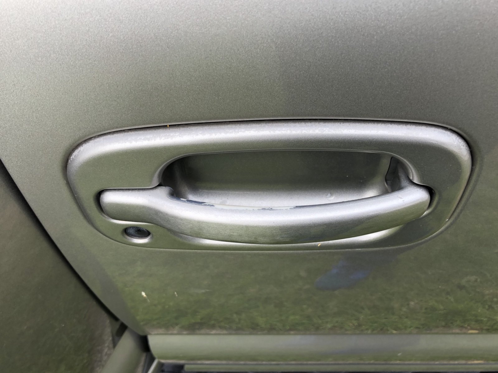

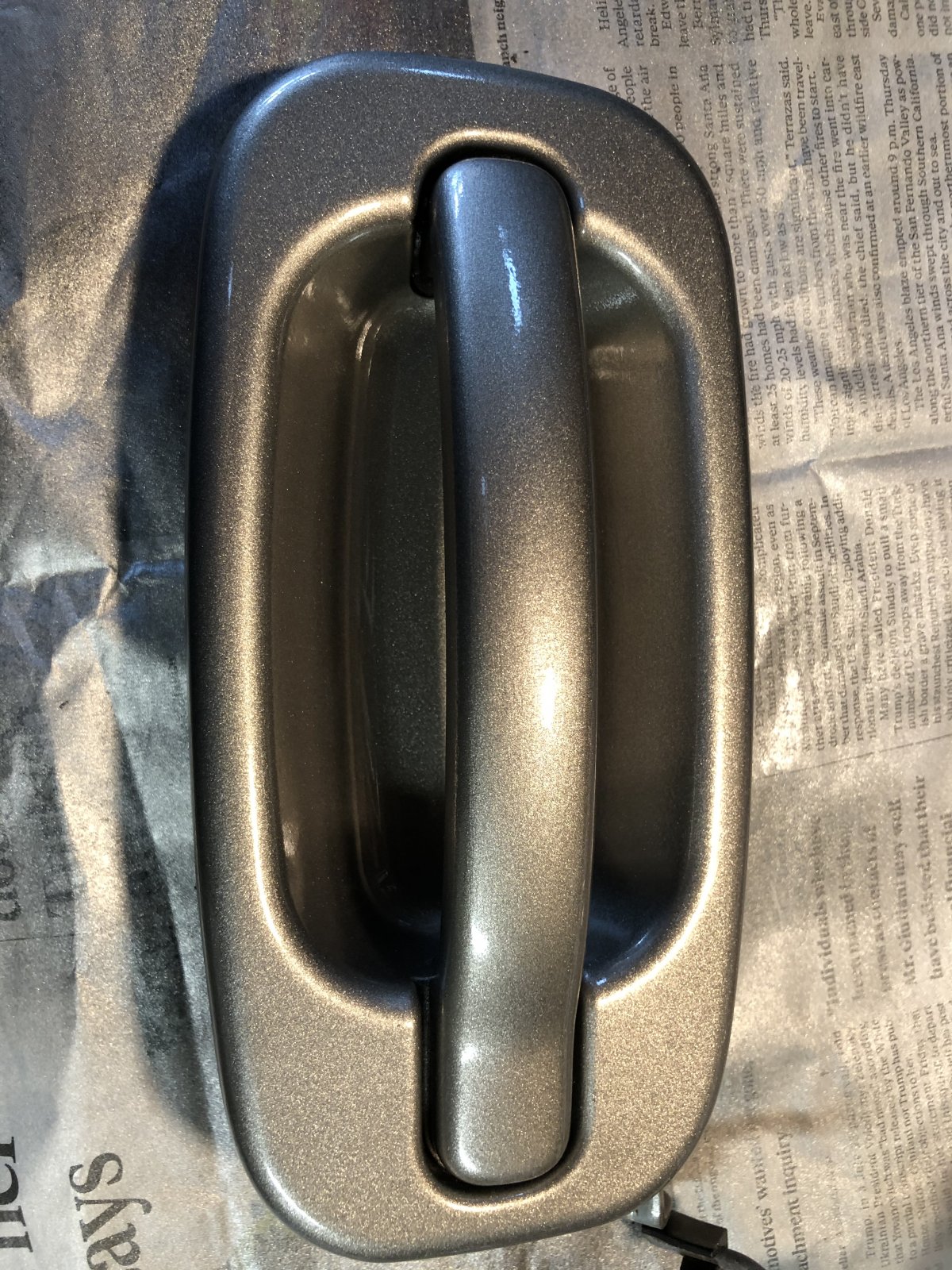

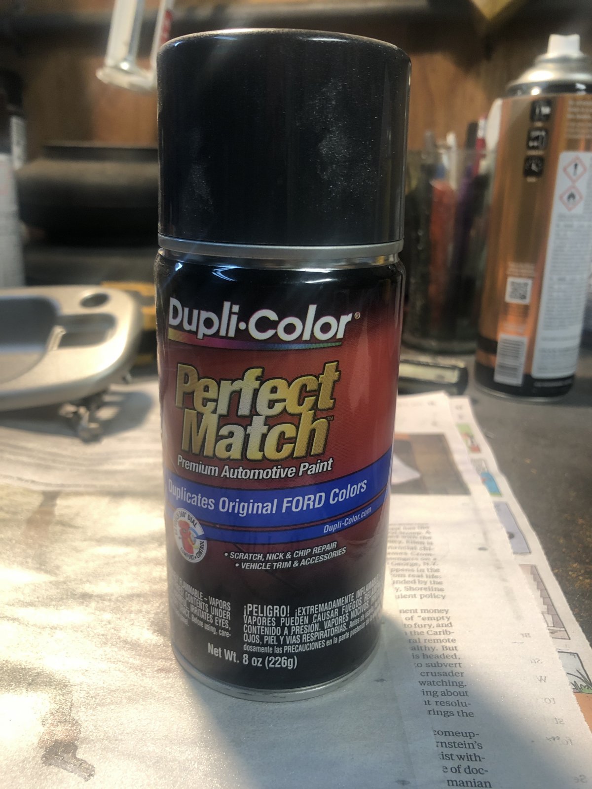

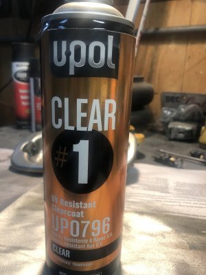

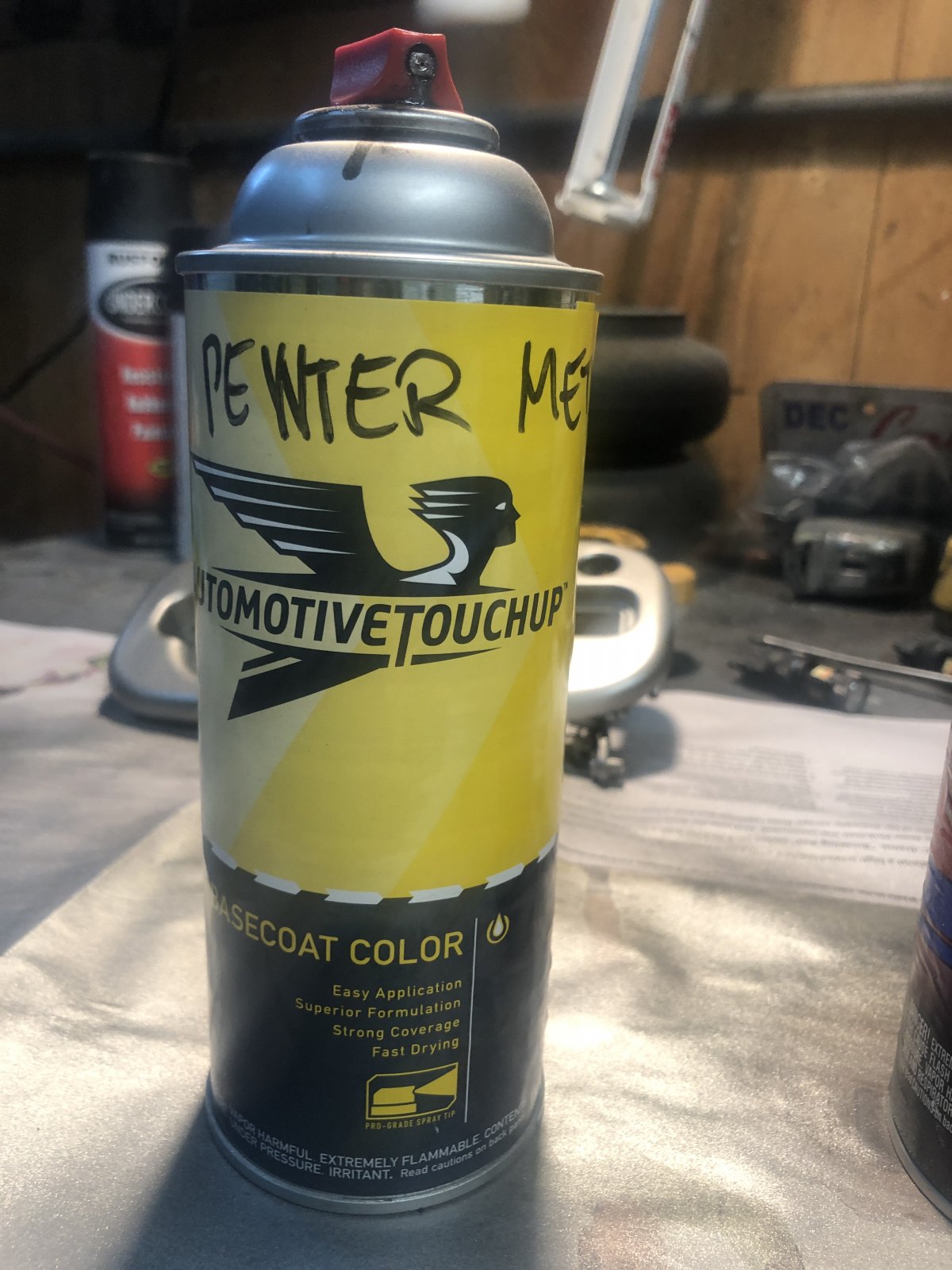

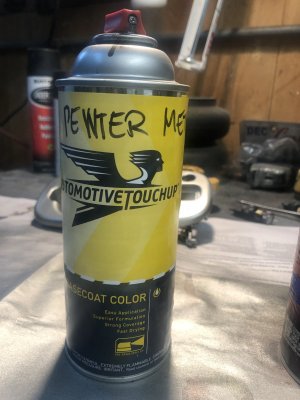

The door handles were going good until they weren’t. I got the rear doors completed this morning after the paint on the handles dried overnight. They came out perfect. I had most of a can of Automotive Touchup left over from an other project and half a can of U Pol #1 clear, plenty to do the fronts too so today I pulled everything apart. I disassembled and scuffed/sanded the handles, painted them and cleared them. I thought I did a perfect job until I noticed one of the parts, the driver escutcheon or whatever it’s called, had a spot in the clear that was messed up. I tried to respray it but noooo. So I removed all the clear, re-scuffed, painted and cleared again. Then as I was spraying a second coat of clear I saw I messed up
and left some clear on the top edge. I then removed all the clear AGAIN, re-scuffed and realized I now had just enough paint for one more try. I just got that done. No more paint. I might have enough clear to do it if I shoot one coat. The next can won’t be here for 3 days. My truck is sitting in my driveway with no handles for the second night. Damn. Sometimes I hate painting.

That's the newer/revised formula of the U-Pol that I was trying to avoid. Since you seem to be having no issues with it, maybe I'll give it a whirl. Although, I did find a NOS can of the original stuff that I'm gonna use first.

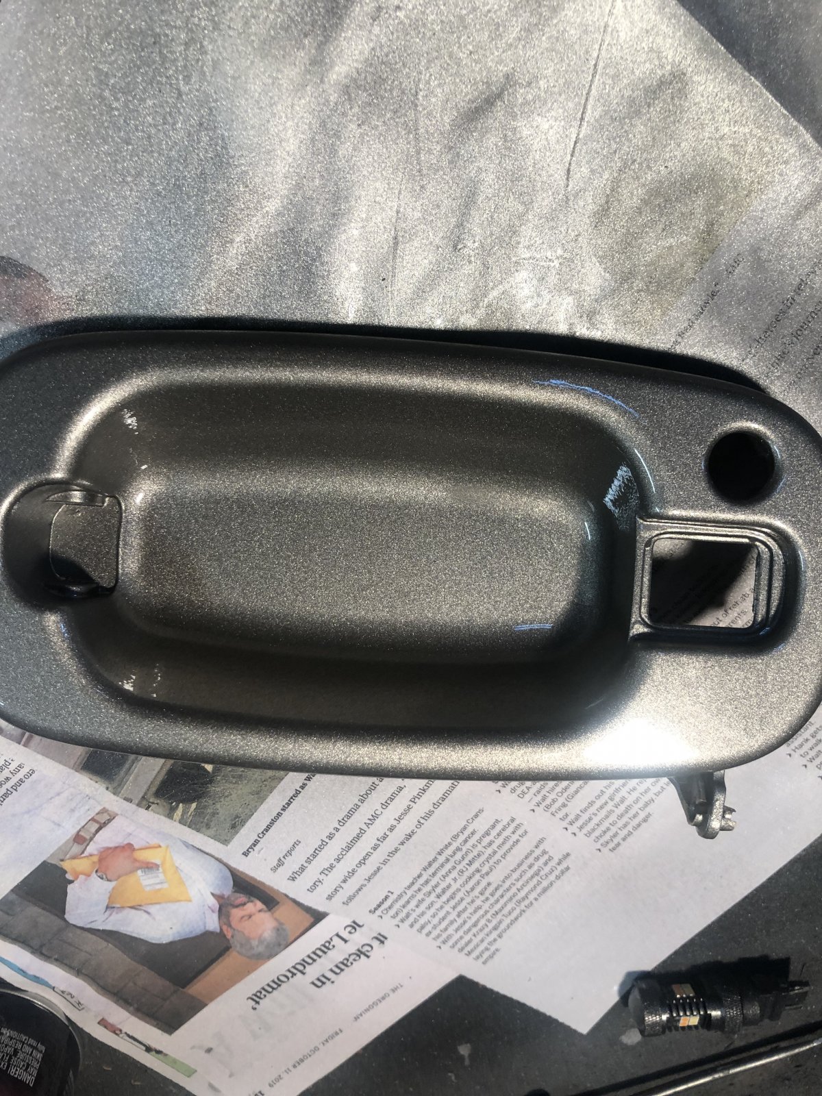

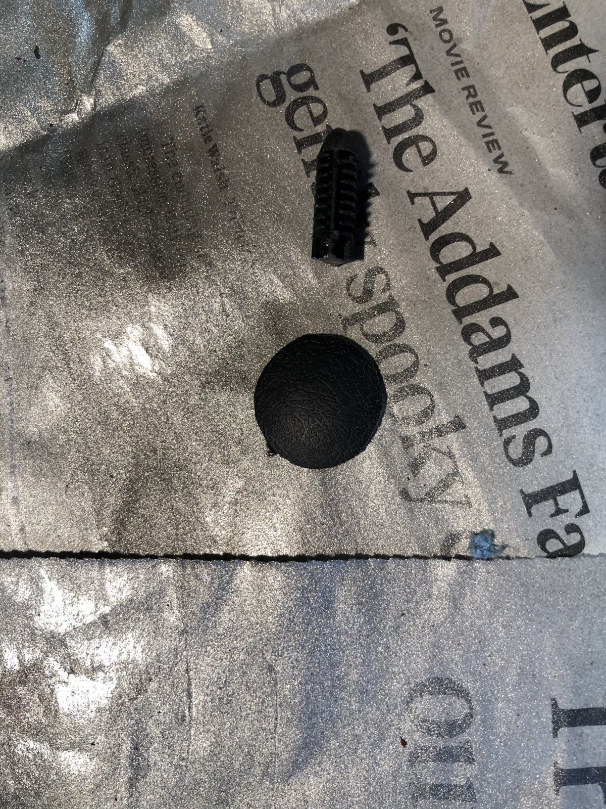

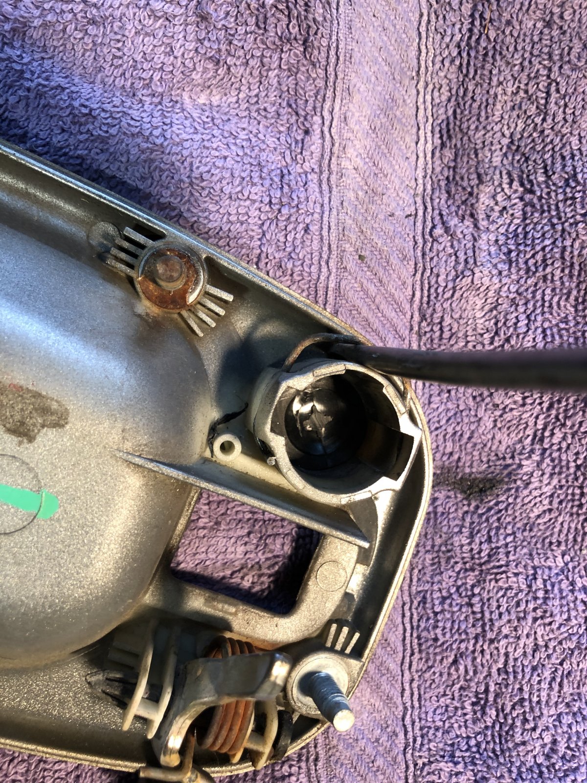

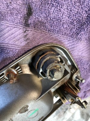

A couple notes. On the passenger front, the lock had been punched in and I had put a piece of black plastic in there back during the aftermath of the break in. I hadn’t pulled the handle then, so this time I did a better job. I removed the lock cylinder from the rod inside the door where it was hanging, removed the rod so it’s disabled, and used the lock cylinder to hold a part of a plastic plug I modded to fit. It’s held in good now and I was able to paint it with the handle. It’s much better than before. The lock is attached with a clip and it pushes down on the plastic to hold it in place.

It’s working awesome for me.

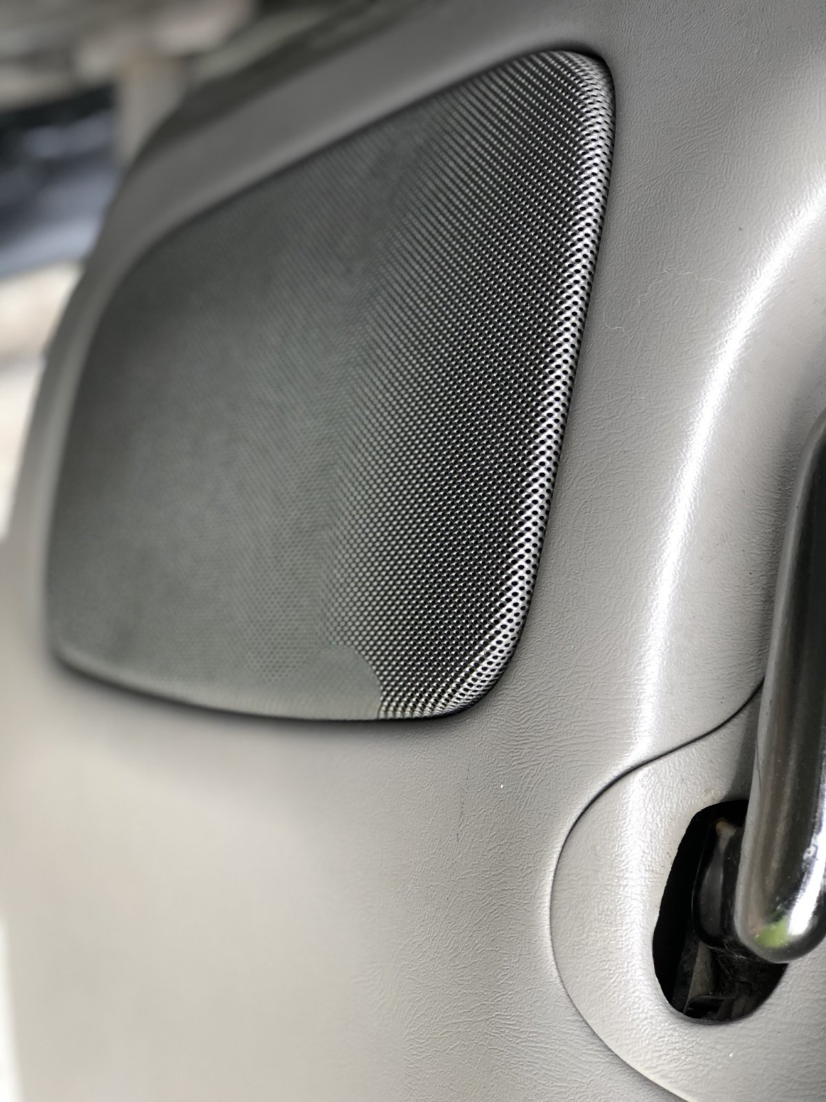

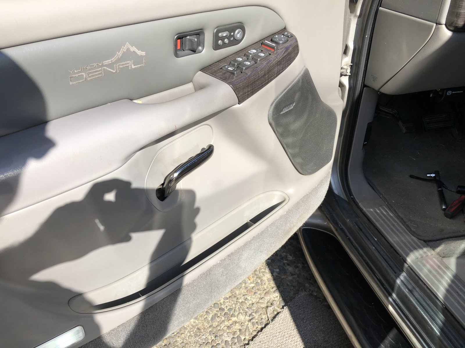

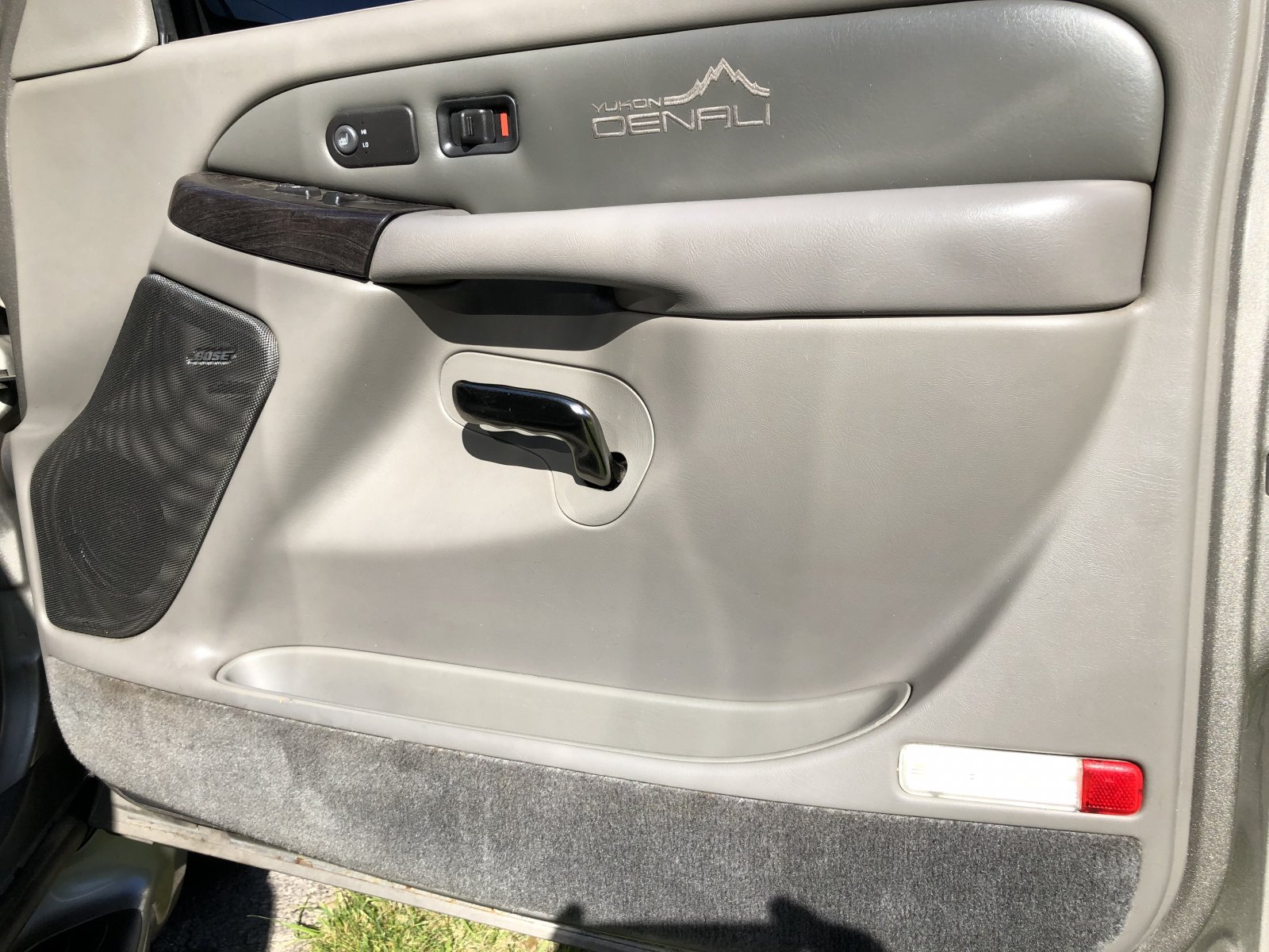

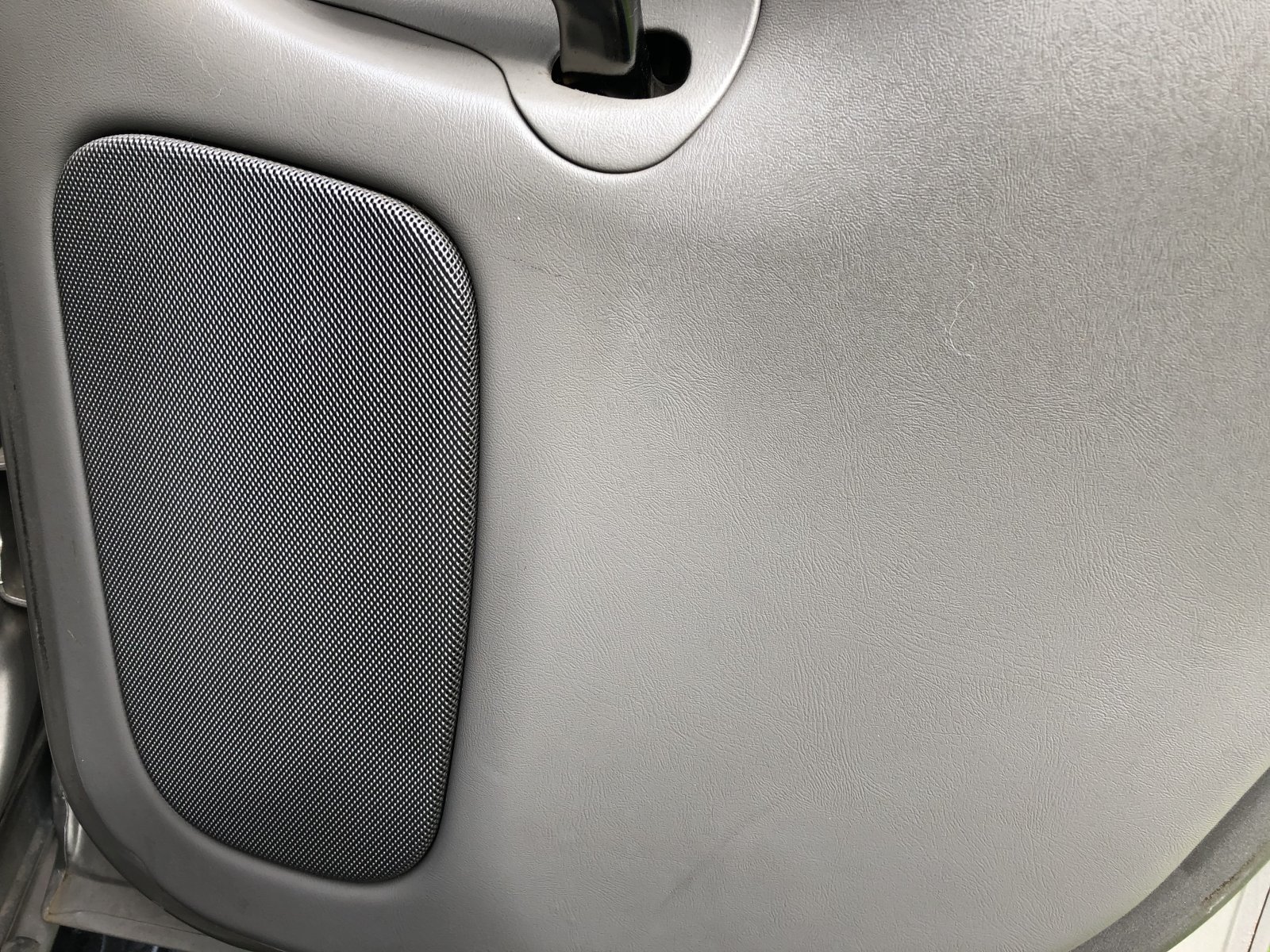

A couple more pics. I also removed and re-glued the carpet on the front door panels because when I first did it, the glue didn't hold well. I used 3M Super 77 this time. You can see the darker color of the grills better on the fronts.

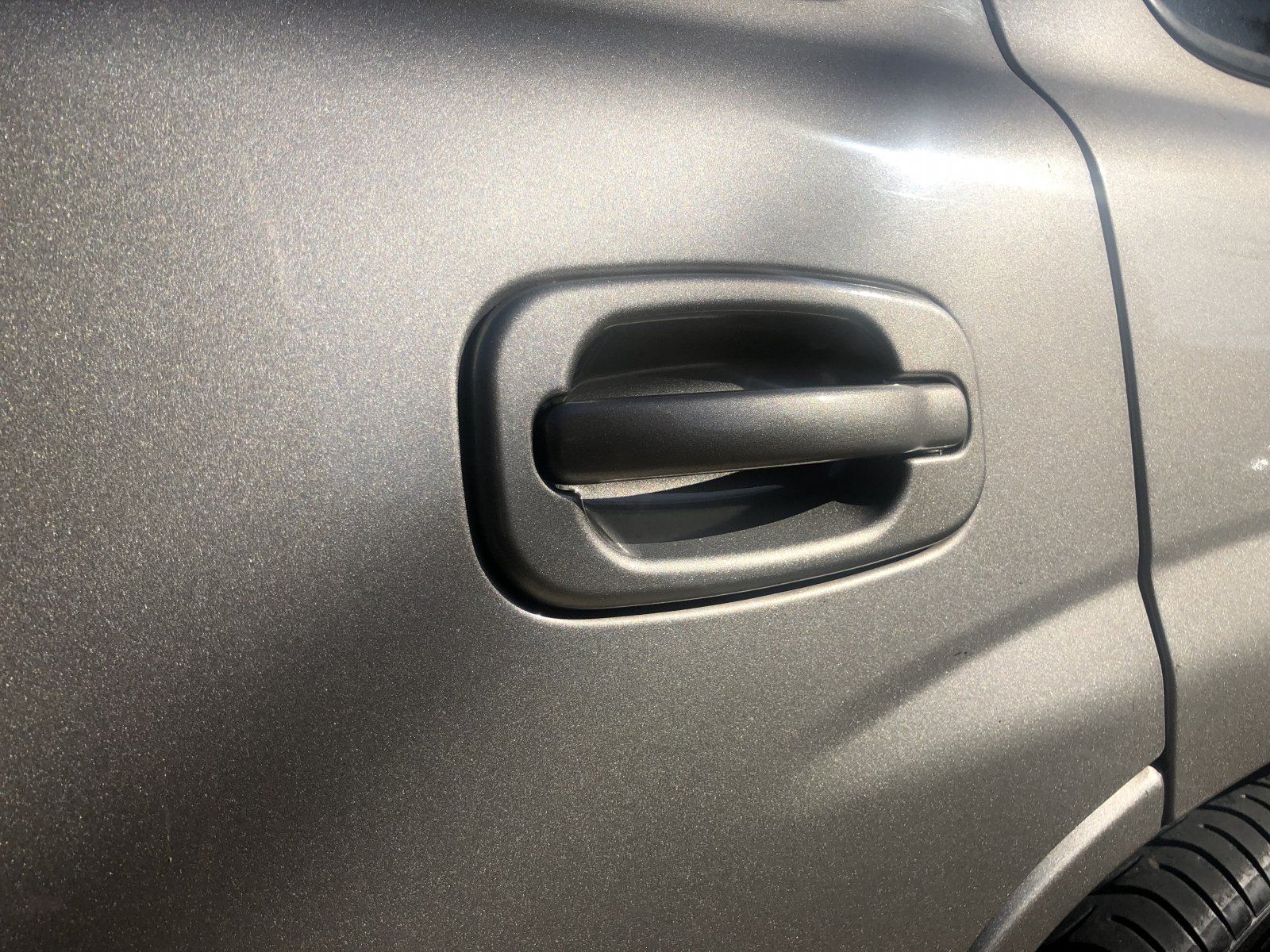

52,956

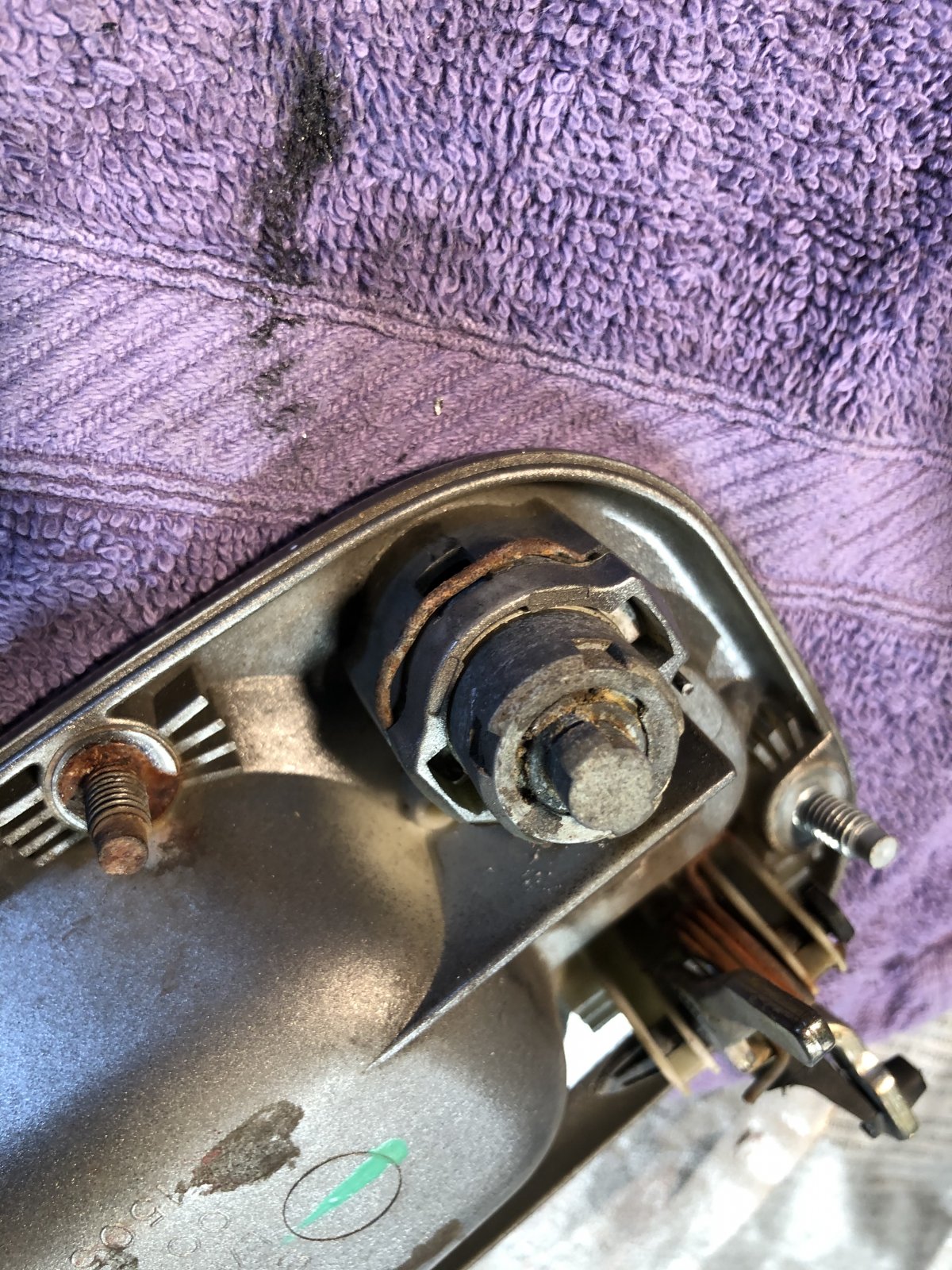

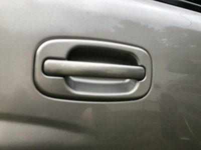

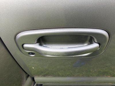

The color match of the Automotive Touchup was perfect. The old handles had looked terrible for a long time. They're like new now. Anybody that's thought about painting theirs , all I can say is do it. Removing them, disassembling and painting isn't that hard. It was way easier than I thought. The rear handles are real easy to get to the 3 bolts, the fronts have one that's a bit hard but if you roll the window down a couple inches you can see it and a 10 mm standard socket fits on it, behind the glass. You have to smash the ends on the pin on the handle itself to disassemble it, and replace with a bolt and I used nylock nuts.

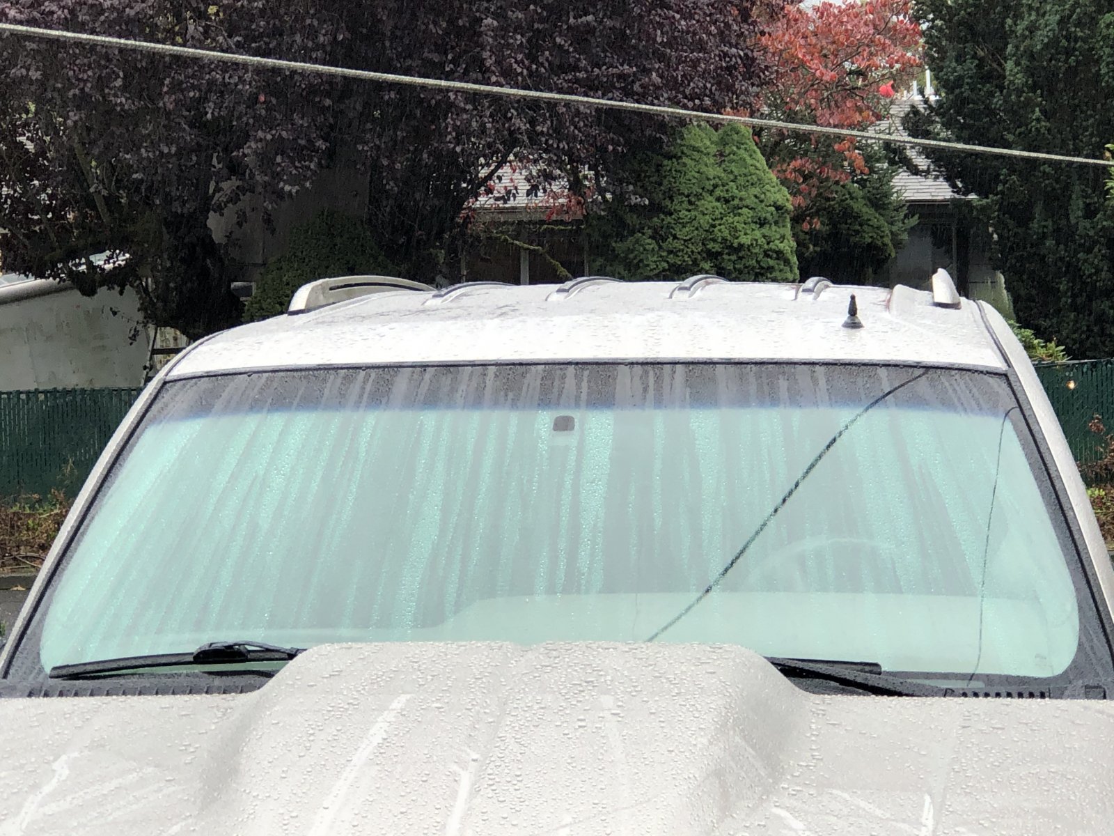

I removed my roof rack crossbars today. I’m going to CM them after seeing what they look like on @adventurenali92 ’s truck. But it looks so much cleaner without them that Ill probably leave them off afterward and just install them when I need them. I might not even CM them, since I’ve only needed to use them twice in the last few years. Sure will be easier to wash the roof, I hate them being in the way. Decisions.
