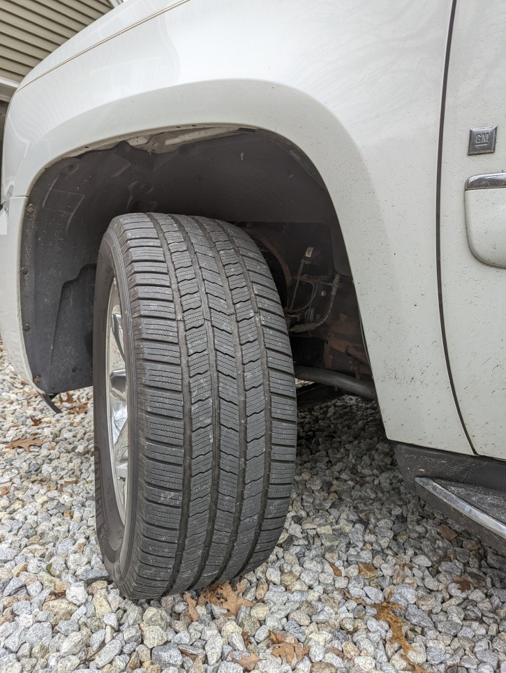

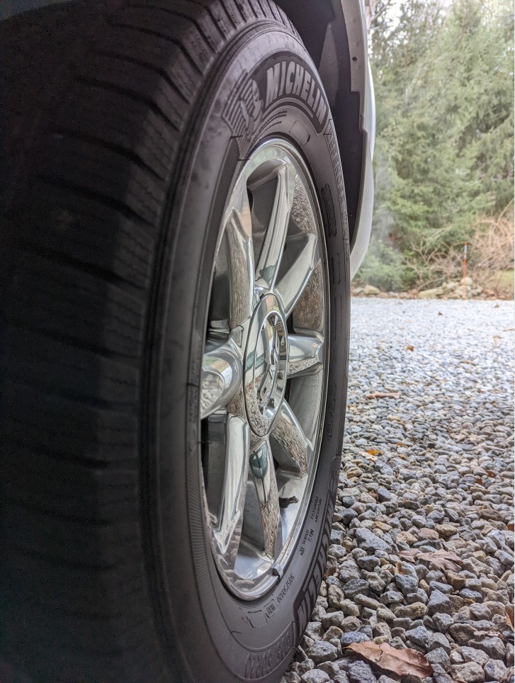

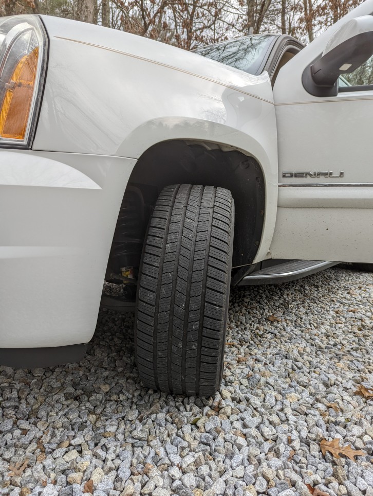

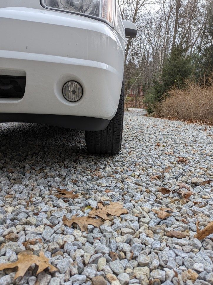

Joseph: Hell yeah dude thanks! Mind posting some pics of your side profile from the front/rear/full lock turns? I want to see how much that section with protrudes and clearance against components. I was set on 275/55R20 - should be a bit closer to OE tire size.

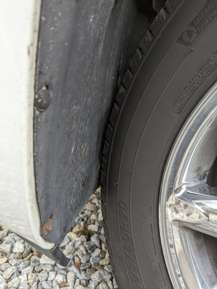

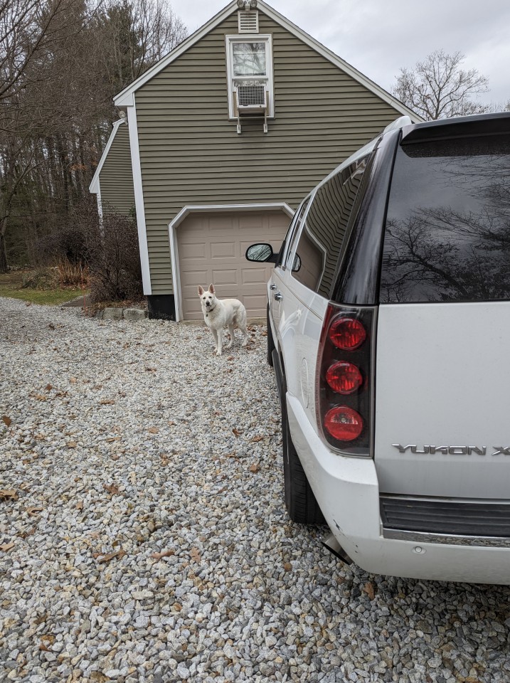

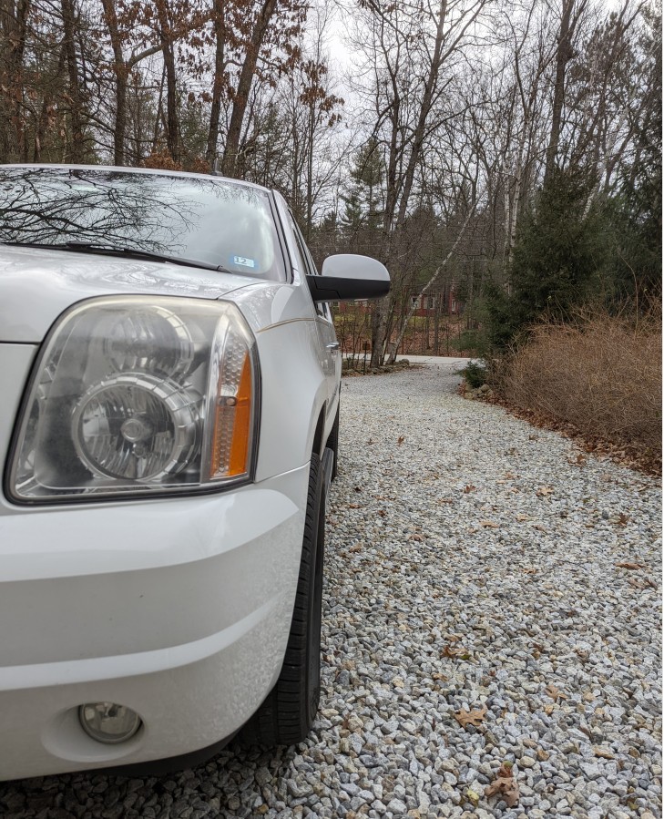

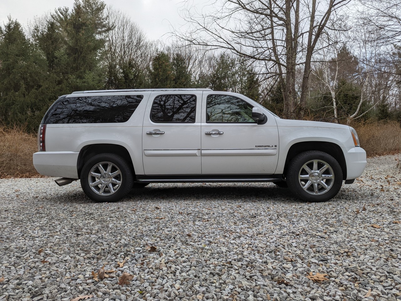

Full side view:
Front corner view:
Front corner lower view:
Rear corner view:
Rear corner lower view:
10,559
15,334
Front full turn out:
Front full turn out trailing edge:
Front full turn in:
Front full turn in leading edge:
Tire and rim profile view:

When I purchased this new-to-me truck, it had Goodyear Wrangler 275/60x20 tires. When I switched to the Michelin Defender LTX tire, there was a significant improvement in handling, but I cannot tell you for sure if that was due to the Michelin vs. Goodyear tire itself, or if it was a result of the lower profile tire.
I am totally satisfied with the Michelin Defender tire, and it has no issues with the NH winter. Let me know if you have any additional questions.
