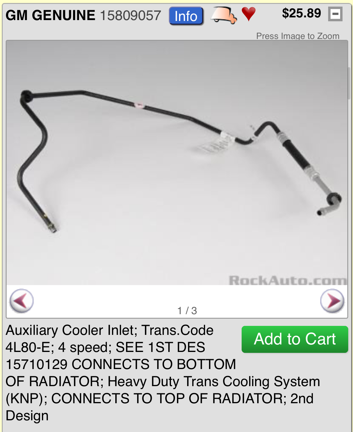

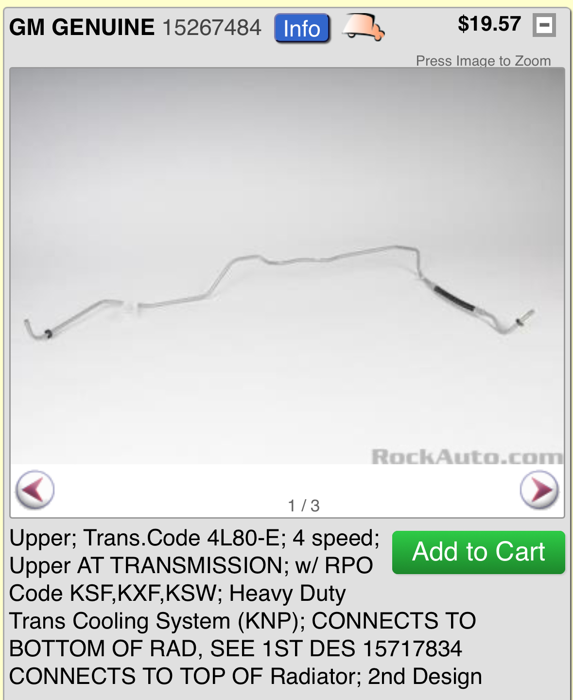

New here, hello. I have a 2000 Yukon XL 2500. Just installed a new 4L80E and replaced the radiator and aux cooler. The thing is, the new hard lines I got are routed slightly differently. GM genuine brand.
The old route: Front trans outlet -> top of rad -> bottom of rad -> aux cooler -> rear trans inlet
The new route: Front trans outlet -> bottom of rad -> top of rad -> aux cooler -> rear trans inlet
So basically the fluid flows from bottom to top of the radiator now instead of vice versa. The new plumbing still fits just fine but it’s throwing me off that it’s different now.
Will the transmission be fine in this configuration?

I asked the same question on another forum and it looks like the slightly newer trucks use this “reverse” configuration, I saw an 04 as an example. Found out the part numbers for these new cooler lines match the ones for the 04 as well. Same with the radiator and aux cooler.
So for an 04, this bottom to top flow is normal…which means it should be alright?
