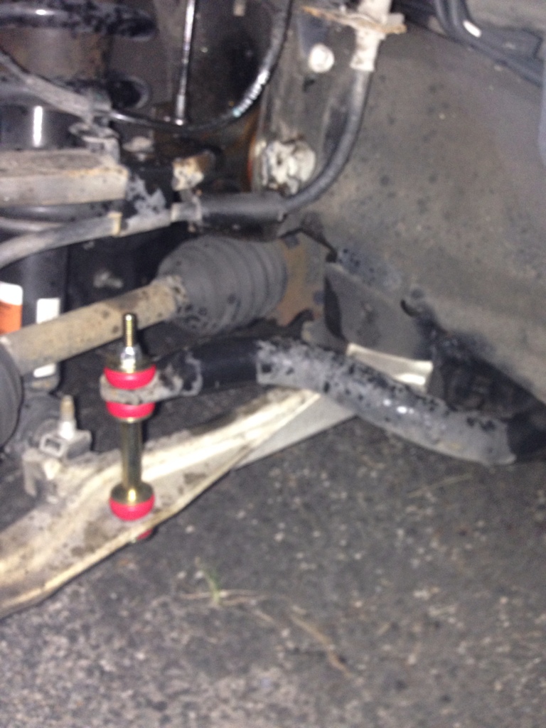

I looked at the front tonight and I think 3/4-1 inch off the sleeve would bring the bar parallel.

Your right the threads don't allow for much cutting. Maybe a half of a inch tops.

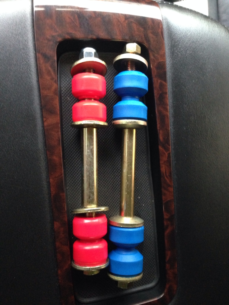

If you need shorter links look at the energy links I posted earlier. They come with different sized grommets so you can make them shorter or longer to work with your setup. I have mine set to 4 5/8 inches

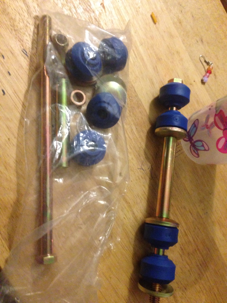

Good idea. I've had some Energy Suspension products in the past and it all seemed to be good stuff. At least the polyurethane bushings would last a lifetime, unlike the factory or other factory style replacement end link bushings. Although, the Moog replacements do look to be of much higher quality than the stock pieces. I never really cared for the plastic spacer or cheap rubber bushings on the factory end links. The Moog's come with much firmer bushings (some applications are even urethane), and also a nice, zinc coated Grade 8 bolt.

Picked these up at auto zone. 9.8117r. Same size thread as ours oem. About 1 inch
shorter
I think a inch or so will get it closer to level for me.

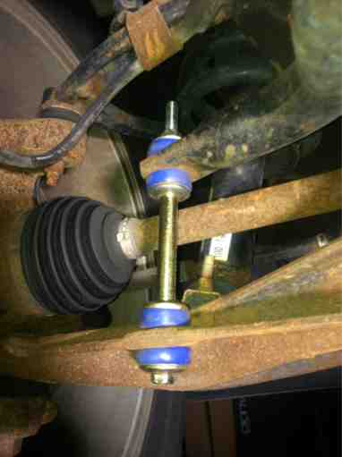

Got the new ones in. Probably could go shorter a half inch more but I think this is close to straight. R

Can't tell yet. Probably won't be able to tell at all but it's a step in the right direction. Lots more tweaking to do.

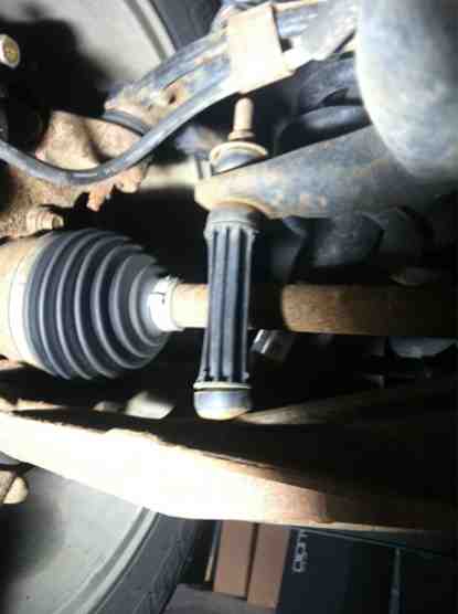

I just replaced mine today, steering felt weird for about a week when going over small bumps at low speeds like pulling out a driveway. Then today I heard a clunk, came home and took a look under the truck and found my drivers side link broken. Took about 15 minutes to ****** out and replace both.
I'm just glad I remembered reading this thread an knew what it was right away. I just checked them about 3 weeks ago when I did my oil and they looked fine just a little dry rotted so I planned on changing them soon anyway.
Before - Oem
After - MOOG
