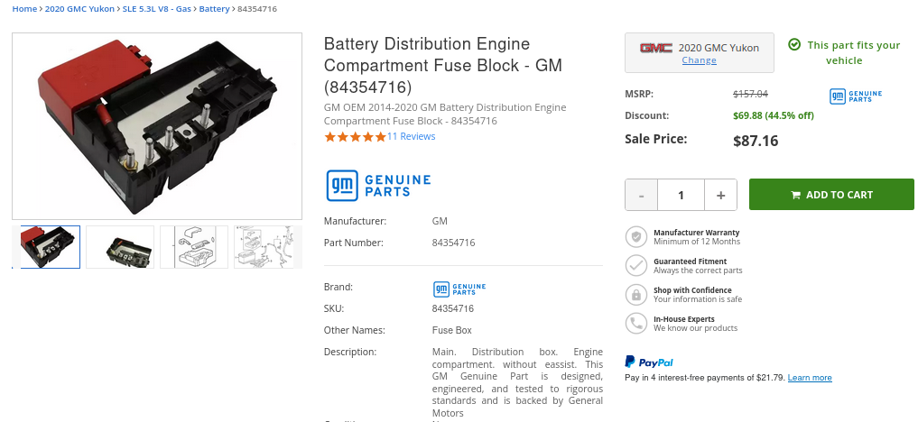

Checked the main fuse block on top of the battery?
Also shown here at around 5:35 or so:
Will look something like this:
