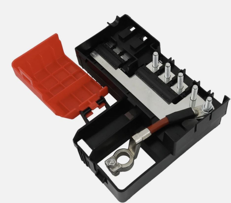

where is the fusible link located or what does it look like? I have a 2020 gmc Yukon with the same issue I believe and I can't find where they're located or what they look like.
30,744
48,427
it is the big multi wire connector that sits right on top of the battery, can't miss it...
each of those connectors is a fusible link, depending on the system each connector is rated for different amperage and it is stamped on the panel so like 80a 40a, etc
the only one without a fuse is whatever goes directly to the positive post.
will look similar to this if not identical, some vehicles vary a little
