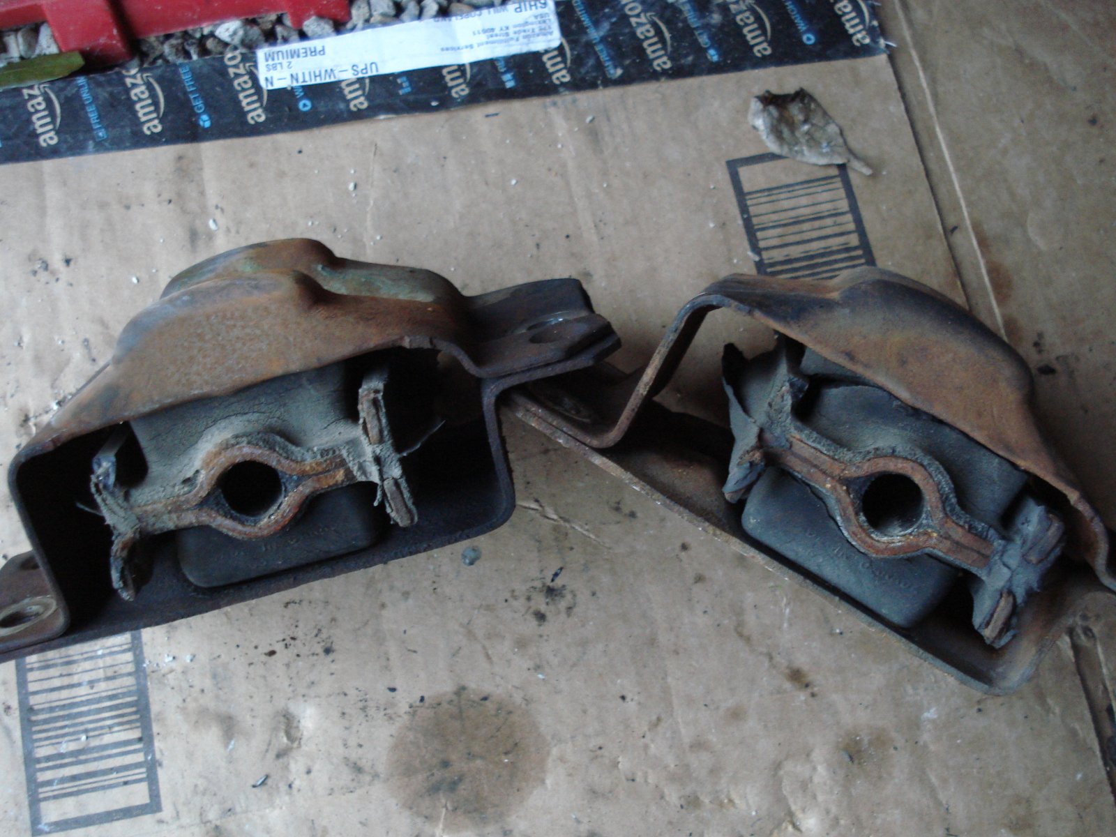

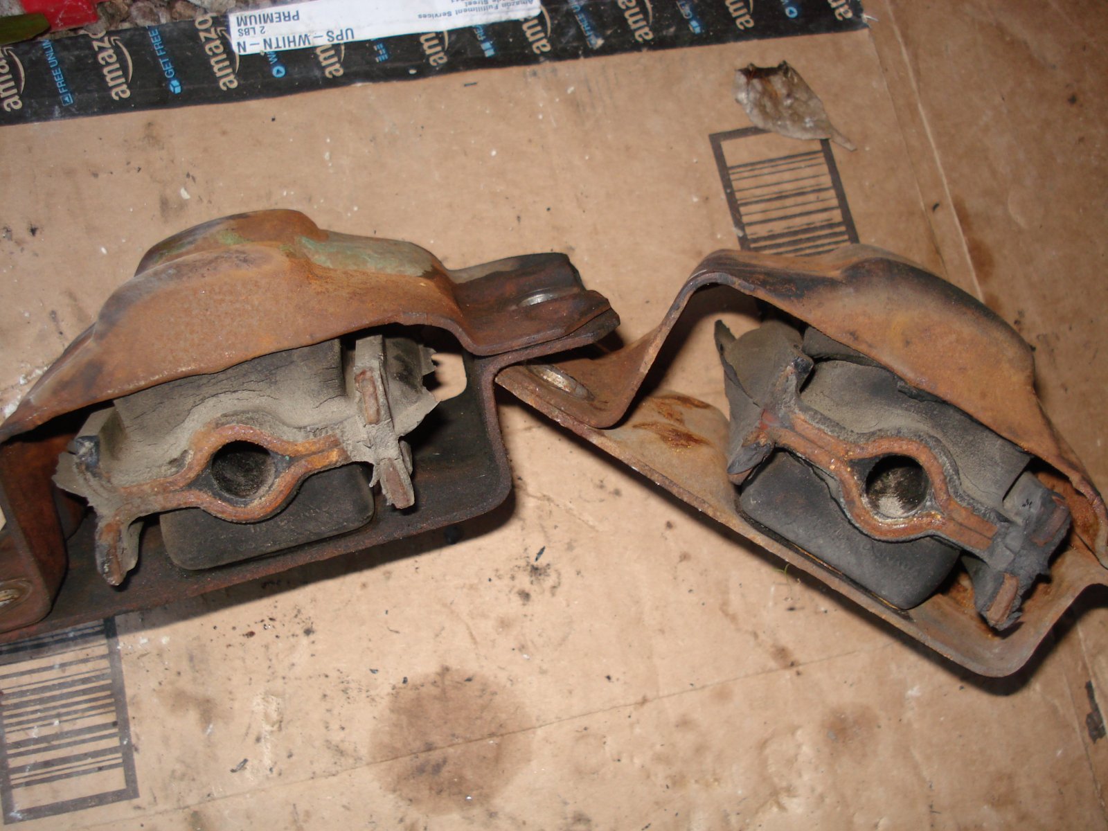

This sucker look like its moovin a lot?
I took it off doing some work and just never put it back onThat does not look like a bad motor mount to me. What did it do when you shifted to reverse and throttled it? Plus, I would hit the throttle a bit harder than that as well.
Also, is your fan shroud off in anticipation of the mount replacement or just to check in case was bad and fan may have hit the shroud?
