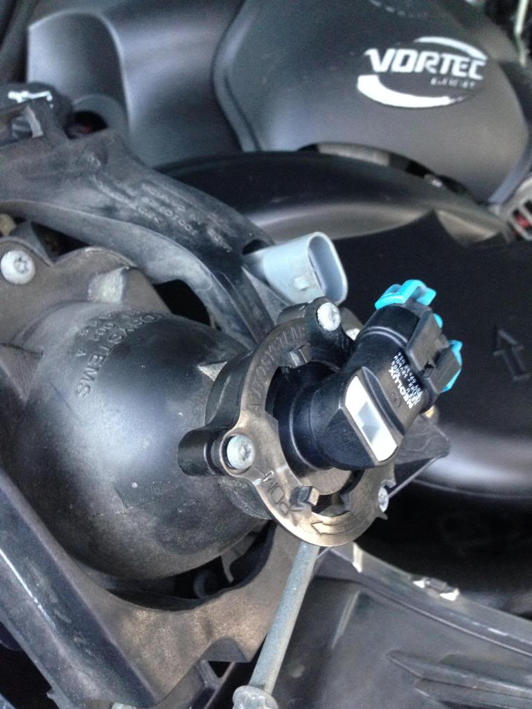

Any idea if the black piece that holds the bulb in place is replaceable?
I've looked online and did some searching elsewhere. When I got the Yukon someone had put the wrong size bulb in the housing (9006) and tried to make it fit, well when they did that it broke the piece that holds the bulb in place.
Thanks

Pull the screws out of it, use some epoxy and a piece of plastic and try to either rebuild the screw hole or epoxy a washer to the plastic. Or check with the dealership or a junkyard for a replacement piece.
