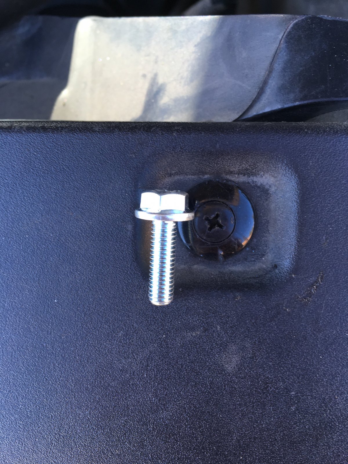

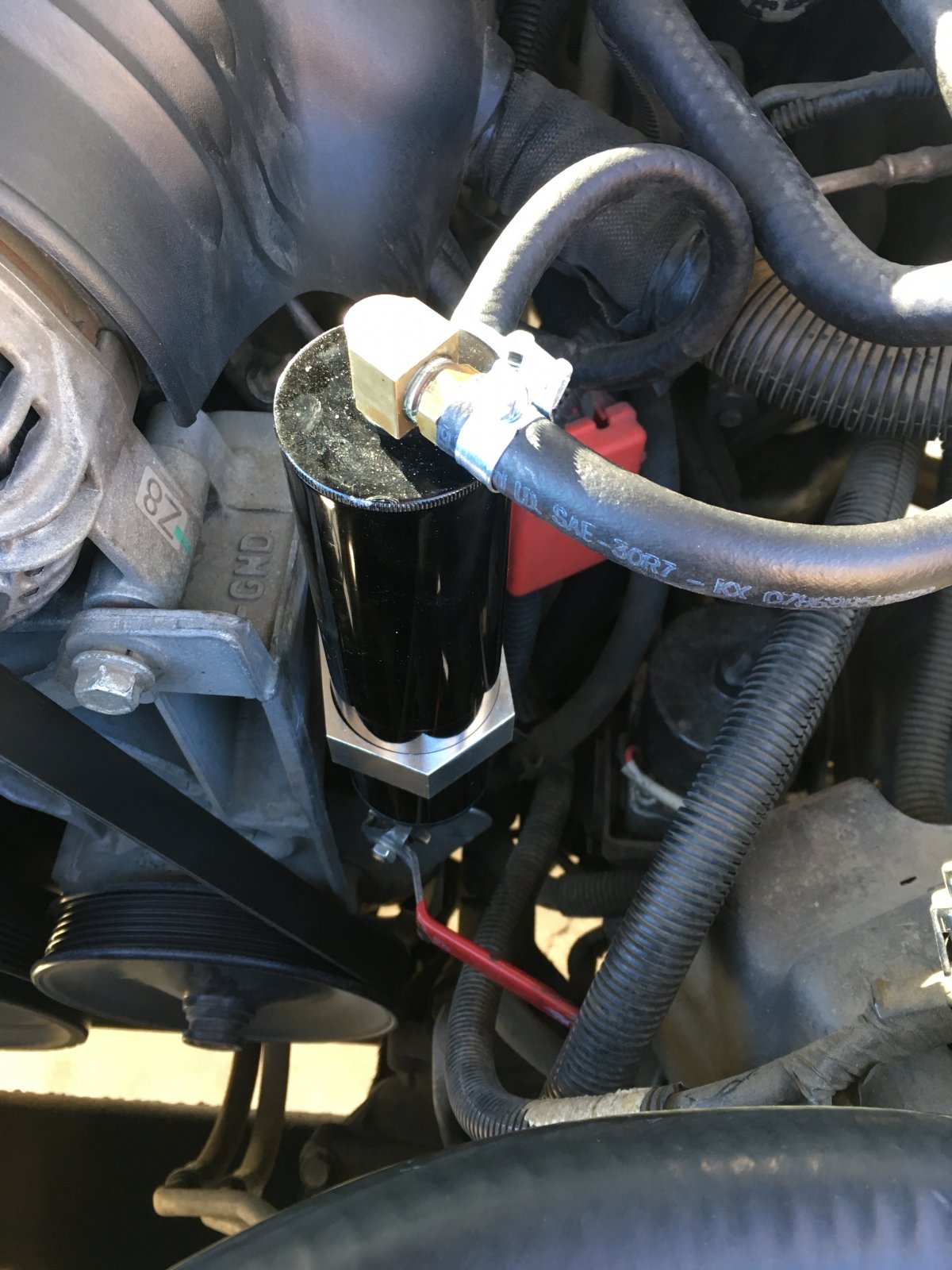

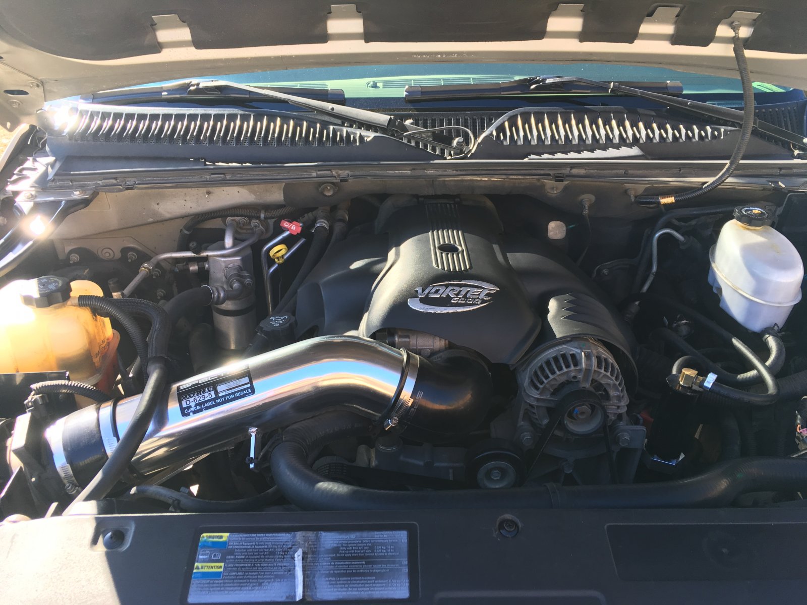

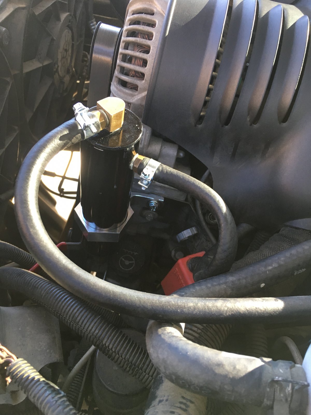

So catch can got it delivered Friday that I bought from @Fosscore ! He packaged it up quite nicely for its cross country trip out to me! And he was a big help and answered all my newbies questions about how to hook it up and the adjustment screw on the bracket to rearrange it on the bracket so that the drain on the bottom of the can would not interfere with my belts! Thanks for all the help buddy! Went to install it yesterday evening after my work day. Big thanks to @iamdub for answering my questions on how to mount it to the alternator bracket! Only issue that I ran into was the bolt that came off the alternator was not long to secure the bracket back to the alternator bracket. It wasn’t catching enough thread with the extra length of the catch can bracket in the way. So after church this morning I stopped into my local DIY hardware store and grabbed an M6x20 bolt, identical to the alternator bolt and with an 8mm bolt head, just a tad bit longer. That did the trick and secured the catch can bracket to the side of the alternator. Hooking the lines up was pretty easy with micheals instructions haha. Threw some hose clamps on the 3/8 hoses I picked up from the parts store just for a little added security on the ends of the hoses where they connect. So far so good! The bolt I picked up from the hardware store to mount to the alternator bracket:
Can hooked up and ready to go: F78FF7AE-C35B-4343-86A8-056F0142FE76.jpeg 9483BF62-3849-419A-8117-BABBA170100F.jpeg
I was pretty careful to route the lines under the engine cover in the little U shaped openings along the lower side edge and it worked perfectly.

I used the 15mm bolt that secures the alternator to the bracket. Although, with the size of handle on your drain, where you have it is probably your only option. Hey, it's mounted and in a good spot! Looking forward to seeing what it catches.
