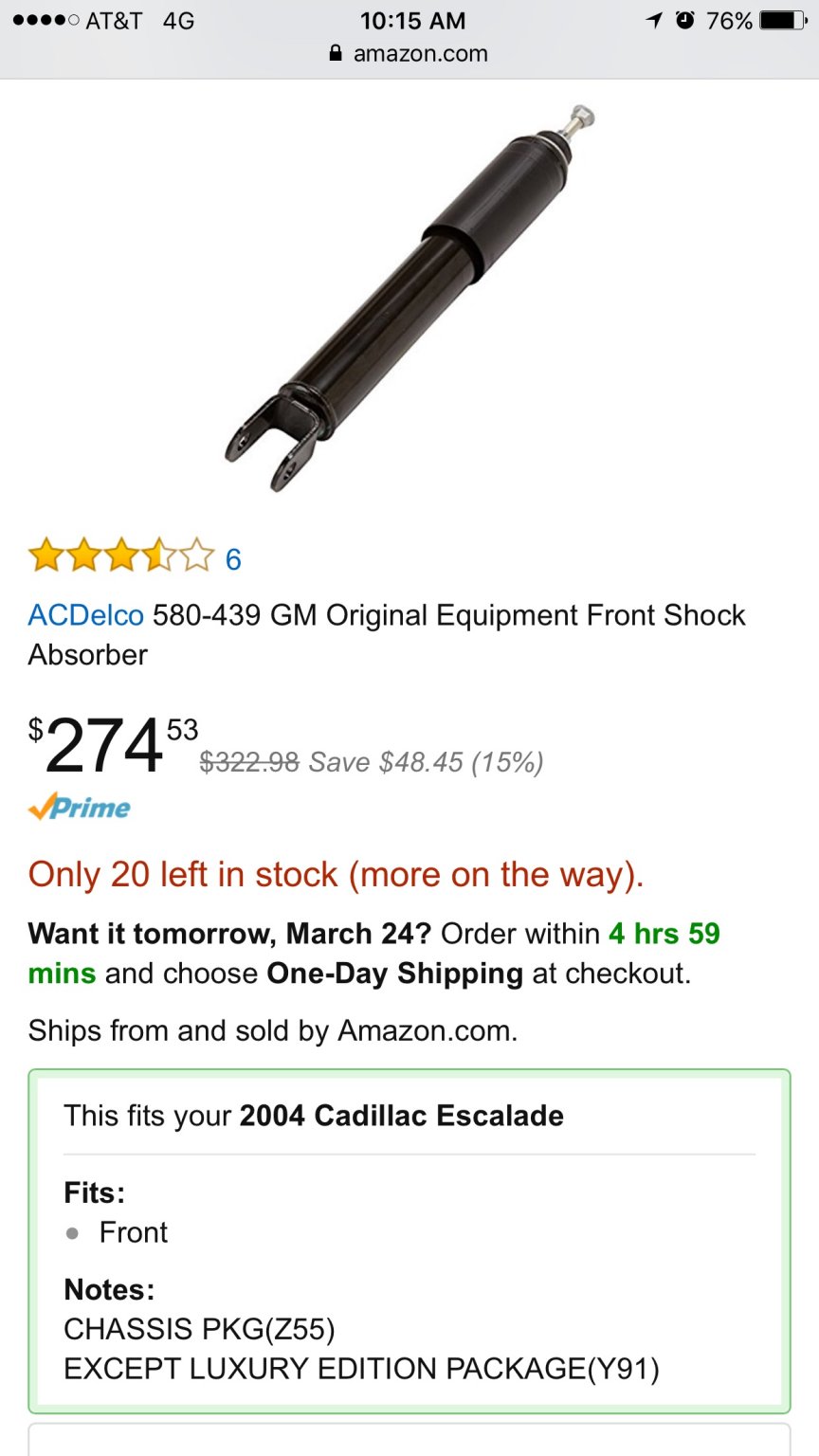

I got the resistors off Ebay, 3.9 ohm 25 watt ceramic. FYI the fronts aren't air shocks, only the rear. The fronts are electronic damped which is why you need the resistors since the less expensive ones are standard shocks. If you buy the resistors you basically do away with the Z55 designation for the fronts and can buy any shock that fits. The Arnotts have a resistor pack built in which the factory plug connects to which is why they're a bit more than standard but less than factory or Monroe w/ electronic damping.

Red Rocket is right that the fronts are not air shocks, although the rear shocks are not air shocks really either.
Your front shocks are "gas shocks" and your rear shocks are also "gas shocks" from the factory. You simply have electronically adjustable valving in the front, and air bags attached which help the spring in the rear. The air bags are not shocks, more like helper springs. They just happen to be attached to the body of the shock.

If you want factory shocks Amazon has the fronts for $274.53 about the best price you'll find if you go that route

Ok then show me where the front air lines are. Those guys are idiots is all I can say. If they're air shocks then there must be air lines going to the fronts just like the rears right? There isn't, just electrical connections. Go have a look.
X2 this is what the shock looks like, it's nothing like the rear shocks
Agreed. There are no air lines in the front shocks. Its a common misconception. And parts store guys often dont know everything about every vehicle.
