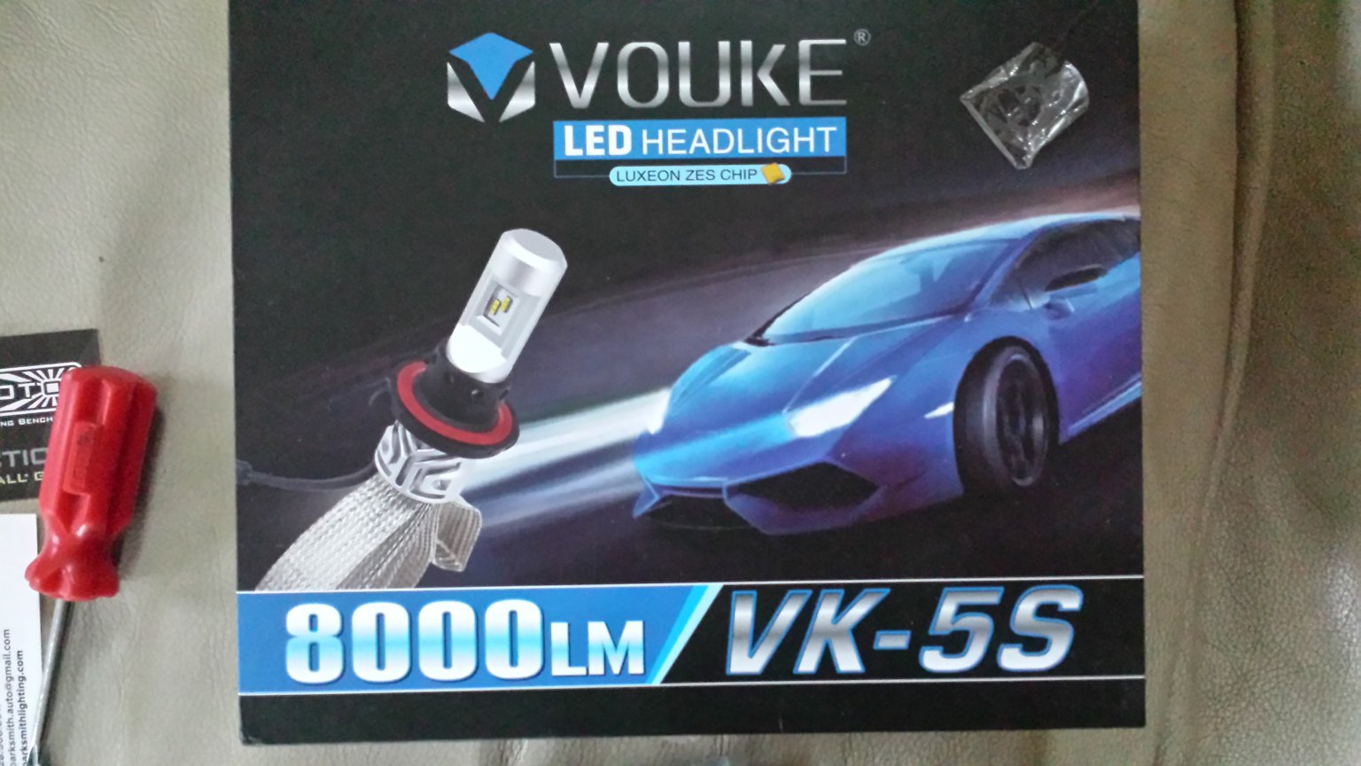

So the headlights have proven to be an interesting adventure. I can say so far that I'm impressed with the quality of the depo housings. The black part of the housing is painted instead if just black plastic. I like that. And fitment is perfectly on point. In fact I think they fit better than my stock ones did. Still need a bit if tweaking to get them aimed properly. The led halo strips also need a little work. The vouke leds I bought for my lows are impressive so far. Light output is 100 times better than the aftermarket housings. And I have the vouke highbeam led setup ordered now. Pics to follow soon.

Interested in the fitment of the Voukes in the Depos? No depth issues or sealing up the hole itself?
Which model did you order?

@Fosscore , here's which ones I ordered, they are a direct fit. No modifications. I think because the denali housings are designed bigger and deeper than the tahoe housings the vouke leds fit in with no issues in that aspect. Still can't figure out how to readjust where the actual bulbs are aimed though on the back of the depo housings. That's annoying the heck out of me! anyone got any ideas on how to readjust aim?
