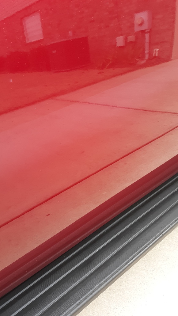

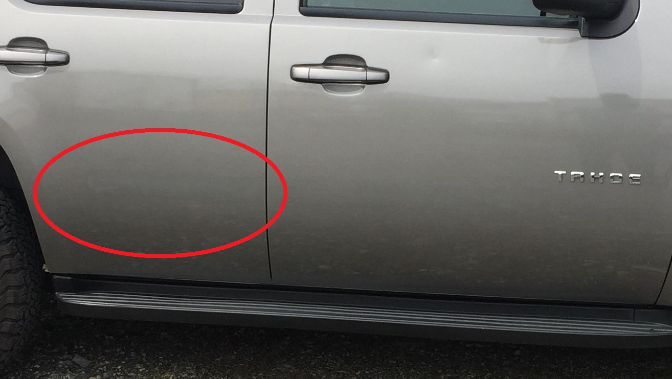

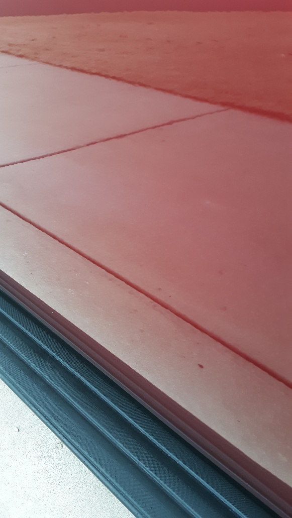

The image on the left can be seen better. It looks like a bright/clean spot in the driveway but it's discoloration on the door panel. Facing the other way it's harder to see.
