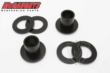

The coils rest on seats that are part of cylinders that slip around the shock body. The relocators are the same thing, but the cylinder is longer which lowers the position of the seat on the shock body, which lowers the vehicle. Here's a pic of a relocator installed on an OEM strut (there are spacers used on this one to raise the seat position to lessen the drop) :
These are the relocators and spacers that replace the OEM coil locators/seats:
There are adjustable struts that have threaded bodies that you spin the seat around to raise or lower the seat position to adjust the amount of drop or lift. You can adjust the drop or lift virtually indefinitely within their range of adjustment. The relocators I'd be using and what is in the above pic uses spacers to adjust the drop in 1/2" increments. The relocators with no spacers yields a 2" drop, with one spacer is 1.5" drop, with both spacers is a 1" drop.
