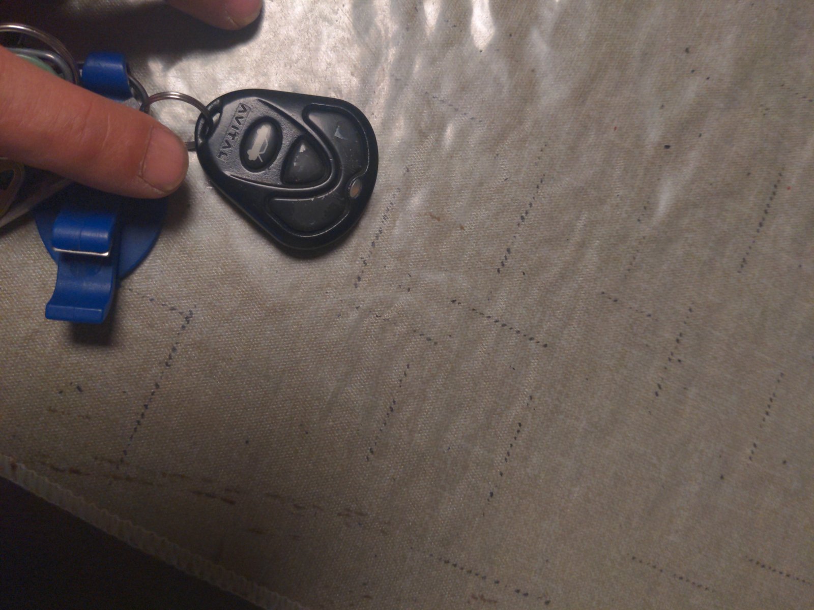

My '03 had a remote start when I got it. There are python stickers on the front windows if that helps, idk if the fob is factory or not.. I'll send a pic of the fob.
purp
Nov 6, 2022
Not factory.. lol. All I had to do was look at the pic.. haha

Yeah... Avital must be one of the main suppliers of remotes for aftermarket alarm systems. Several of the ones I had recently all had Avital fobs.
Which makes sense. If I were a company making alarm/remote start systems... Why would I want to waste my time and resources come up with my own remote, when I can use one that has been proven already?
