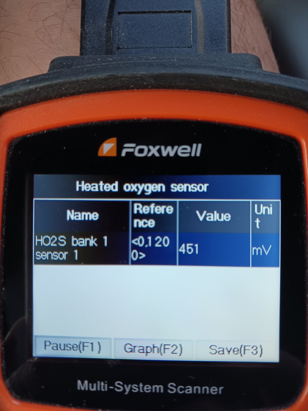

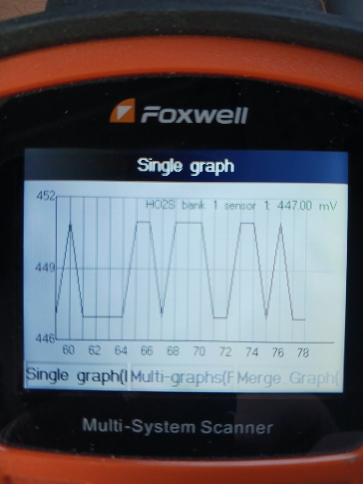

But I had it scanned and this is what O2 shows. Actually, I scanned all 4 of them, they all show same. So I figure, it's not sensor
I'm not sure of the graph -- the mV value range may not be great enough to see the full high and low values, or the sensor might be moving just a little if that's all it does. The upstream sensors should move a lot up and down between 100 and 900 mV as they sense between lean and rich. If the value sits there around the 450 mV area and doesn't move much, it's not reacting.

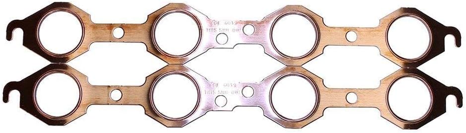

I have a question then.
If manifold is held in place by simple bolts, do I really need to disconnect it from the exhaust pipe to replace only gasket? Won't it move away from the block enough to simply remove the old gasket and slide the new one in?
these are copper and I'd use oem 3 layer but notice the end bolt holes are slotted. if you can do that to the gaskets you have, you should be able to pry the manifold out a bit slip them down in.
as for getting the old ones out, leave one of the front or rear in, should be able to pull up the gasket, and then put say the front in, remove the back and pull it the rest of the way out.
I've not done this on one of these trucks, only an older small block chevy motor with more flexible headers. but might be worth a try.

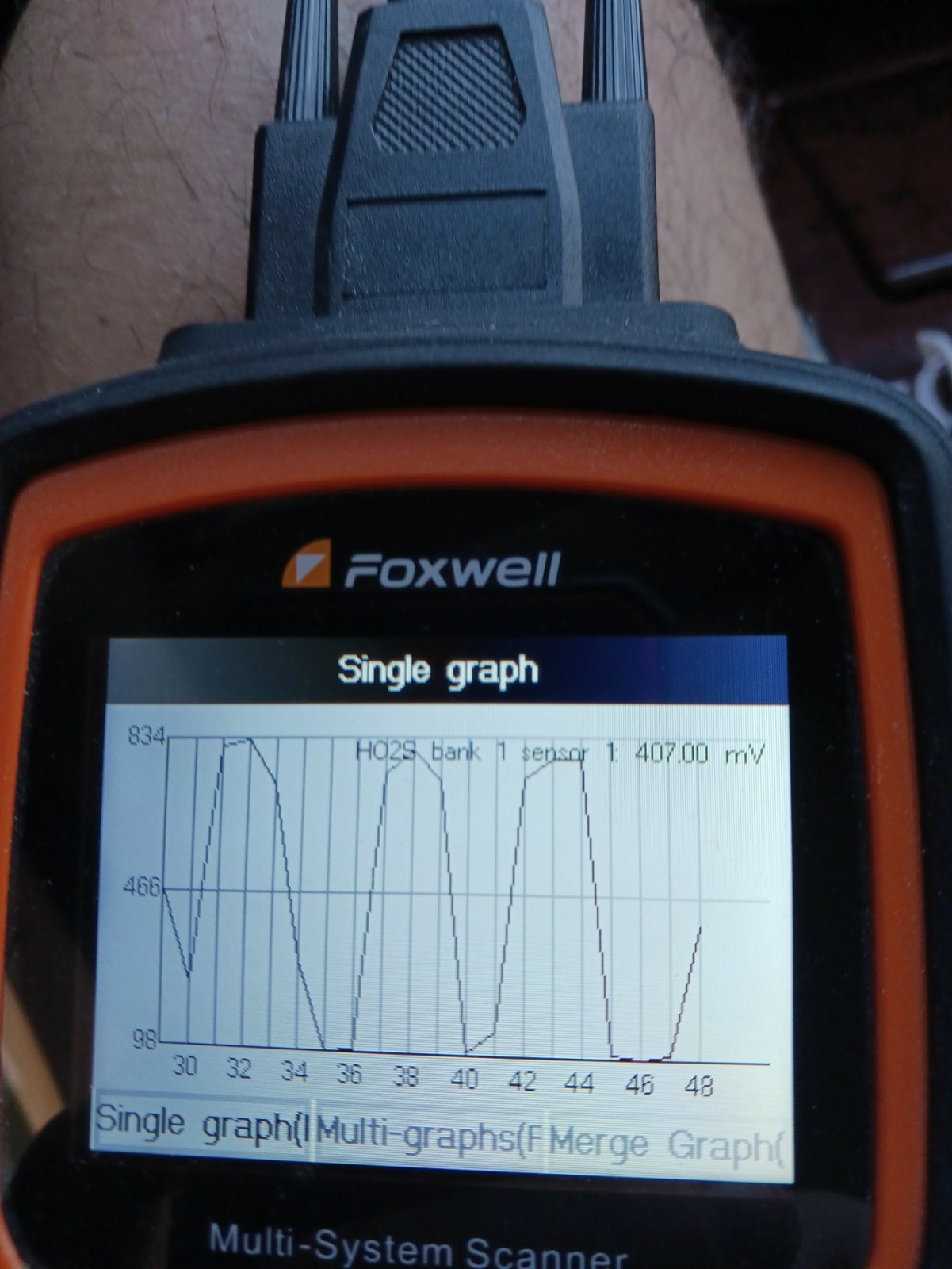

So I ran live scan on O2 sensor. It's reading just fine
