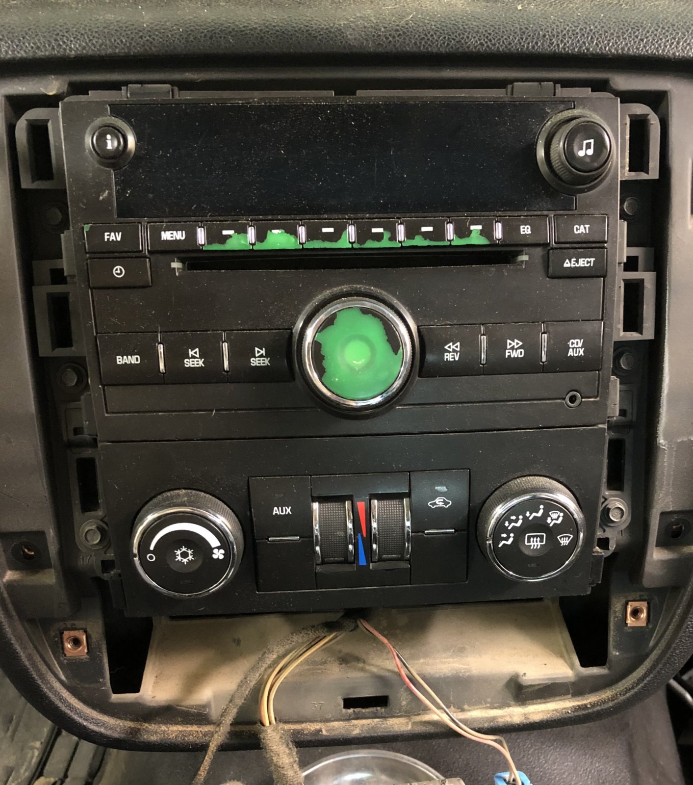

Looking to pick some brains here:
Vehicle is the 2008 SSV, so basically the LS. Has what I assume is the cheapest radio GM offered. And the fugliest thing I’ve ever seen, the finish is worn off some of the controls and exposed bright green plastic.

Time to get busy shopping. Here’s the old one in all it’s monstrous glory.
