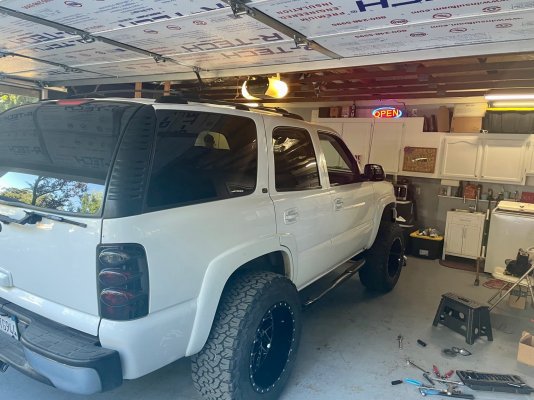

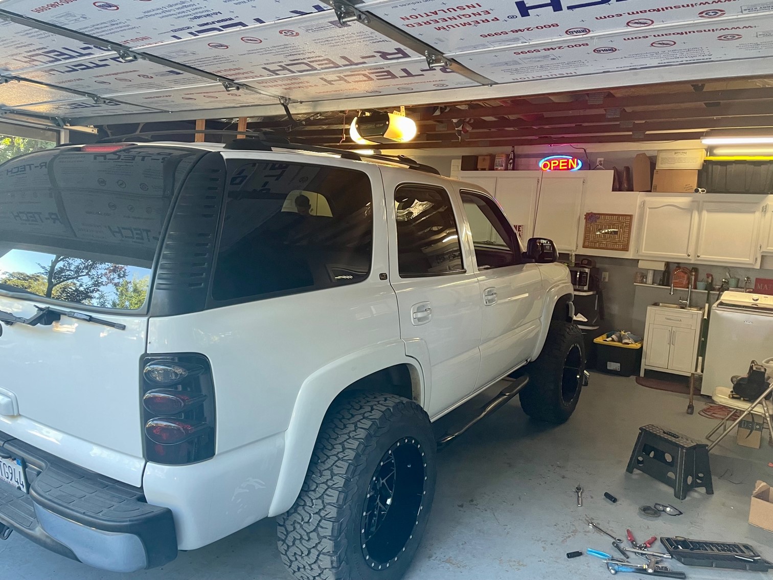

So I completed my 6" lift, 03 Tahoe. Overall happy with the outcome. I would not buy another RC kit. I feel like they cheaped out on the bolts washers etc. It's a low-end kit, I get it. I'm on a budget so just wanted to try it for the project experience. Again, overall I'm happy with it.
One thing I would like to improve is the rear suspension. I'd like to raise it a little more. Question is, If I update the coils to some skyjackers C25R (2.5"), do I need longer sway bar links? Or should I just get some 2" supreme spacers?, Still wonder about the sway bar links, but I've looked online and didn't see any for a 2-3" lift. Just stock or 6". These are the questions I ask myself. Wonder if there are any opinions out there. Also if anyone has any other upgrade recommendations while I have the rear dropped.

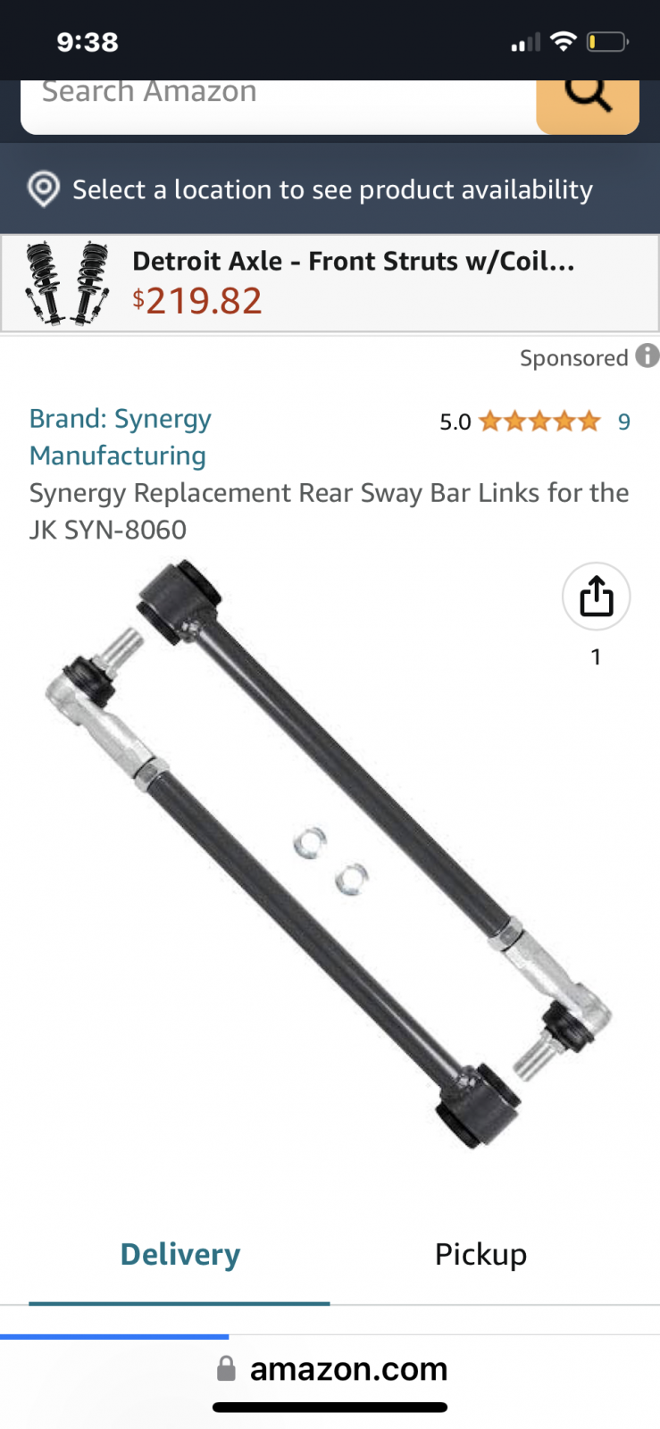

Carl- thanks for the deets. Great explanation and makes sense. Are these the sway bar links you are running?
