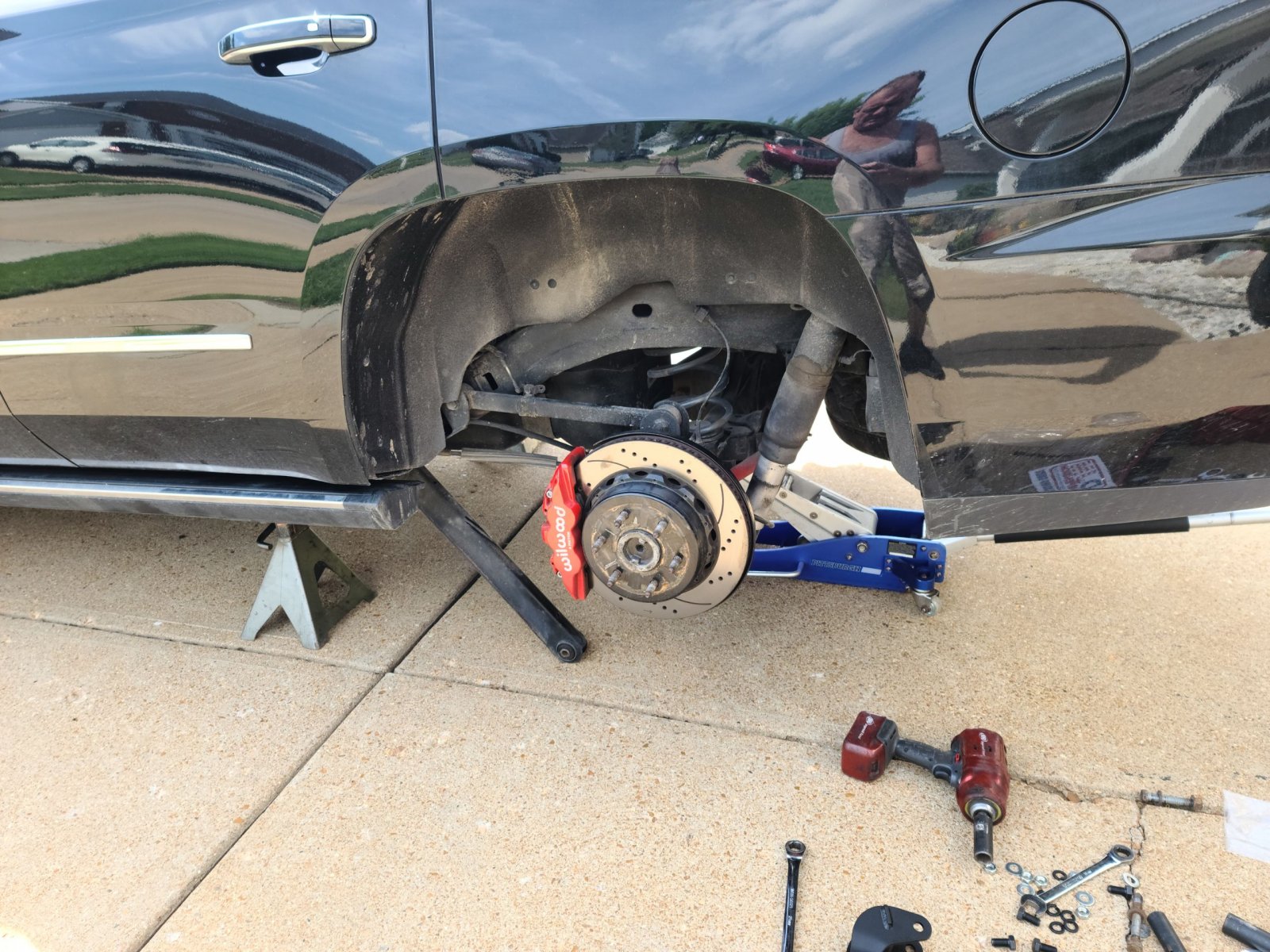

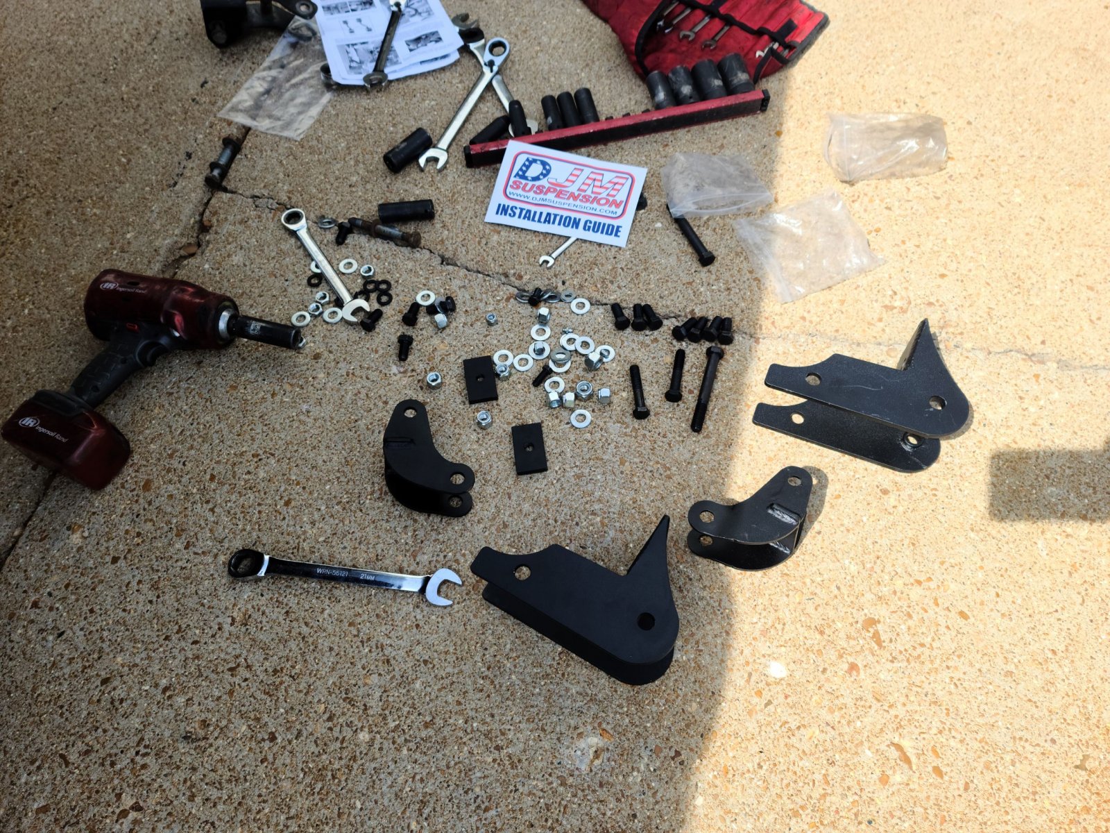

Installed DJM LCA and shock relocation brackets. Stock height vs Belltech lowering kit there is difference 2° in drivrshaft angle. Now im gonna drive it for little bit and see how much driveshaft angle DJM relocation kit fix
Slow5.0
Slow5.0
Mar 26, 2011
436
218
Missouri
After short hwy test looks like it rides much softer on patholes vs belltech setup. And dfive shaft angle is 1° off from factory angle, not bad fix for 4" drop in the rear
