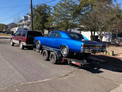

This is how it looked the last time I towed it. Is that too low?? I used to tow the car with my 94 K1500 and don't remember the pick up looking this low.

I’d look around under there. No sag last year is what doesn’t sound right. Without air shocks to keep it level it should have sagged a good bit. And I get dibs if he’s not home.

Sure its' riding too low. Not only monkeys handling and safety, but your headlights are probably not on the road either at night, and can be a problem for oncoming drivers.
Install a Firestone Ride Rite Kit on back, problem solved.
They work with stock shocks.
Such kits have the option of simply using Shrader Valves to fill, mount them wherever convenient, or one can go further with an additional and optional onboard 12v compressor kit and gauge at the dash.
One can use a T, so that one line-valve fills both bags, or separate, I did the latter, each shrader valve is at the hitch side plates for easy access.
A kit like this won't ruin your ride.
I have this on my own '97, works like a dream. Pump them up to a maximum of 100 lbs if needed, I commonly used 30-45 psi, I can throw up to 1000 lbs of cargo in the back, and 350lbs of hitch weight, you'd never know it was there. How do I know? I've done exactly this with two 1600 mile trips across country with cargo area maxxed out, and hauling a cargo trailer.
