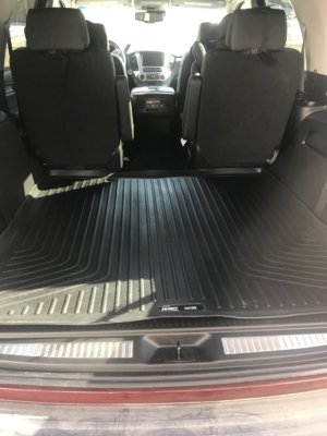

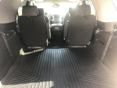

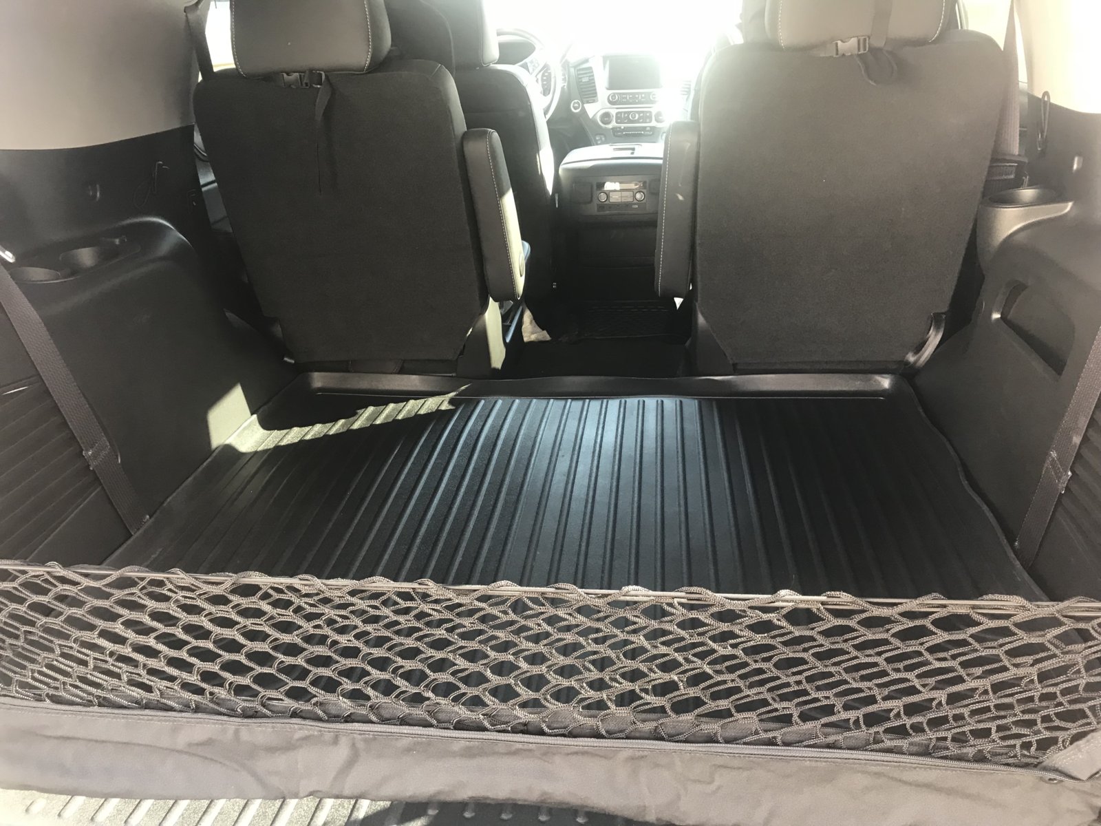

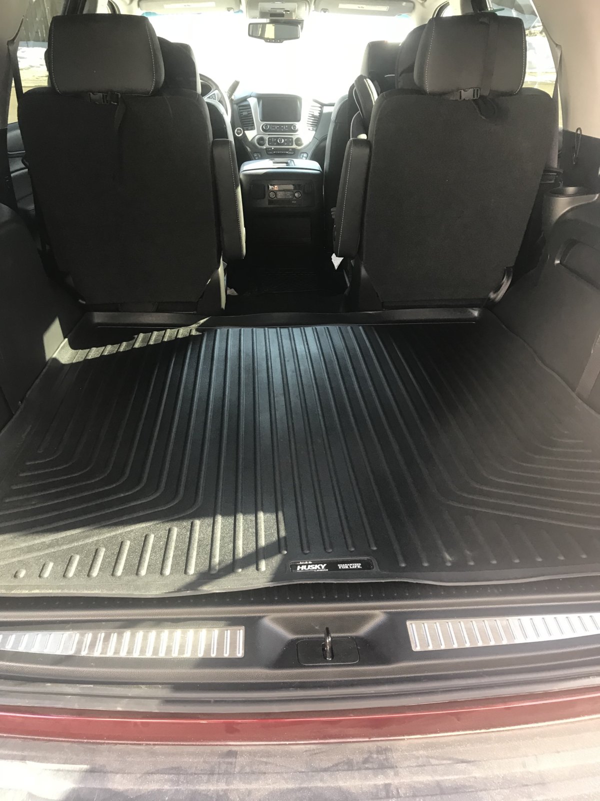

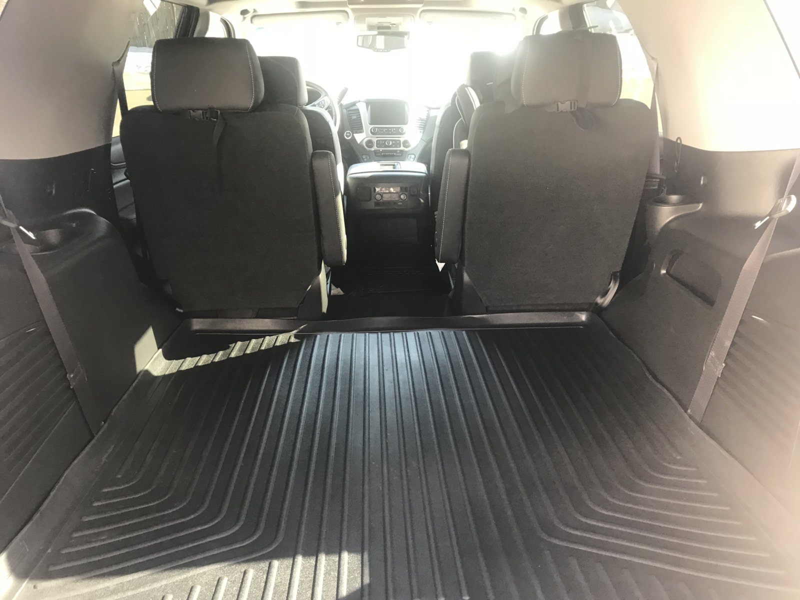

Not sure but I'll know shortly!!! Does anyone else have a before and after pic?

Problem solved. Put seat back in to see if that was the issue. While pugging it in I could hear something hitting floor. Looked under carpet and found a wire unplugged. Looks like it goes to an antenna for the keyless stuff. Looks like a little square box. Plugged it back in and all is good. Took seat back out. I must have unplugged it while pulling on the seat plug in. It’s tied in to the same harness.

AWESOME WOLF!!!! Looks like I know what I'm doing for the next mod!!! Thanks for the pics man NICE!!!!
