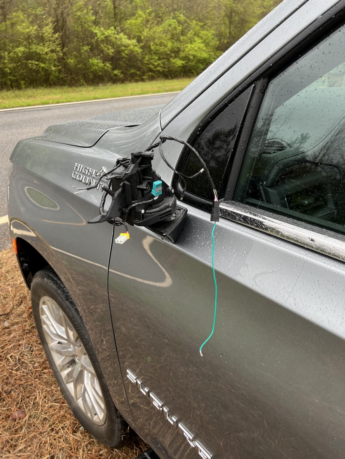

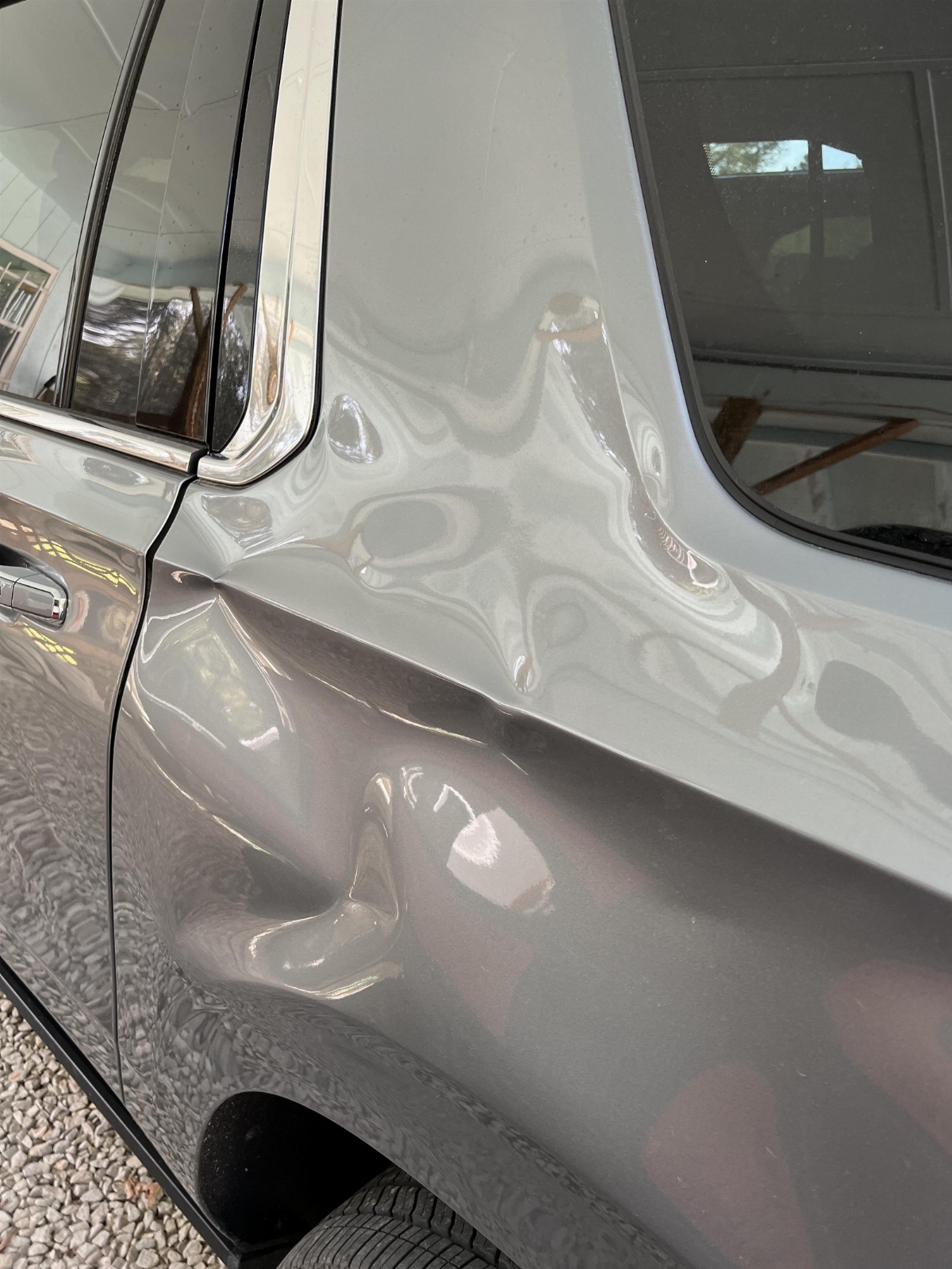

Fast-running deer outta nowhere ran into the side of our '23 Suburban HC while was cruising 63-mph on a long straightaway. Deer's head first connected the mirror, then her body impacted the rear panel just behind the passenger door.
Doors seem to open and close properly as does the mirror's motorized stem. Of course camera 360* is partially out as well as the lane change detection and I forgot to test the lane keep function.

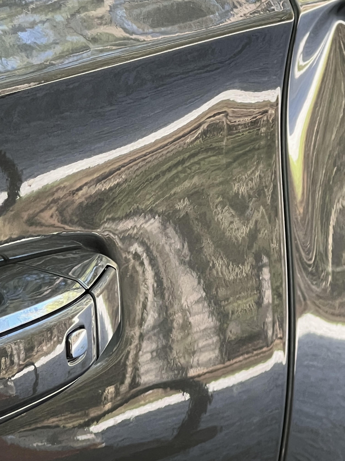

Anyway, does the rear quarter panel appear to be repairable with particular attention on the 2 creases, also the right-side door-jamb GAP was stretched to the rear 5/16" at the handle. I really-really-REALLY hope the entire panel won't need cut out and replaced.

Fast-running Kamikaze deer outta nowhere head butted my '23 Suburban HC while I was cruising 63 mph on a long straight local hwy yesterday afternoon. Her head first connected the mirror and her body slightly impacted the passenger door handle but mostly the rear panel.. fortunately seems perfectly drivable.
Does the rear quarter panel appear to be repairable with particular attention on the 2 creases.. and other concern is the door-jamb itself was pulled slightly rearward (at the passenger door handle).. opening up the door gap about 3/8" at the widest. These ^^^ are my biggest concerns, bondo repair or EEK !! cutting out and replacing the quarter panel sheet metal from the doorjamb to tail-light.

Take it to a PDR guy first. That stands for Paintless Dent Repair, you'll be amazed at the dents they can fix without painting. He can't fix your mirror though!

PDR aint going to fix that....
those creases and stretched metal are beyond PDR...
that will have to be replaced or filled with body filler.....

Maybe dentless can do something with this I don't know.
If there is a bank lean on it and being a new model, I am sure the bank will want it repaired to factory specification and new condition.
Since it is basically new, I would actually want to have a qualified shop cut and replace properly rather than a few quick hits with the hammer and fill the rest with body filler...
Fight for your right to get back to original condition.

Thanks, I'll go visit some reputable PDR places, I could probably live with some small creases & minor imperfections as long as the major dents are removed.

It's a cut out and re weld situation. PDR is not going to fix that. Insurance may even total it.
Resale value will be diminished as well. Sorry about your luck at least your ok..

You are going to need a qualified body shop.
Good news is, for any animal damage, it’s considered “act of God” and covered by comprehensive, so doesn’t count as an accident.
File a claim, find the best body shop you can, and let them go at it. End of the day it’s plastic and Steele; nobody got hurt but Bambi…so pick up the pieces and move on.

That's a panel replacement, but not totaled. Got sideswiped last month in the same spot. Panel and bumper cover job next week. $7K.
