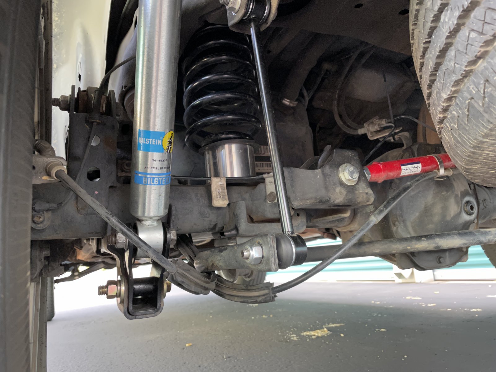

Go with MZS they have aluminum spacers. Here is an example of how mine were installed. Once they are in there you shouldn’t have any movement as long as you aren’t stacking lift spacers on the same side.
