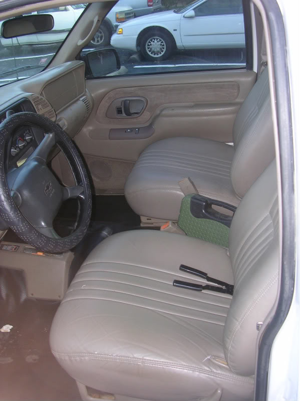

88-98...99 was the NBS and that won't fit. Brakes should fit. It's a direct swap except for the u joint which you will need a new one like bowtiefreak stated above. Do you have pics of your truck up? I don't know if I have seen a 2 door police edition.

Its really a ex border patrol car, nothing special just like a fleet vehicle with heavy duty steel wheels and a plain jane interior.

I believe the springs do bolt in but you will need larger u bolts for them. Nice truck by the way. Where are you at? I found one in Michigan with 3.42 gears for $80...but i'm not sure what year it is. haha
