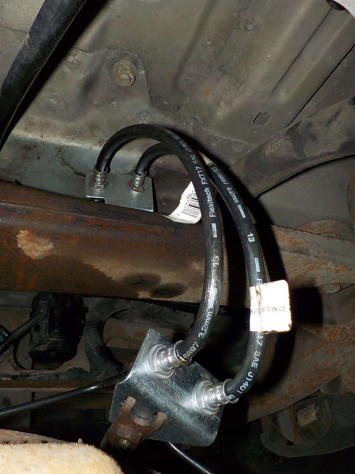

Today I installed new dual rear brake hose setup Genuine GM# 176-1525 - $63 amazon.
Gravity bled the brakes afterwards.

Very nice. I think most people overlook those two brake lines.

Good write up & pic. I never would of known about those little suckers unless I saw it pic & part #

Here's what I used:
My vehicle doesn't have any corrosion, that helps.
And I have a lift.
Move any/all evap lines out of the way.
Have the master cyl full and leave the cap on.
Leave the 2 L brackets attached to their mounting points until you have the 4 fittings broke free. Don't totally undo them (4) yet, just crack them (4) free to minimize fluid loss.
Work quickly so as to minimize brake fluid loss from the master cyl. When I started the job fluid was at the MAX line, and when I finished it was at the ADD line. This makes bleeding the brakes easy.
I removed the bottom 2 first, attached the new 2, set the other loose end up on top of the cross member to minimize fluid loss (gravity), while undoing the top 2 fittings.
Remvove the ole hose assembly and a connect the top 2 lines.
Reattach the new assembly L brackets.
Refill master cyl.
Gravity bleed brakes. I did all 4 calipers starting at the furthest from the master cyl.
If you let that master cyl run dry/get air in it :( you will need a tech2 type 2way scan tool to bleed the brakes. I don't own such a device.
