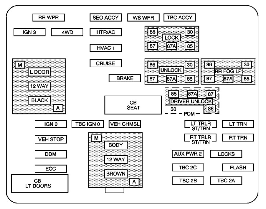

Well thats the quickest fix i have done.Checked the lock and unlock relays in the fuse box drivers side dash.I never knew they had seperate relays.So right off the unlock relay looks scratched up,i looked at both of them terminal wiise.They looked fine swapped locations now no problem works fine.So im ordering new relays right now.Found a nice fuse box pic online,as soon as i seen that unlock relay i had a feeling.
