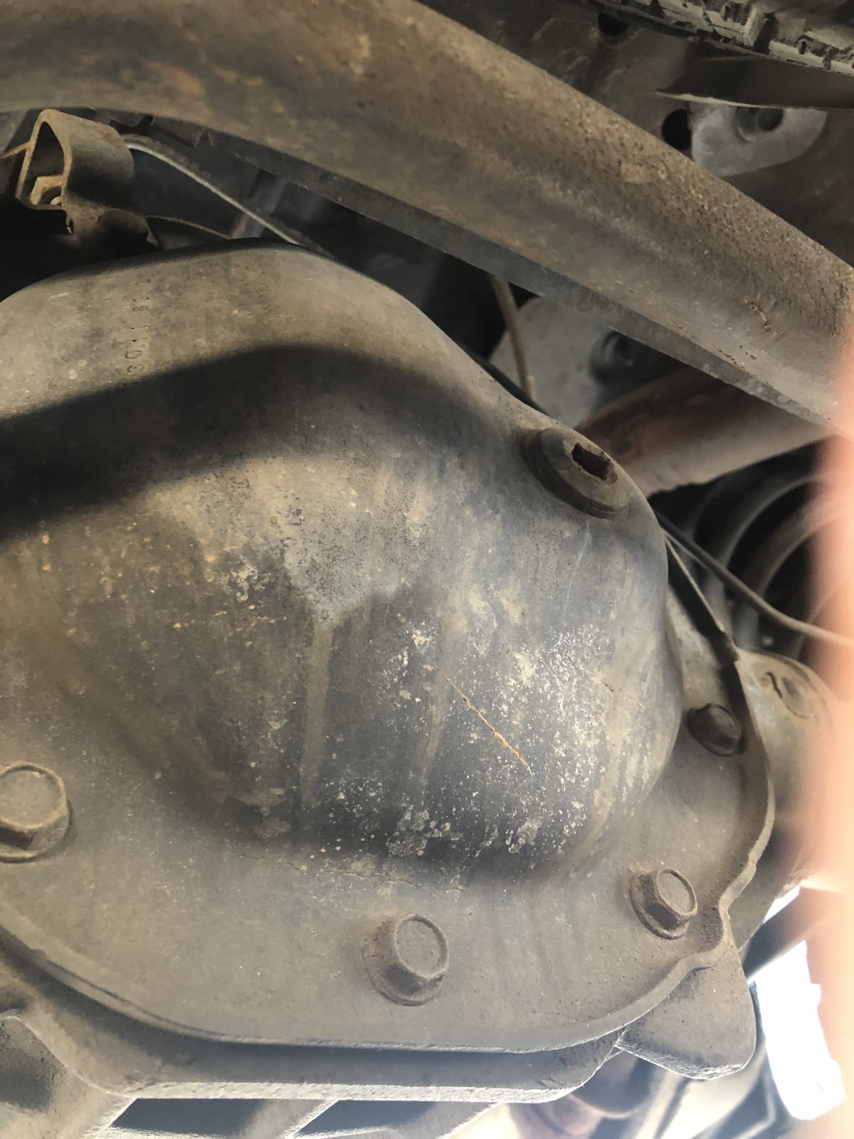

Been reading about front and rear differential fluid changes. Bought the truck with 150k and feel this is a necessary step moving forward.
Been under the truck and only plug I see is attached to the diff cover? But it’s below the center line of cover. Is that the full plug. Just doesn’t seem like it would allow enough fluid.
Any feedback would be appreciated.
Thanks

Yes, that's the fill plug. No drain plug on the OE cover. You have to loosen/remove cover to drain.
When filling, proper level is just below the fill hole. Usually I'll just slowly fill until fluid just starts to trickle out of fill hole, then remove the hose used to pump the new fluid in and install the plug.
