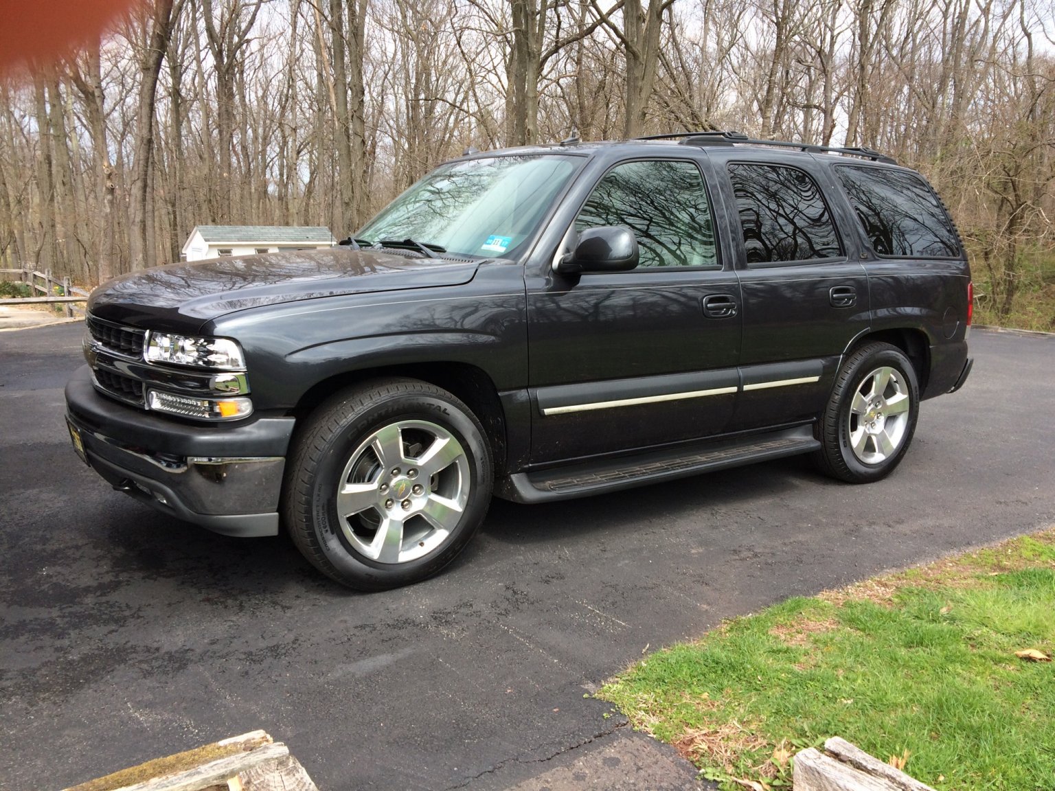

As requested......Same Kit as OHSIXX. Belltech 2/3
Free travel mod, DJM endlinks, panhard bar.
Also did the bigger brakes from NNBS series, electric fan with OEM harness, vet trans servo, Airaid intake.
The wheels are new to me 20". Need a tune, on the BB waiting list for NJ
