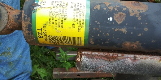

Here is the shocks that were on there I put on coil over shocks for my brother 2002 Chev suburban LT last year .. they both were leaking oil .

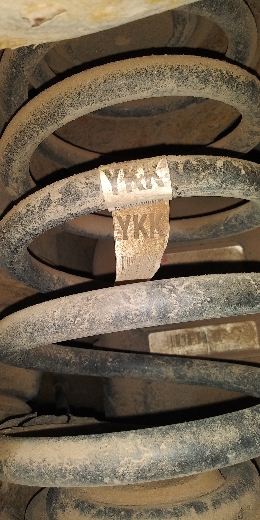

Now on my 2006 GMC Yukon XL slt ZW7 I bought set of KYB front shocks said they were for smooth ride zw7 but how do I know what shocks go in the rear ? I looked under rear and coils have sticker yet . YKK are they the 1300 lbs ones ? now I'm questioning everything ..

Joe, my 2009 has YWK springs, sticker looks the same too. Look on the back side of next time you're down there and see if the part number is still on it or above the top most YKK. If you can gently clean the sticker then maybe your phone can read the bar code with one of those bar code scanner apps too.

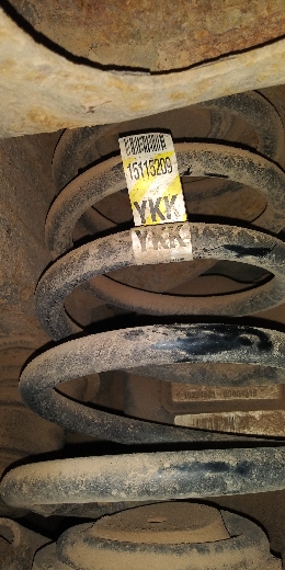

Here is the number.

Here is the number.
Sent from my LGL722DL using Tapatalk
Says they used YKK all way to 2011 .. first year was 2004 ... So are they the 1300 lb coils ? So I just use regular shocks in the rear ?

I have no way of knowing anymore what the spring rates are, can only go by application now. I typed that part number in over at Amazon and came up with this:
https://www.amazon.com/TRW-JCS1537T...ild=1&keywords=15115209&qid=1596545169&sr=8-1
They did say that they would fit my truck as well, since neither of us has G65, what we have are HD springs and regular shocks, not the fancy Nivomats. So yes, you can run standard type shocks in yours. Way down in the Q&A, TRW says they work on a 2003 and also provided the number for the front coils.

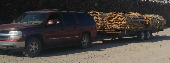

Here's the 2002 Chev LT with G65 on rpo that I put coil over shocks in place of the oily Nivomats .. needless to say it never worked out 35 mph all the way home with that load .
Yes it had weight distribution hitch on also . But load was a bit big for the trailer also .. I ended up only hauling 2 at a time and I had to let rear of suburban sag pretty good ..so trailer wouldn't sway .. now I know why .. it was like springs were way to light and the coil over shocks were holding all the weight .
