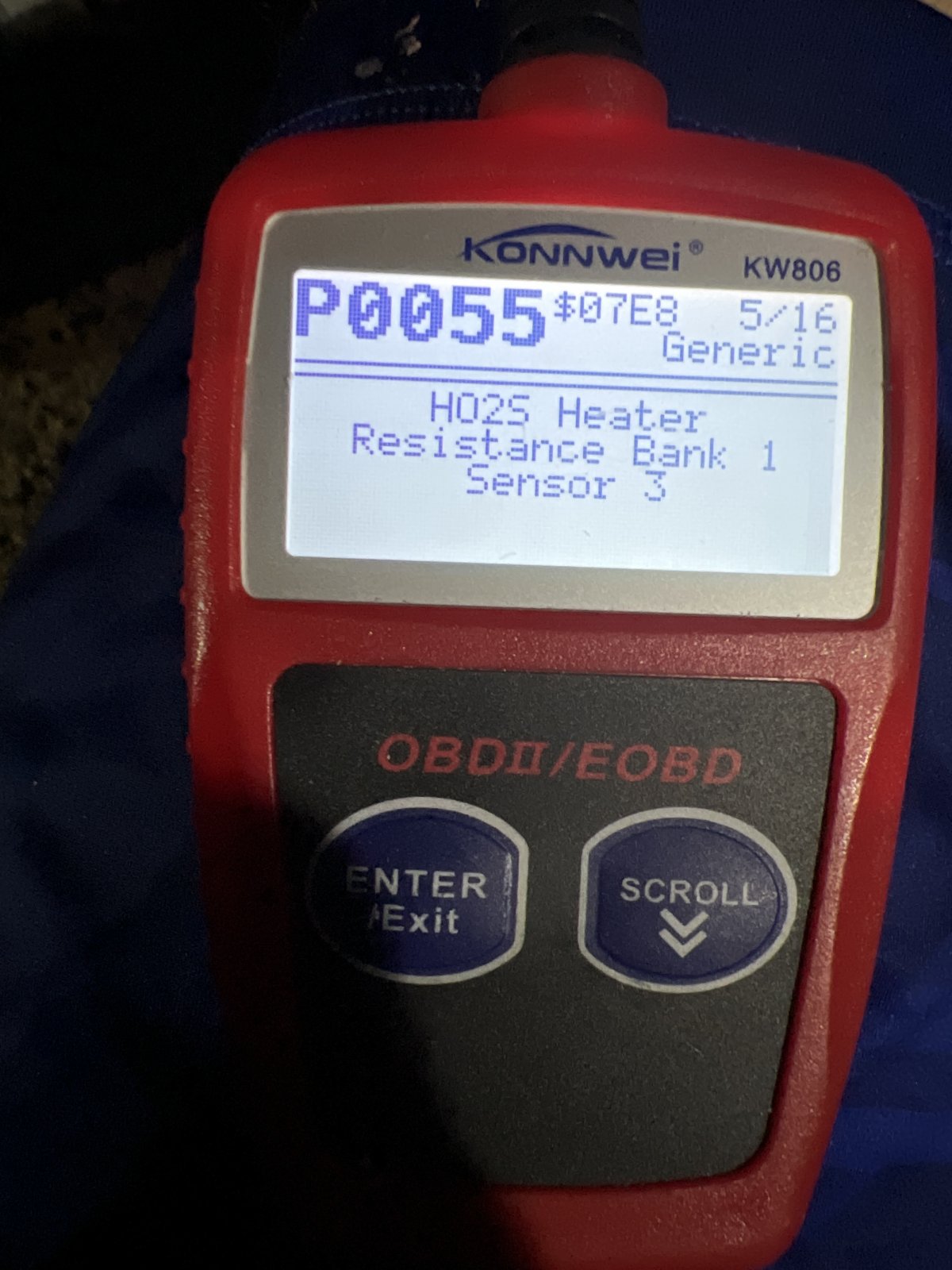

Trey Hardy
Jun 12, 2020
3,552
9,637
Yep, put down the beer @Trey Hardy and focus better..... ;)
How did you know? Lmao I’m about to go smoke a cig and I’ll get the code I thought I had put that in the first post my bad!

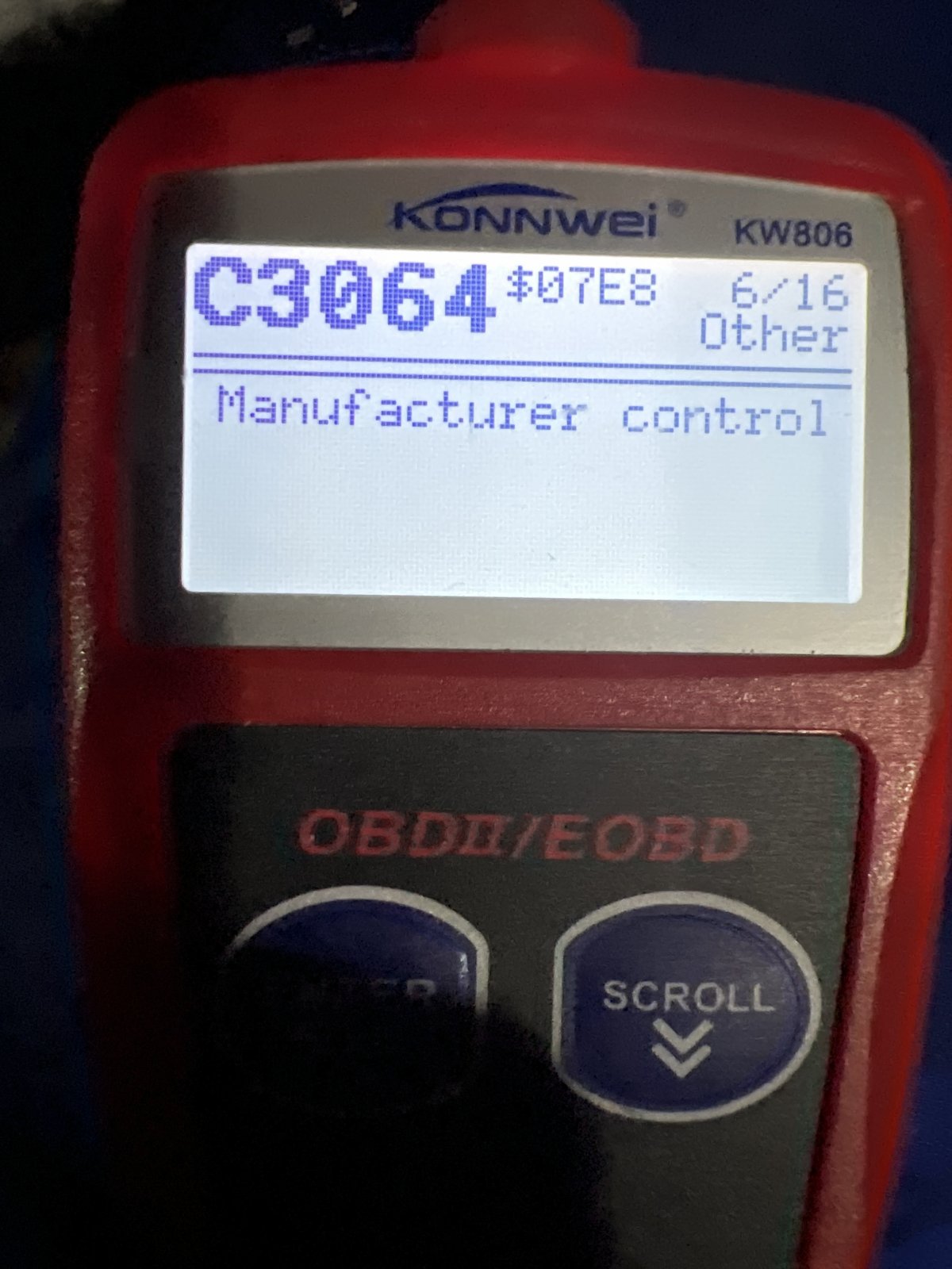

You and your tuner need to have a talk ...
It’s been fine for the past year no issues until now I just diddnt know if something else could be triggering the code because I know sometimes with this electrical stuff it can snowball and you’ll chase sensors down that don’t need replacing or for it to just throw a different code for something else

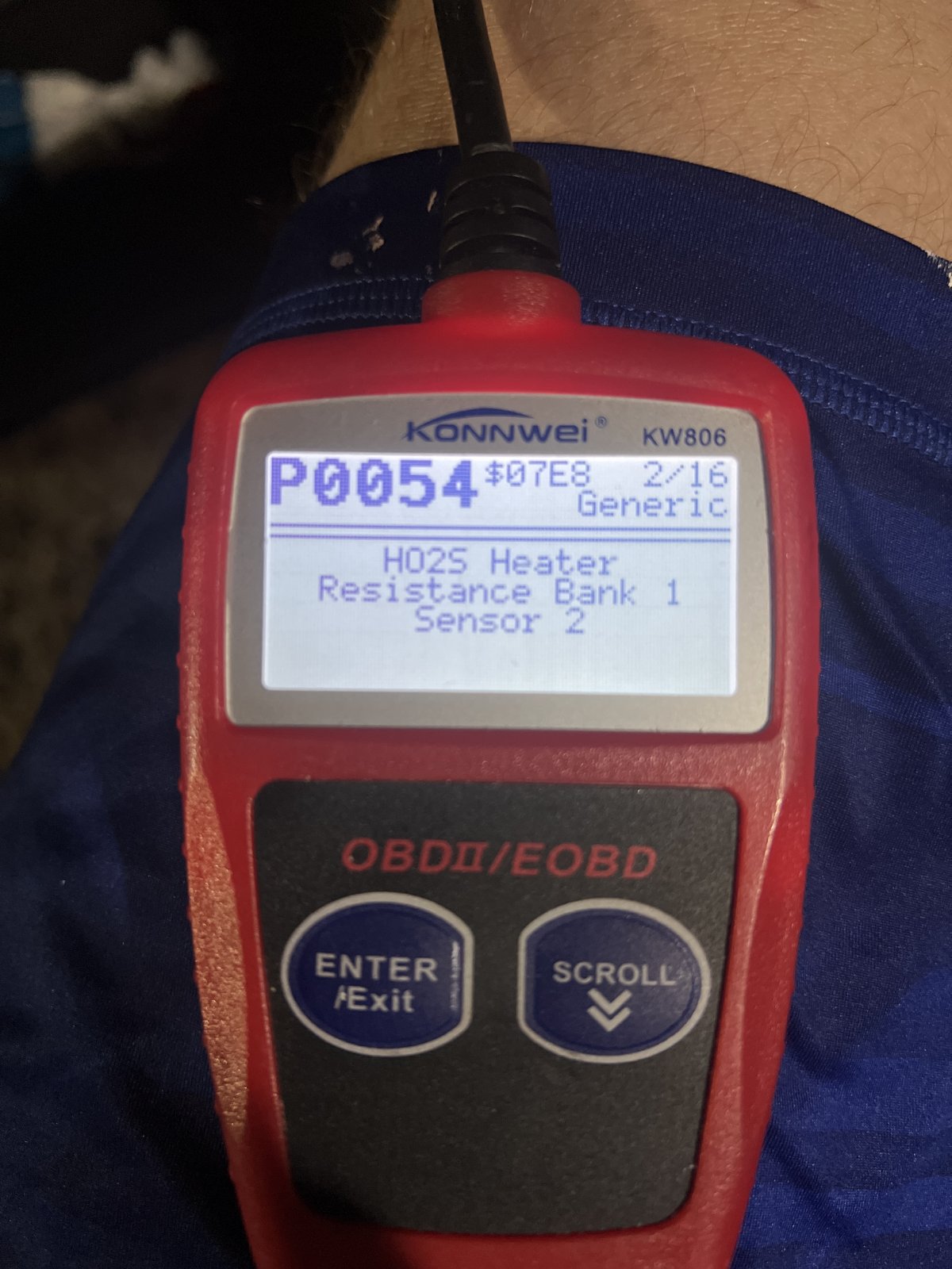

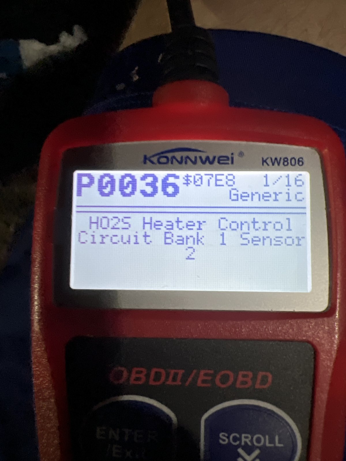

Even though that's usually true, that's nothing to do with the OTHER issue.
Your tuner said they tuned out the rear O2 sensors.

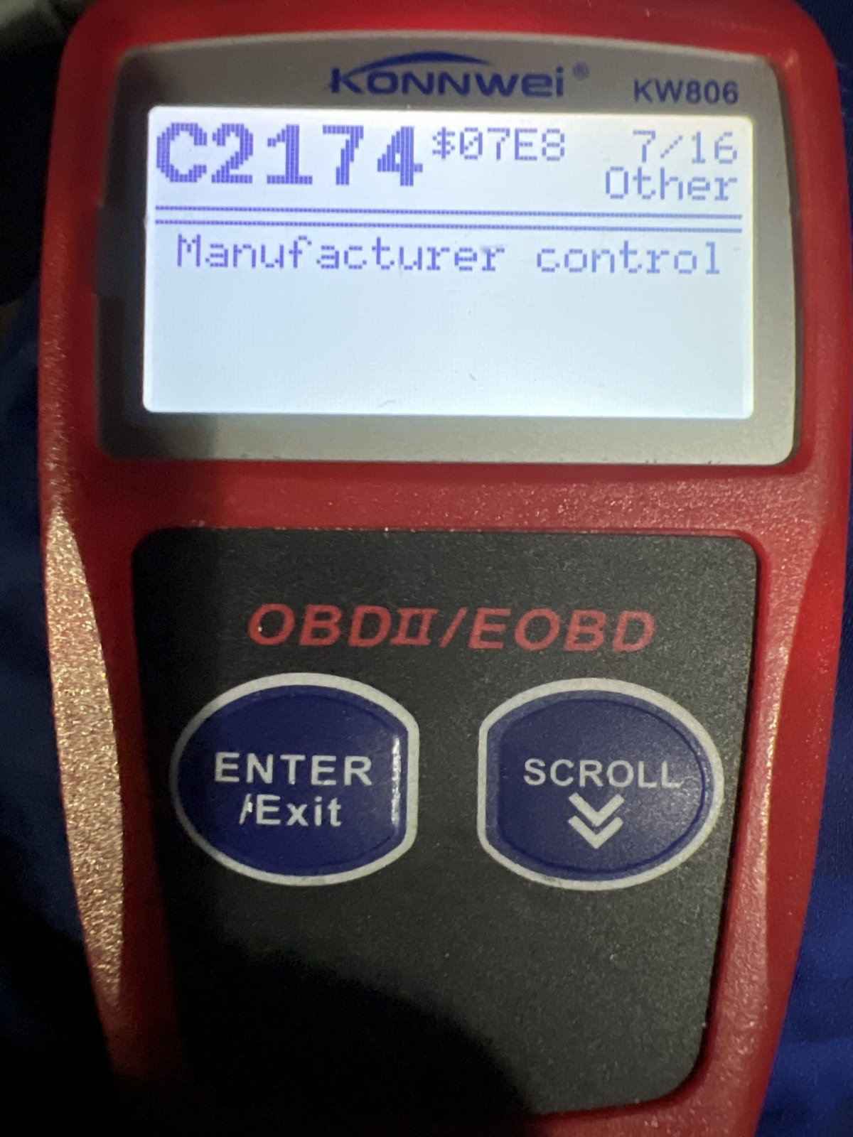

P0036 P0054 & P055 are definitive proof that your tuner made at least three mistakes (in my opinion, at least six and up to twelve, but nevermind that).

At least on HP Tuners there's 2 checkboxes to uncheck to disable the CEL codes. I think one disables the check and the other disables triggering the CEL light from actually showing. That's true on the 0411/P59, not sure if that's the same on the E38, etc.
My VATS/EGR delete on my 99 Silverado had EGR code pop up and had to be taken back to the guy that reflashed the tune.
Why the code popped up until now, I don't know. Maybe the misfire triggered the run that made the code pop up.

I've been in a e38 ecm with hp. it's the same way, you unchecked the box and the ecm never looks at or reports the fails on that item again, be it o2 sensors, fail maf and fail map to tune the other side.
this is definitely one for the tuner to sort out.
