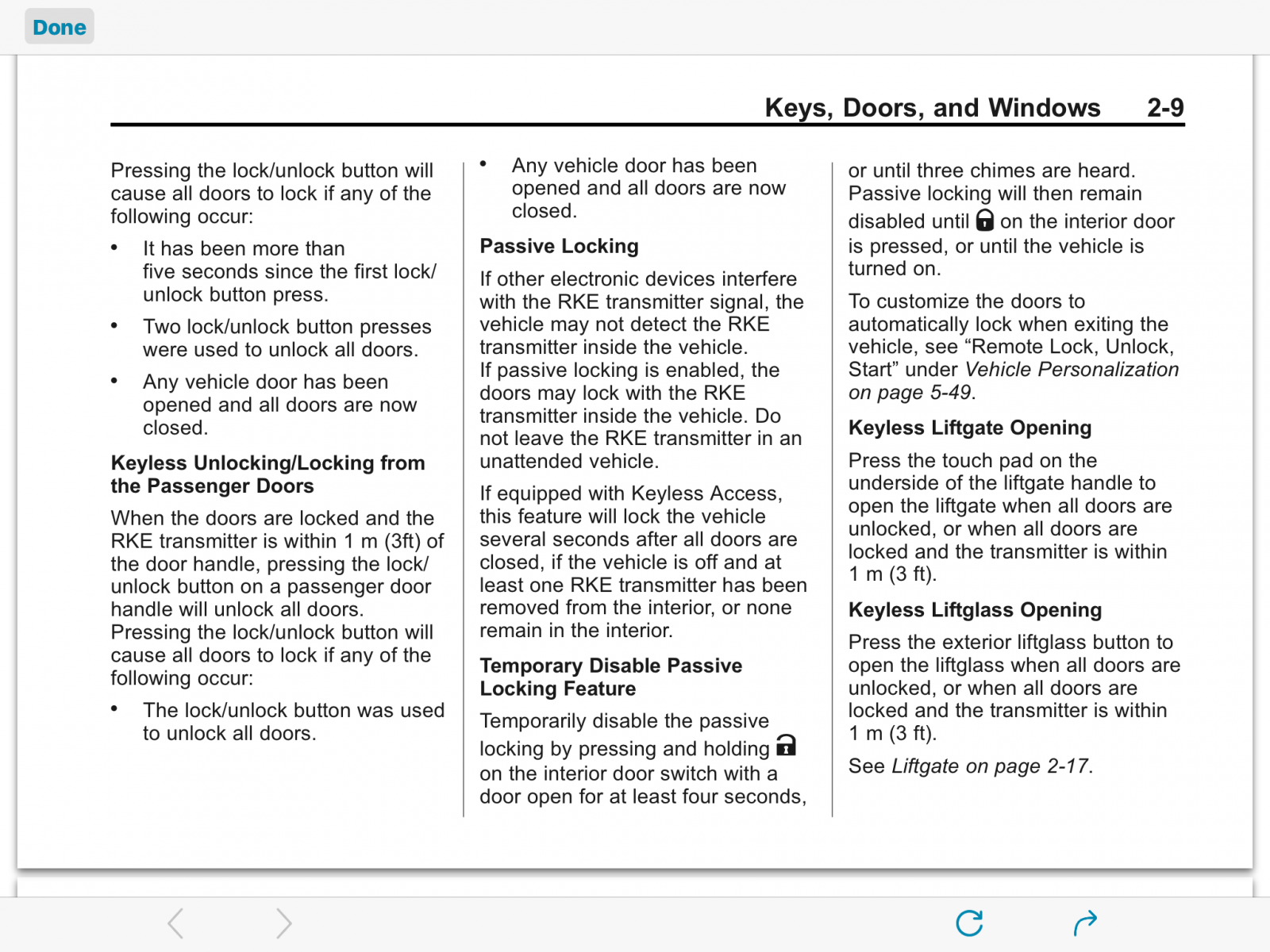

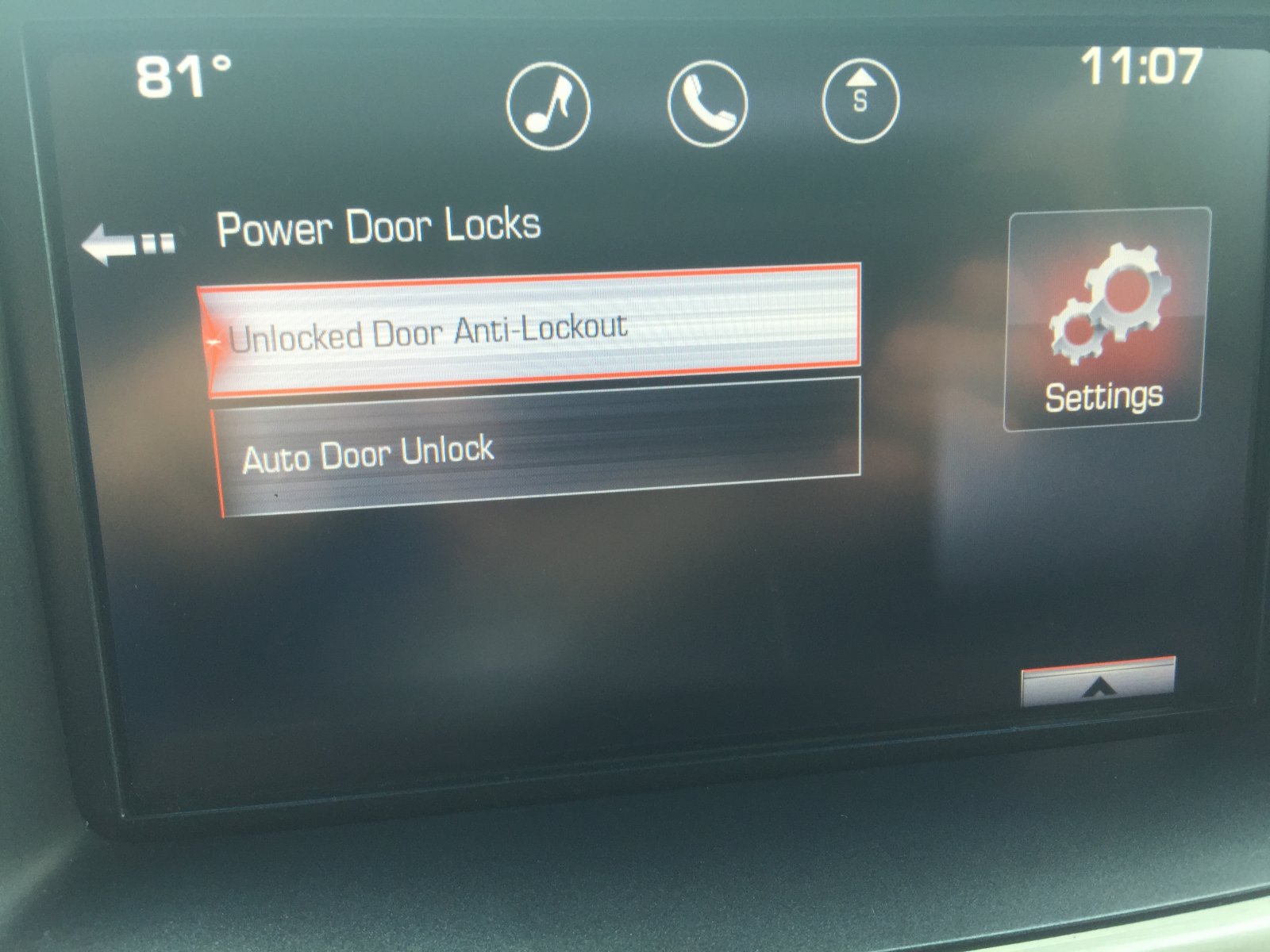

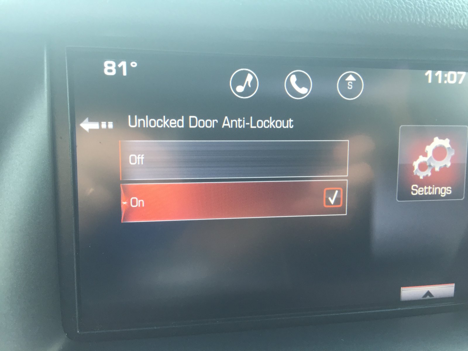

Hello in the owners manual there is a page to set your Denali to No lock with keys inside. Under the settings in your Denali. The care will honk twice to let you know it’s not locked.

According to what I understand about these trucks, I thought they were programmed to not lock automatically if the key is inside the vehicle. But I could be wrong on that.[/QU

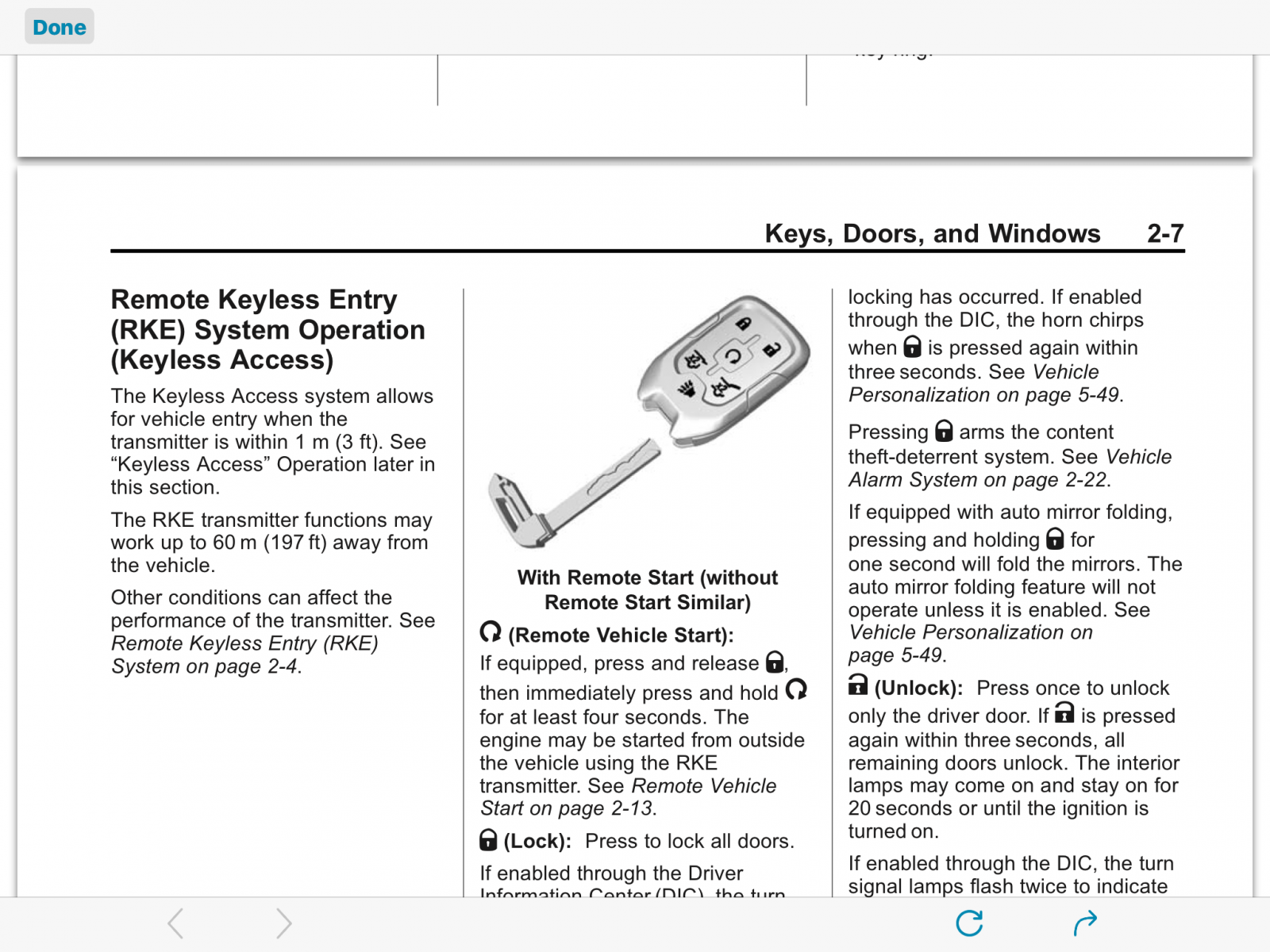

So this gen truck doesn’t have an actual key that goes into the ignition. Every truck I’ve seen has a push button start. So there’s a corresponding module in the truck that the key fob is synced with and it knows when the fob is in the truck. Or it’s supposed to know..... so it doesn’t lock.
