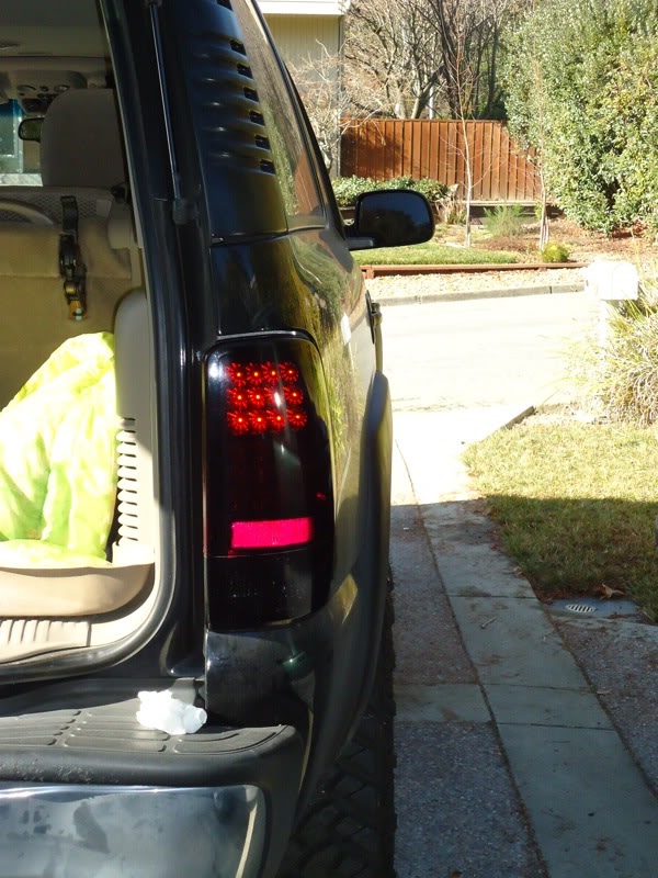

you could but it'd be messy. if you do that, you're probably better off trying to take it all off and start from scratch. otherwise, you wont know how far to sand down and you might take some of the VHT off instead of just the clear. I think you could just scuff up the clear so that the VHT would stick.
How dark do you want to go. I did 2-3 coats and they were pretty dark. Here in Cali, they'd pull you over if they were completely blacked out. Not sure how it is in Texas, but be careful.
