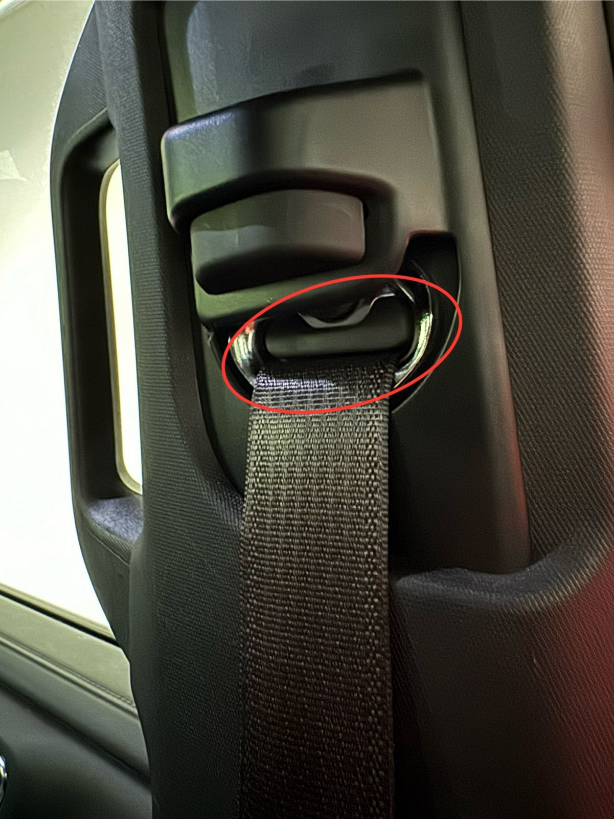

Rattle coming from seat belt area in driver side?
tahoe81
Jul 13, 2022
182
47
Noticed a rattle from where the seat belt comes out of the frame in the driver side. Anyone have an idea what it could be or what I could try to tighten to fix it? Pic of the general area attached.if I press a bit on the chrome hardware circled it seems to suppress the rattle
Big Mama
Jul 21, 2015
3,881
2,500
Virginia
Does it change if you raise or lower the seatbelt height adjuster? Are you wearing your seatbelt?
It doesn’t seem to change if it’s in a different position and yes I'm wearing the seatbelt.
30,772
48,471
probably have to pop that pillar cover open and take a look inside, sometimes all it takes is a small piece of felt or even a piece of tape to quiet up a rattle noise.
harbor freight sells plastic trim tools so you don't mare anything up, and there may be a screw holding it on, if there is sometimes they just have a plastic cap covering the access hole. haven't looked that hard at the t2 interiors yet
Thanks. It’s under warranty and I’ve got to go in this coming week for a software update and other things so I may just mention it to them. I just didn’t want it to be something where they had to take the entire door apart to do it and deal with all that

My noise is definitely coming from the seat belt mount where the belt goes into the frame of the vehicle. There's a metallic piece in there which I can press and hold and the noise will go away but I've not been able to see anything which can be tightened. Mine seems to not be as pronounced or as consistent as it was, but it's still there.

Can you loosen the bolt and put a foam O-ring or a piece of padding between the two metal surfaces?
Possibly. I've not looked too closely to be fair, but it's not immediately obvious how I'd even access the bolt to loosen it. There's a plastic cover over it which doesn't look like it will pop off in any way to present the hardware under

Get a set of plastic trim removal tools. At Hobo Freight they’re about $10, or Amazon. Go slowly starting at the end and do a little at a time.
