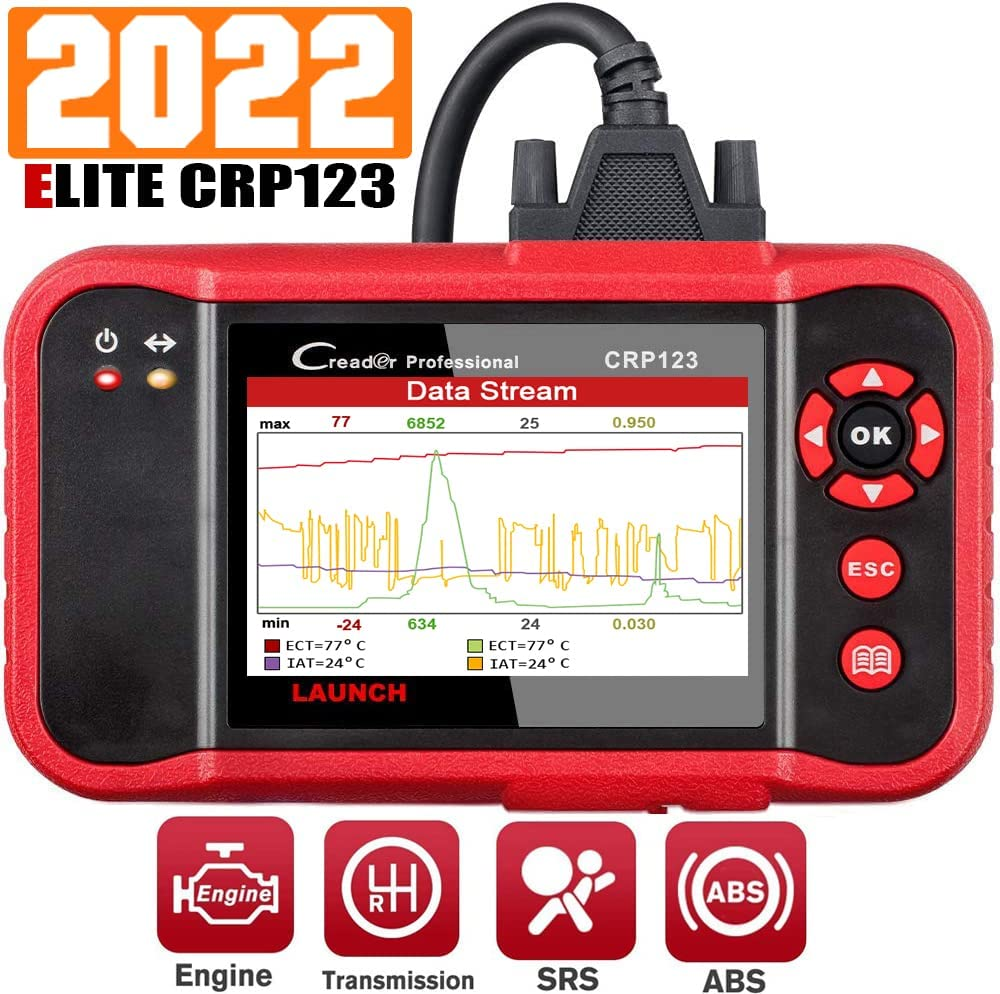

Yes, I knew this already. I have 2 basic cheap scanners I leave in the center console of each of my burbans for quick checks. I have this bad boy on order for $135 after tax:cool:

Ya mine are basic scanners I use for when I buy cars to flip I keep them in my console. I have this one on order for $135 after tax ;)
