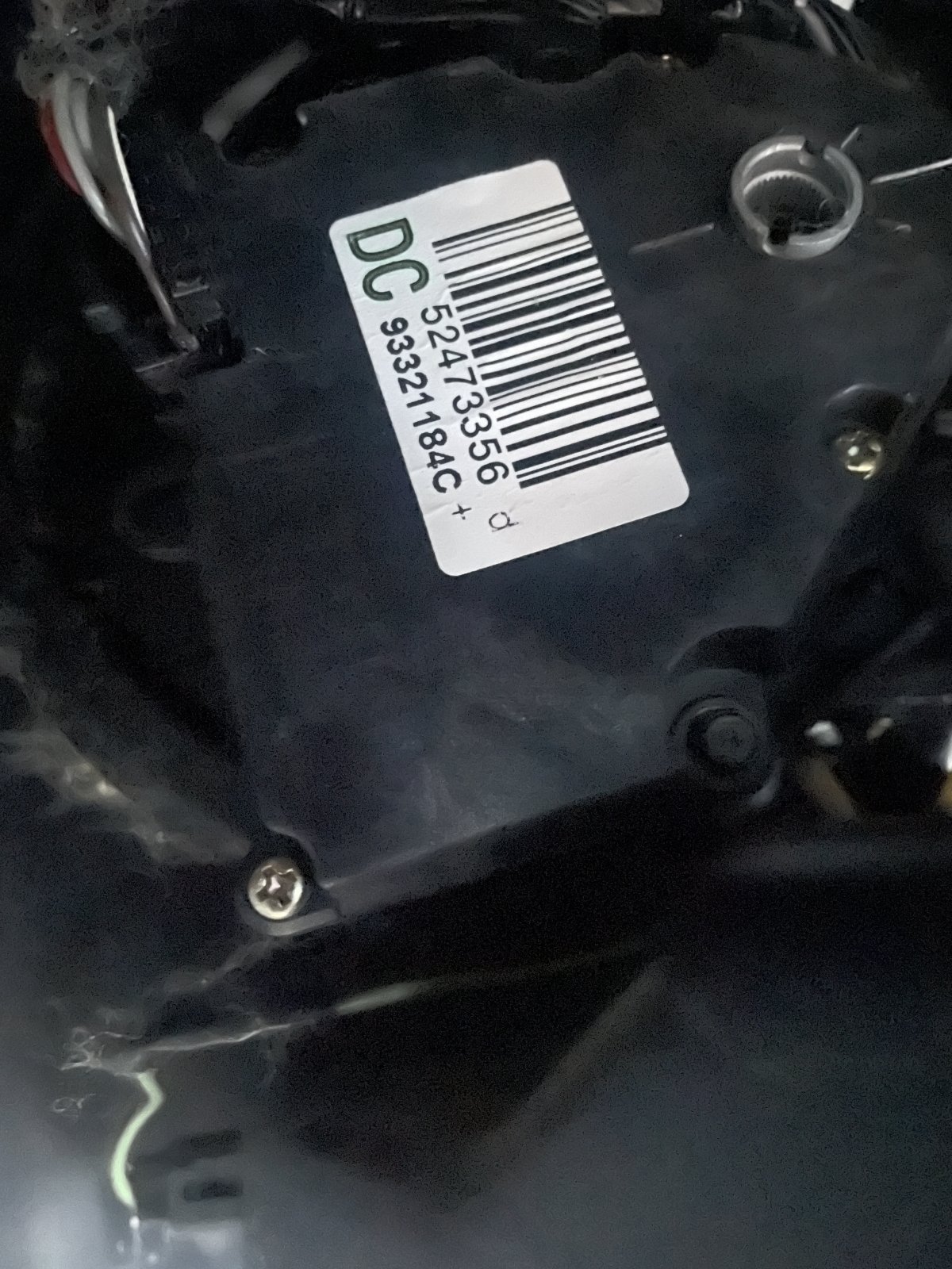

4) Only blows through the dash vents. Doesn’t blow out of the floor or defrost. I can't quite tell if it's the actuator or the controls (Any tips on telling which may be faulty? Any tests on Tech2?). Actuator part number on driver side 52473356, passenger side 52474810.

Got the new blend door actuator... before I installed it I wanted to see if it responded. I simply connected the harness to it and adjusted from heat to cold. I could see response if it was in the high seat setting, and back to cold, but no response anywhere else... Just like my old one so its not the actuator ....

Finding the fix was a rather frustrating trial and error process, and after a new mode door actuator was installed... Dorman 604-113.
There are 2 limit positions for the actuator, Defrost and Dash Vents... The problem is that when you disconnect the battery and reconnect, the control module goes through a calibration and expects the actuator to physically be in the Defrost position or somewhere in the middle and definitely not in the dash position (calibration takes it to the dash vent position and back to the defrost, so if it was in the dash position to begin with, it would hit a hard limit and set a code... and with enough attempt it probably bricks the actuator.. I guess that is B3761?) ....
Any way long story short, I installed the new actuator (arrives in a middle position between defrost and dash), so after installing worked.... well I disconnected the battery to check something else... and when I got back to it, the actuator didn't work and I saw what physically was happening during the calibration process, and how I figured what was going on.... so I had to remove the actuator again, use my scan tool to set it in the middle position, reinstall it :favorites68:
So... from here on, I need to ensure the actuator is in the defrost position before messing with the battery...
