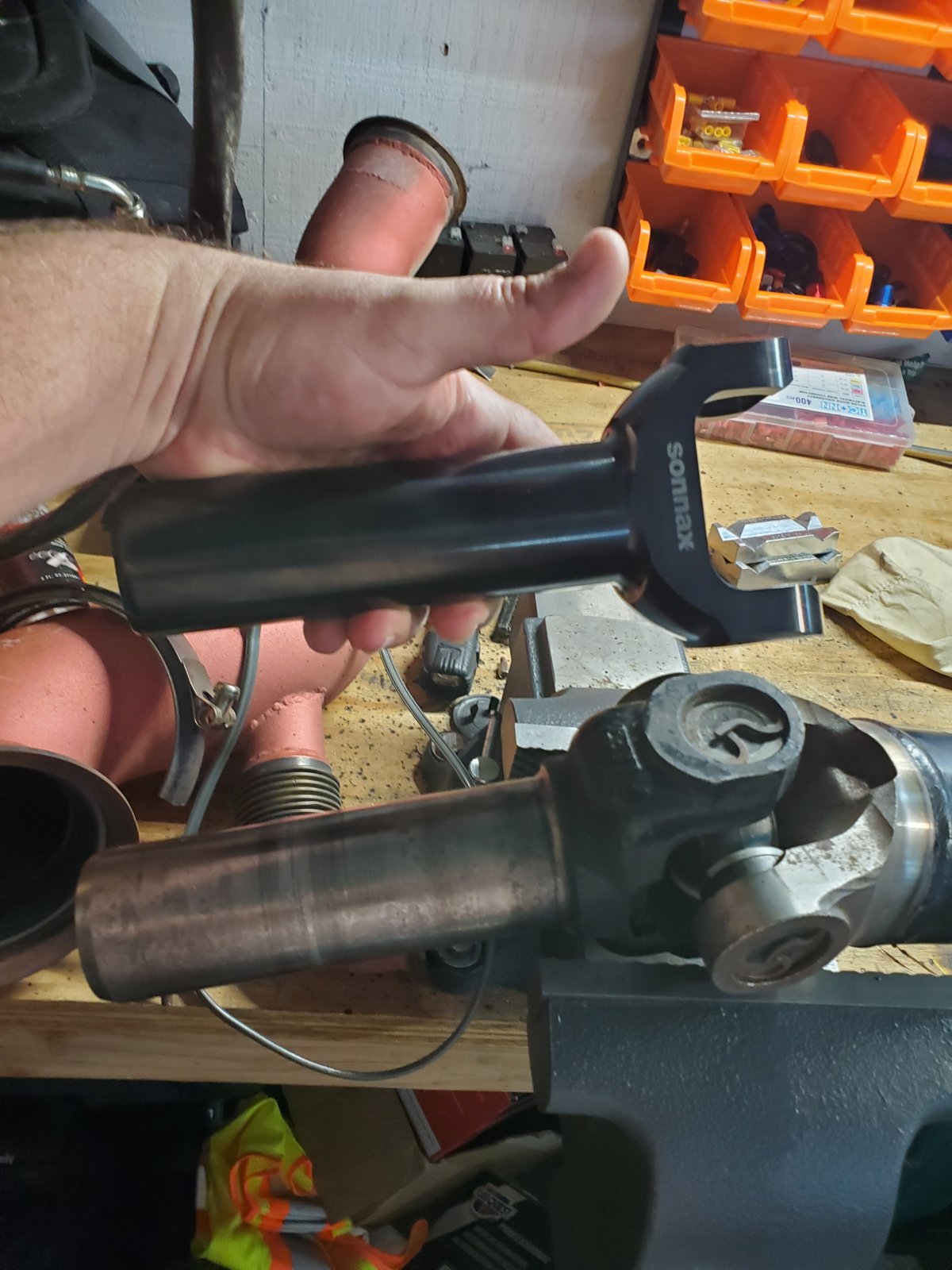

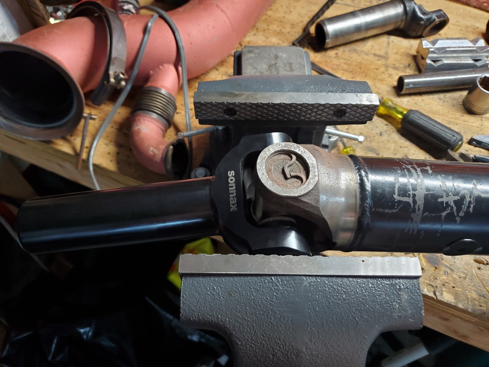

i swapped the yoke on the driveshaft to the billet sonnax one, kinda pita. busted 1 of the end caps on the u-joint...had to steal some off my old ds. cleaned up the gasket surface between the trans and t-case, uses a paper gasket that sucks. i ordered a new gasket for that and a new rear seal for the tcase, they should be here tomorrow i think.

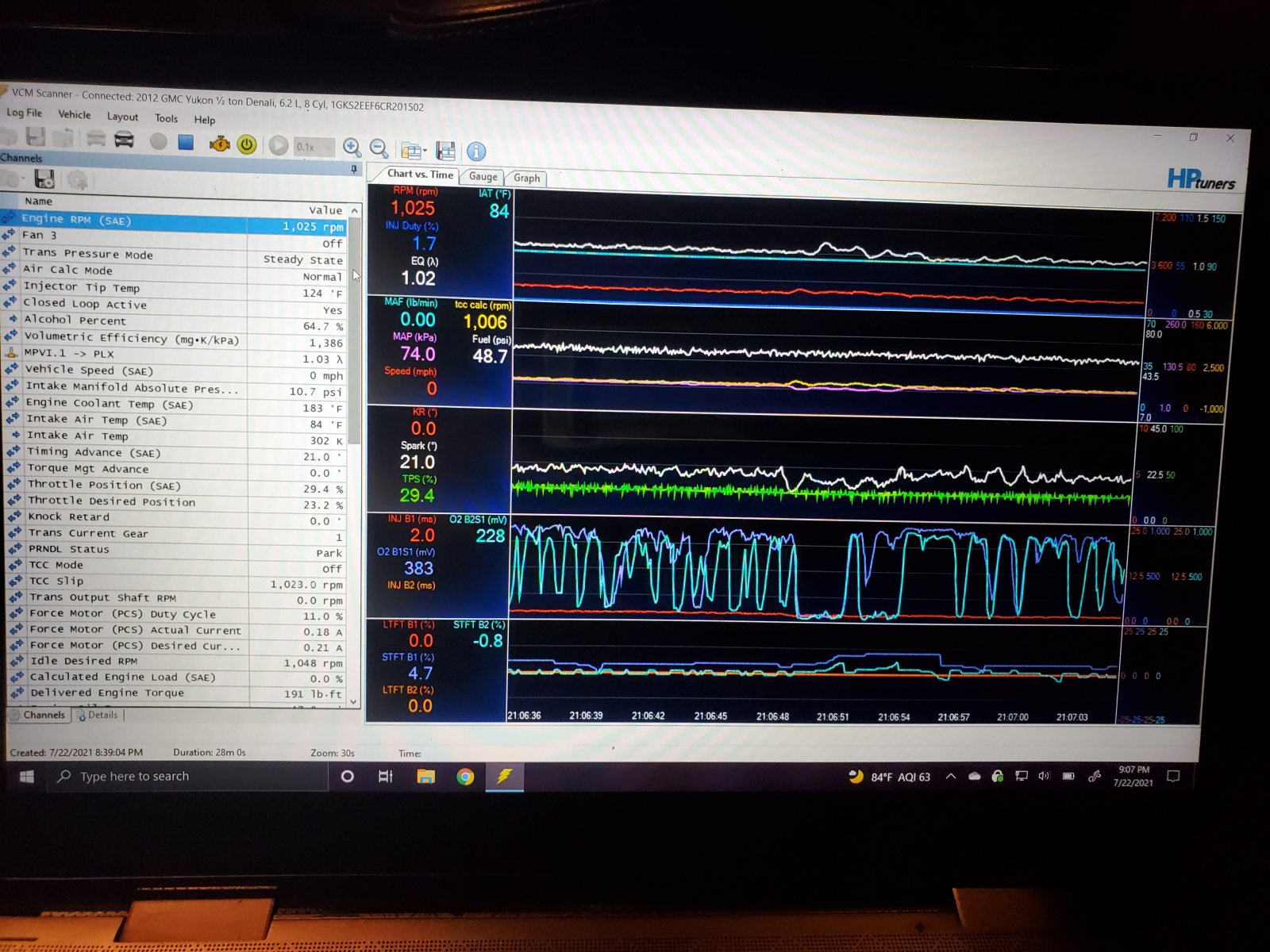

i started it and let it idle for about 35 mins, ac on for the last 15 mins (which i may need to check pressures). idling it went up to 190, fans came on and temp dropped to 169 and shut off...did this about 5x before i turned the ac on. with the ac on temp stayed around 185 +/- 5 degrees
it pushed a little water out when it was warming up for maybe a minute, not looking much into it ill check coolant level tomorrow. was smoking a little but smelled like oil - cnc heads the rocker bolt opens up in the intake runner. last time i put the heads on i saw to just use a little bit of rtv enough to coat a few threads is plenty - except it wasnt worth a **** had a bit of oil in the runners. this time i layed a nice bead in each intake runner bolt hole and run the bolt down into it. kind of surprised no rtv came out in the runner - but im hoping its just a little residual oil in there.

and temp stayed cold af, like 150s-160 so imma need to prob do something about that. highest temp i saw i think was 180 after stopping midway, crawling under, checking for leaks, ac running the entire time.
no water in the overflow bottle thankfuckinggod, i didnt do any big rips, couple little ones till the wastegates opened up a bit - kinda gun shy, its late, i dont want it to break. kind of regretting putting holes in the hood lol - i will prob go back with a single gate right on the turbo exhaust housing, in doing so routing it back into the downpipe should be a piece of cake
