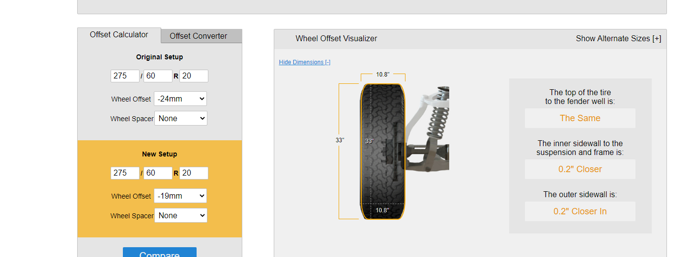

for 20 inch wheel? Just looking to see if a Ram 20 incher would fit fine for winter tire set. Found some cheap takeoffs.

Alright, i had it backwards. I thought 19mm moved it in, tiresize.com calculator is not exactly clear.

Except the factory wheels have 28MM positive offset and the ones you are considering have positive. You show in this example negative offset.
A lower positive offset moves the wheel spokes away from the caliper. The closer you get to '0' the further away from the caliper you will get and the further out the wheel will stick from the wheel well, and then below '0' into negative territory is when they really start to stick out. This assuming we are comparing the same width wheel.
