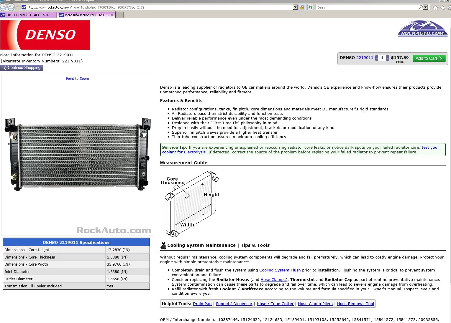

tons of choices out there with few exceptions a 34" radiator is the same from 00-14, either it has a oil cooler option or not. thickness doesn't matter for fitment
if you can hold off for a delivery this is good one, it's thicker than the ppv one and the price is good
