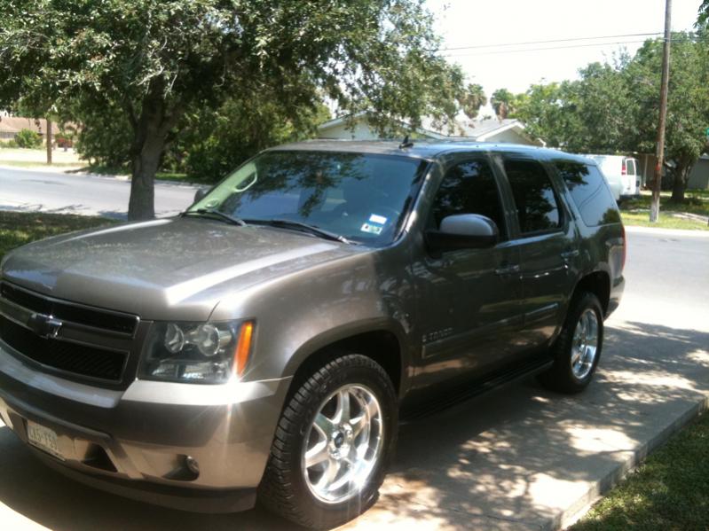

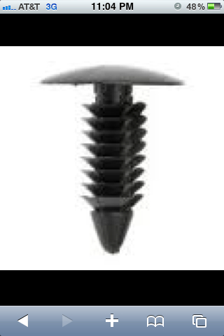

Did mine. Dorman makes a plug I bought at oreilys 3 bucks for one package. May be worth painting them white for your truck, I only saw black. I read some on a thread about 2 different guys who had issues with putting silicone in screw holes. If you look at the close up you can see the plugs

I used the same thing, and put a little silicone under each cap for retention/water intrusion. Some guys took is a step further and put down strips of vinyl door trim along the whole roof line, hoeing out the spots where the screw caps protrude from the roof line. It looks pretty sharp and darn close to OEM, but not sure where you'd find white.
