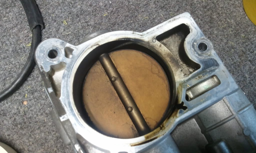

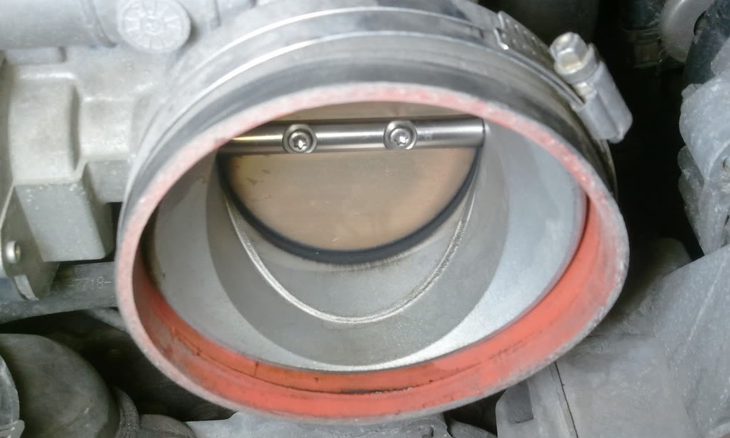

Here's a couple before pics....
---------- Post added at 09:31 AM ---------- Previous post was at 09:29 AM ----------
I have it up on stands now waiting for new hubs to arrive so I figured I would go ahead and clean the MAF and TB and paint the calipers while I'm at it. Well, that and I have a bachelor party to go to this weekend so that'll eat up a couple days
