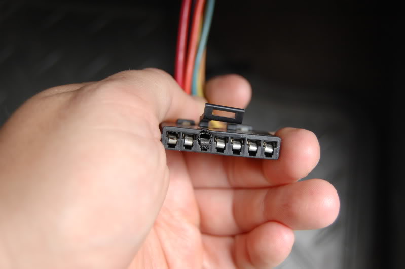

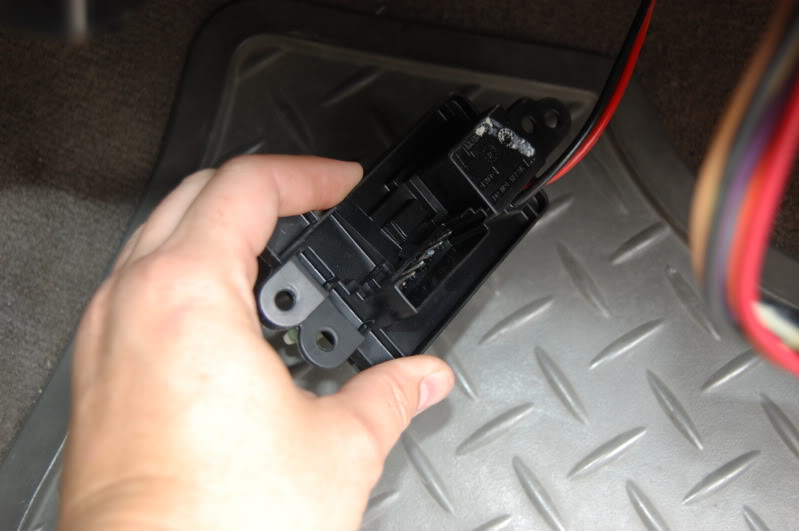

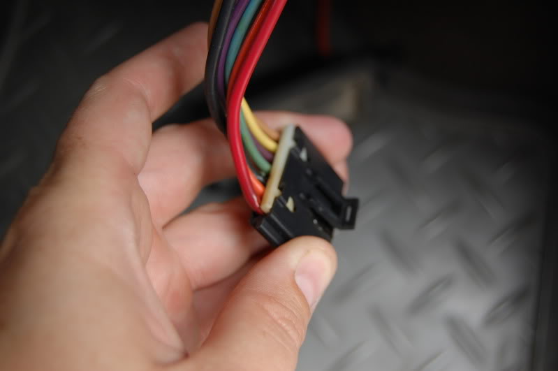

okay this is the wire harness that is getting really hot
here it shows how bad it got
it plugs into this...
which plugs into this...

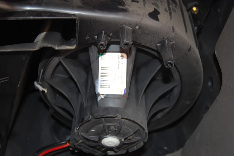

now I am pretty sure that is the blower motor, and that is the power source that it getting very hot to the point where it melts. But how do I know which relay to look at? I have checked to see if they look unusual, but how can you really tell if they are bad?
---------- Post added at 05:39 PM ---------- Previous post was at 05:38 PM ----------
from the looks of it, it looks like the wire maybe? or the harness it snaps into. If the blower went bad, would it cause the wires to burn like that?
