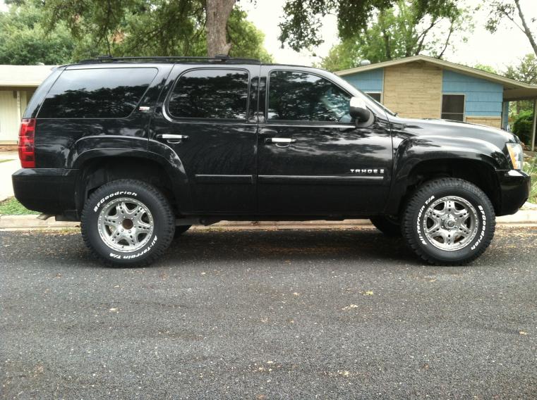

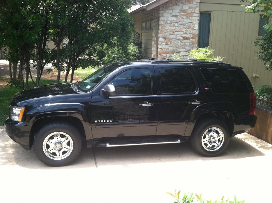

simplest/cheapest thing to do for a quick lift is a leveling kit. CCM is arguably the most popular on TYF, 2.5" front strut spacer and 1" rear spring puck. With that you could step up to 33" tires with minimal trimming. subtle but noticably higher stance than stock.
for 4x4 I've read 2.5" is about the largest front strut spacer you can safely do w/o diff drop before CV angles become pretty extreme (however I have also read a few who use a 3" spacer)
I am using a 2.5"F and 1.5" rear leveling kit and 285/65/18 all terrains for reference. Rides marginally stiffer, mostly because I run 50psi
