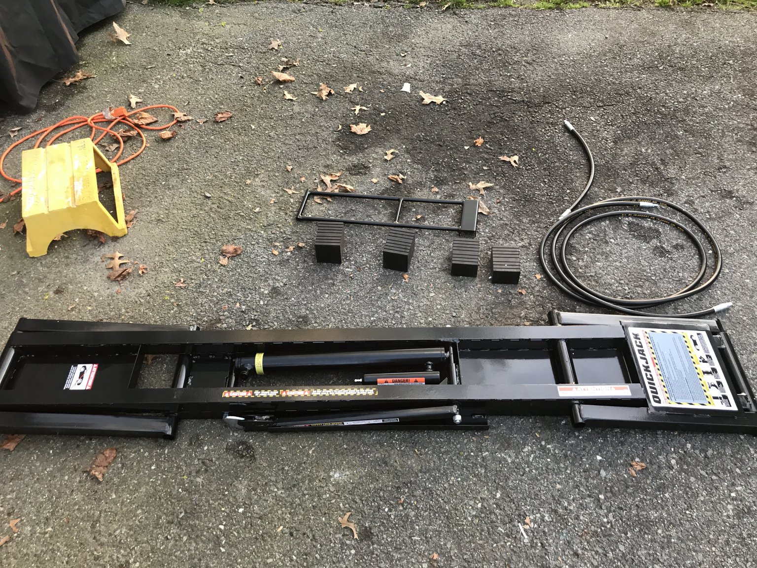

finally a nice enough day to open up my quick jack lift. It comes in a 3 box set up

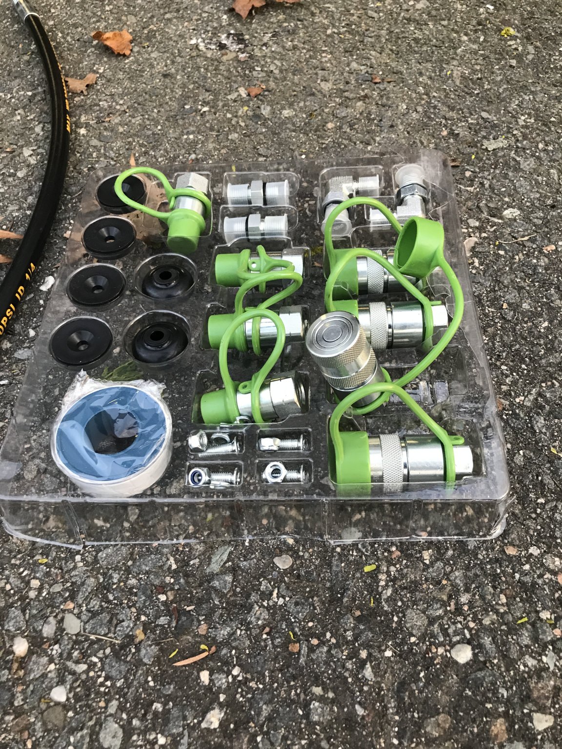

Box 1 is the left lift along with hoses, quick disconnect couplers, fittings, 2x 1.5 inch blocks and 2x 3 inch blocks.
Box 2 right side lift 2x 1.5 inch blocks, 2x 3 inch blocks and lines

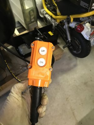

Box 3 is the power unit. I opted for the 110v but now that I think about it, i should of got the 12v power unit and use a battery and use my rapid charger to keep the battery charged from the 110 outlet. You can buy the power units separately.
I also opted to get the SUV truck adapters that can give an additional clearance or for trucks with running boards.
Hopefully tomorrow I can finish assembling and I got to pick up some atf fluid for the power unit.

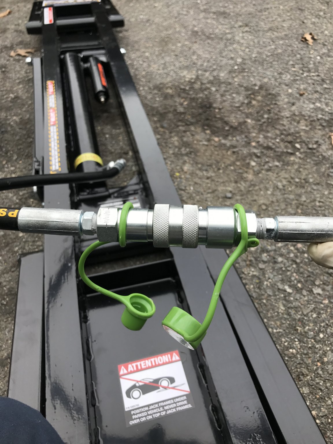

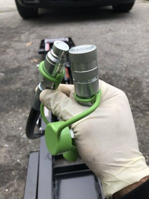

This lift is amazing. Very sturdy. The quick disconnect are top notch. Not a drop spilled when connecting and disconnecting connectors. In addition, they have dust caps so they keep dirt out when stored.
Safety bars are sturdy and thick. Also when the hoses are connected, you don't have to worry about them suddenly disconnecting if you move or bump them. The connectors has a groove on it and for the only way to disconnect the lines are lining up the Check ball and groove.

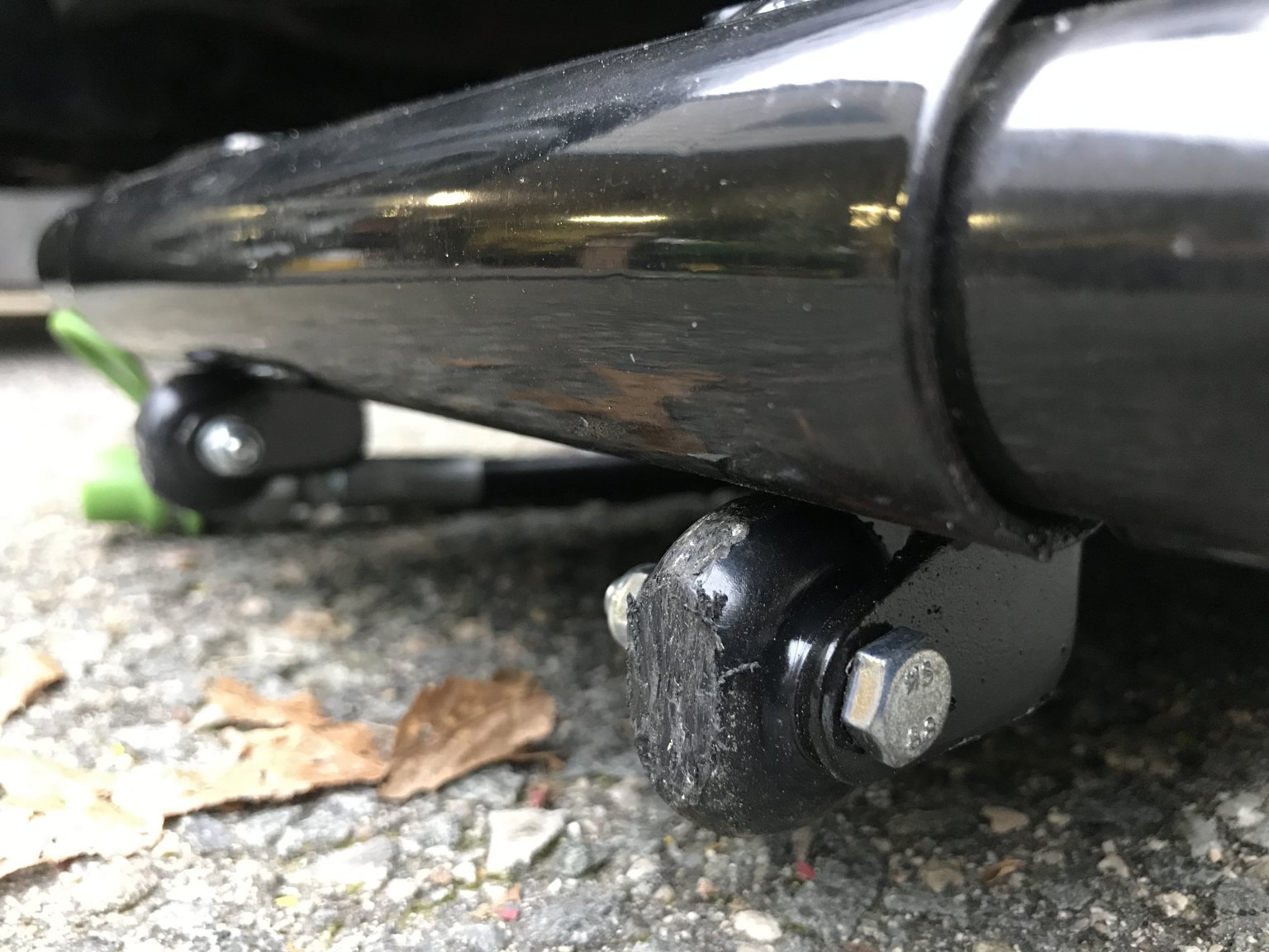

The only con about this setup is the wheels. It's a plastic line small wheel that's meant for even surface. Like a computer desk chair wheels. Mine were destroyed when I tried moving them from the garage to the drive way. Oh and don't let the guy on the box holding the one lift in each hand. Each lift is heavy

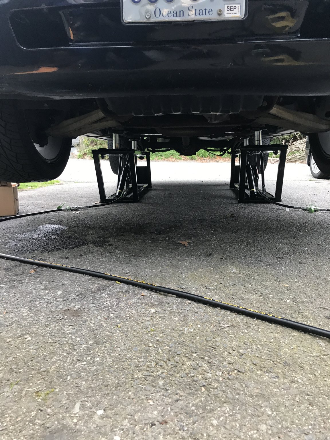

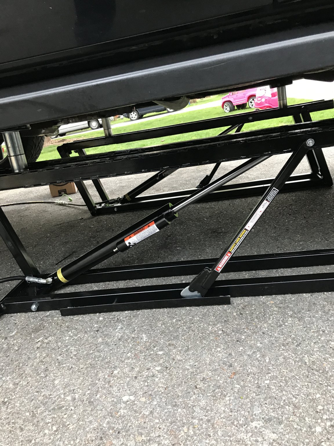

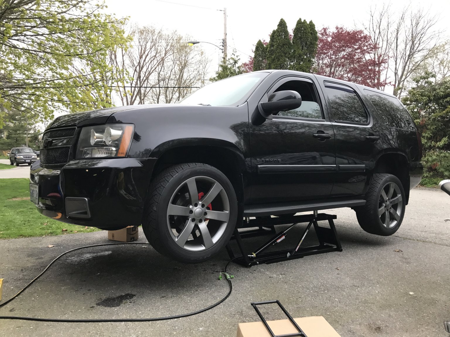

Here is it 1st initial use. It does go higher. I lost a bit of fluid during the bleeding procedure

Looks great and looks like it operates great also. It also looks like I could use it on my truck with the height you get lifting the tahoe. Also about how heavy is each side? I am thinking about storage. Also I would replace the plastic wheels with some metal ones.

It be a 2 person lift. It's rather long and I don't recommend picking it up by the side as it could pinch your fingers. As far as metal ones that's a great idea or maybe make some sort of plate where you could mount sturdier wheels
They really can't be mounted the blocks only have adjustment front to back. The manual says not to drive over them. They give you handles that sit under the lift so you can pull them towards you.
They set up two ways. wide where you slide them from outside in toward the frame or you place them together, drive over it (not running over the top of lift) and use the handle to pull them towards you.

Very handy. Just kind suck if you want to work in the middle, you have to come from front or rear as the sides are blocked by the lifts. Other than that, highly suvgested
