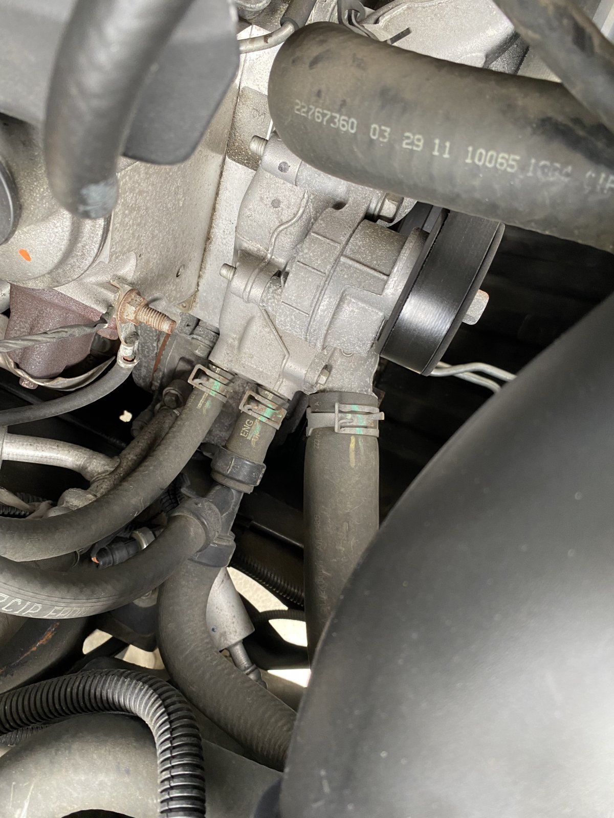

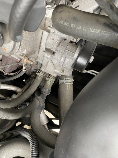

Morning all. I have a ongoing thread but just took my 2011 Yukon xl Denali with 93k on it down from pa to fl and stopped by tire kingdom for wheel balance and alignment before leaving and they said I should do a serpentine belt and upper and lower radiator hoses with a flush before heading back. Oh and the total was $753!! Lol Upon my inspection the top hose is totally fine and the lower hose is definitely a little old and soft but looks ok(see below) to me. Stopped by a small local guy and he laughed and said they have quotas to meet and looked at it as well. Said the belt is definitely worn but shouldn’t break anytime soon and the hoses looked fine and wouldn’t touch it until I got home. My thoughts are to buy a lower hose and 6 gals of antifreeze to have with me if I really need it? Planning on leaving Saturday morning. Thoughts?

Change out all of your hoses. Mine looked fine too, until one blew itself apart. This is something that you can do yourself.

Your fine don't sweat it.

I wouldn't sweat it at all on this trip, but you're due for belts and hoses for sure, if they've never been changed. When you get home, and since you have to drain the cooling system to change the hoses, I would also change the heater hoses and the plastic tees they attach to at the firewall because they are known for failing. Also change the plastic tee in the heater hose that you can see in your photo by the water pump. Dorman makes one that uses an aluminum tee instead of the plastic one in that spot. For the firewall tees, order OEM only. Order before you leave and it will all be there when you get back :)

Still have to get the tires dealt with hopefully this weekend just been a busy week since returning home from the trip. But I am trying to finalize my upcoming expenditures so I wanted to confirm a list of items I should replace and here is what I have so far as set to order from Rock Auto as soon as I can confirm part numbers, money and time (may be a bit) and compare to the transmission service as well:
Heater tees at the forum suggestions, part #'s 15055343 & 15055342, correct?
Dorman Heater hose with alum. tee, # 626553
Heater hose #22885825
lower radiator hose #228277356 (does this have to be OEM or ACDelco? Looking to save some money somewhere if possible but not sacrifice quality)
Upper radiator hose #22827731 (same question above about OEM brand)
Serpentine belt kit with pully and tensioner #ACK060935HD
AC belt with install tool #19210691
3-4 gals of Valvline pre-mixed dex-cool (system looks clean and flushed so wasn't planning on flushing everything)
All that is sitting around $360 at Rock Auto.
Do or should I install a new thermostat while am doing this? Are they known to go bad? 94k miles. Do I need to replace the surge tank hose as well? Any other recommendations or anything I am missing?
Yes, those are the correct tees for your truck
Yes, that's the one
Yup.
Lower should be 22827735. Gates radiator hoses are excellent substitutes.
Yup.
You have both a tensioner with pulley and an idler pulley. Belt is 12626222, Tensioner is 12609719, Idler pulley is 19188226
AC Belt is 19188362.
Yes, you should replace the thermostat at this time. 89018168.
