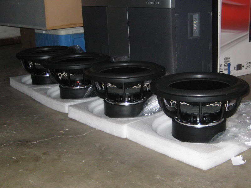

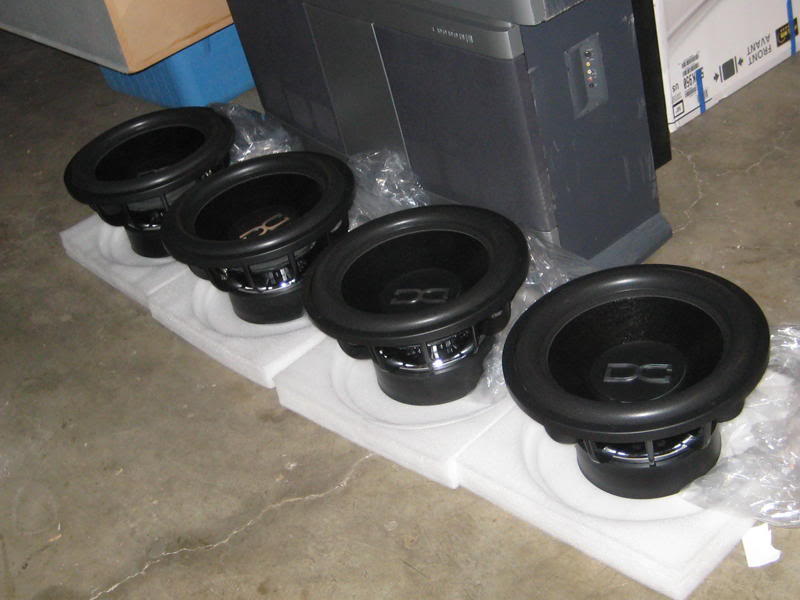

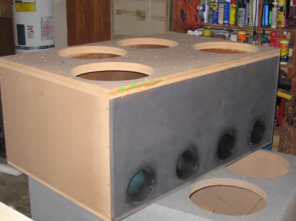

Sold my lvl 4's/lvl 5 coils. Picked up 4 new 15'' XL's. Built a new box, its ~15 cubes tuned to 30hz with 4 6'' aero's. Fiberglassed and resin'd the whole inside. Still using the RD D9 @ .5 ohms, subs are probably seeing ~5600 rms. Taking a 12 hour drive with a bunch of people from the northwest down to autorama 2011 in cali. Meca, db drag and iasca i believe are having competitions. Took a quick vid, camera doesn't pick up everything, need to break these in they are very stiff.

Nice, should be nasty. Box is about 15 cubes @ 30hz, with 4 6'' aero's. I think i need a little more port area should gone with 8'' aero's

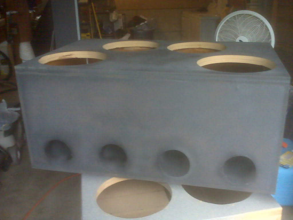

Might as well update this thread instead of making a new one. Few changes, I got a bigger amp its a Digital Designs m4a, its rated 5900 at 11.9v at 1 ohm. I'm running it at .5 daily.
People have clamped 7-9k out of theirs, very very underrated. Im in the process of deadening my roof and I have a new box in there its 16 cubes tuned to 38hz with 256sq inches of port, everything is rounded over and subs are flush mounted. The box is getting painted when I get some time to pull it out.
