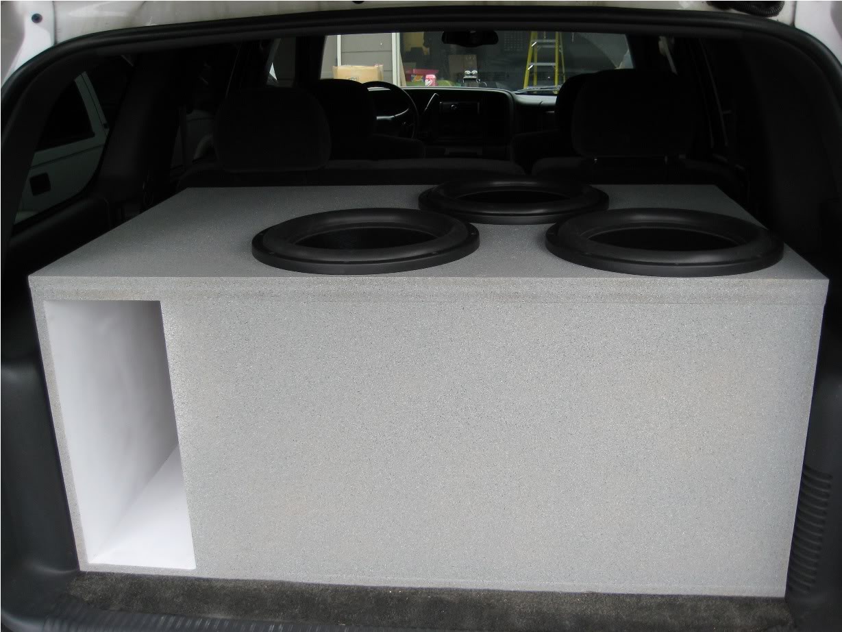

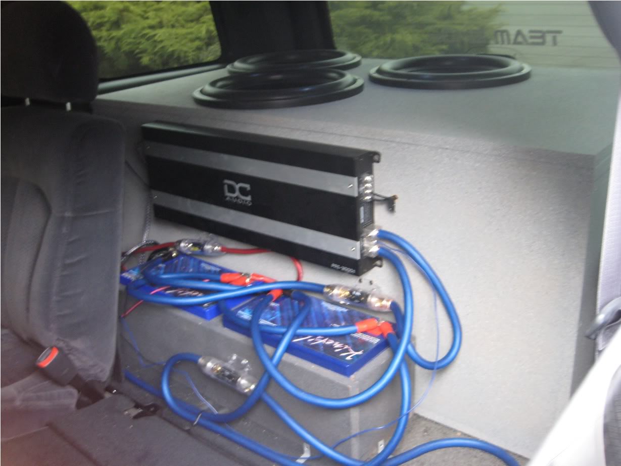

Got my 3rd DC Lvl 4/Lvl 5 Coils. Box is 14 cubes after displacement tuned to 38 hz. Ill drop the tuning later, MECA is finally coming to Washington so i tuned it a little higher than my likings for that. Amp is still the same DC 3000.1 but its now wired to .67 ohms daily. Right after i installed the 3rd sub i managed a 150.1 @ 41hz on the termlab outlaw style with the front door open. Shooting for 150's sealed up in the dash soon.

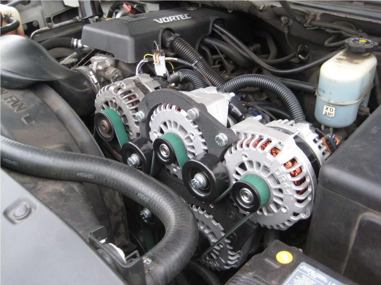

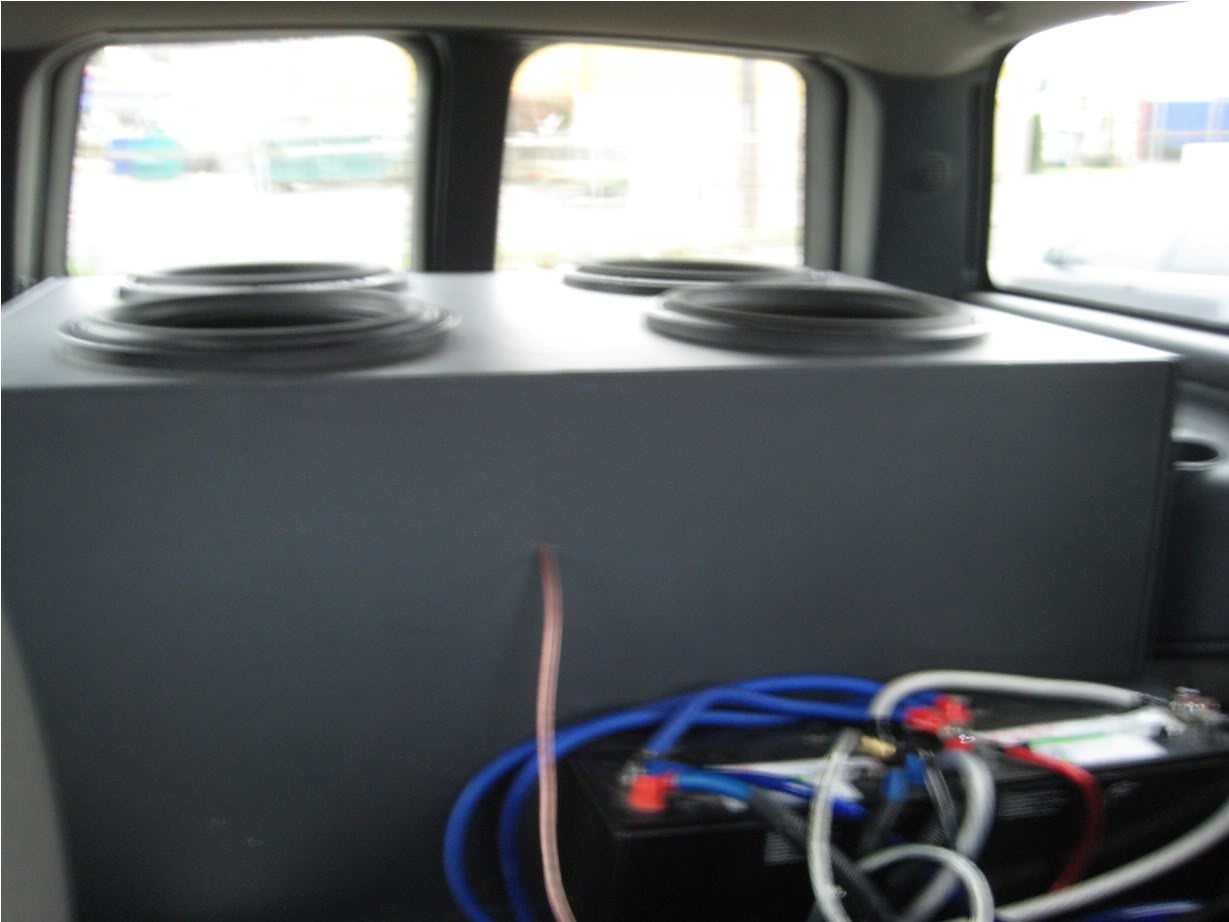

Also, met up with a few buddies, one of em has a white 2001 tahoe, hes running 4 15'' Memphis Mojo's (older versions) off an RD Audio D9 (6k+ rms) with triple DC alts and a stock alt.

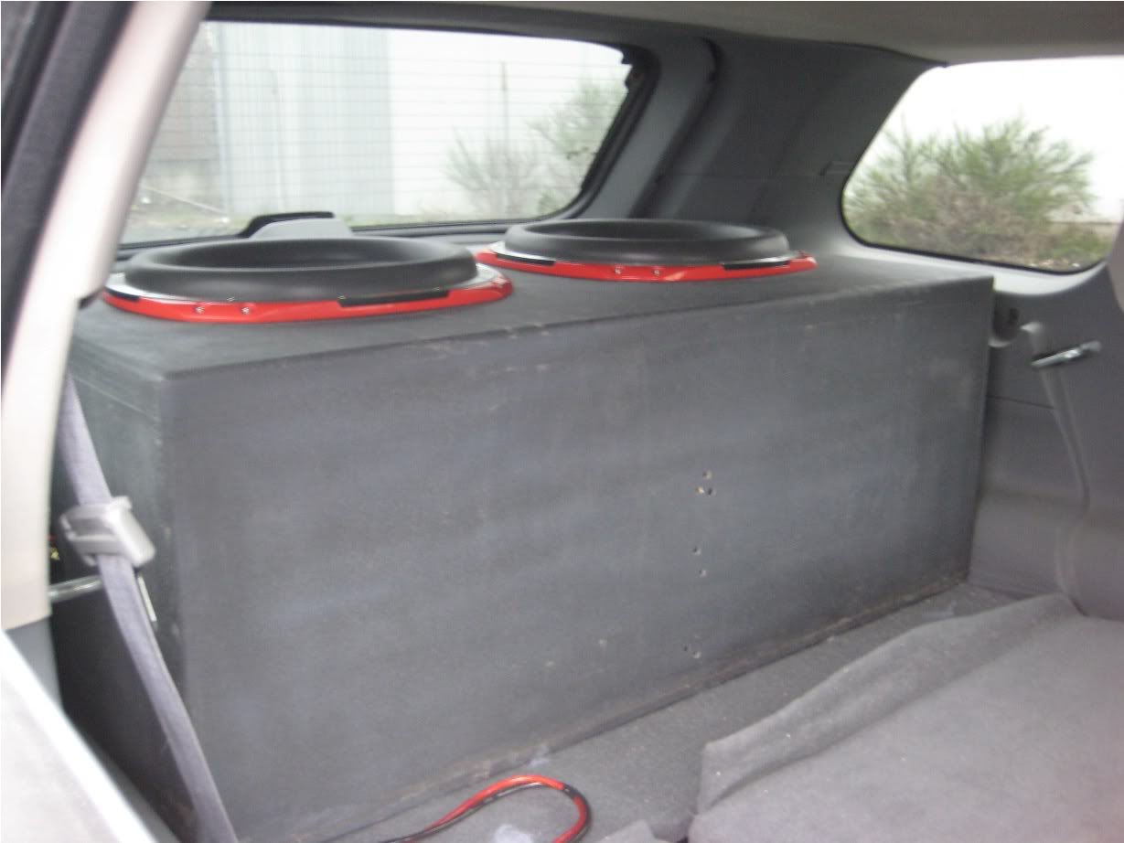

And my other buddy's jeep cherokee with 2 15'' Orion HCCA's off 5k. Hes doing 152's sealed up and 153's outlaw.

is the 240 amp alternator enough for your setup, and are those stock alternators your buddy has, and also you mentioned that you are running your stock battery up front which I assume is your standard wet battery, how does it interact with the two kinetiks

Yes it is enough, when i had 2 subs it was wired to 1 ohm, didnt have too much of a voltage drop. Now that its wired to .67 daily it is dropping more than id like to see it. I might get a 3rd kinetik, i will do dual alts eventually. And yes im running stocker up front, no problems, usually your not going to see an issue running different batteries. at least i have never with all my vehicles.

and no those are definitely not all stock alts, only the one in the factory spot is haha. the other 3 are DC power 270 amp alternators.
