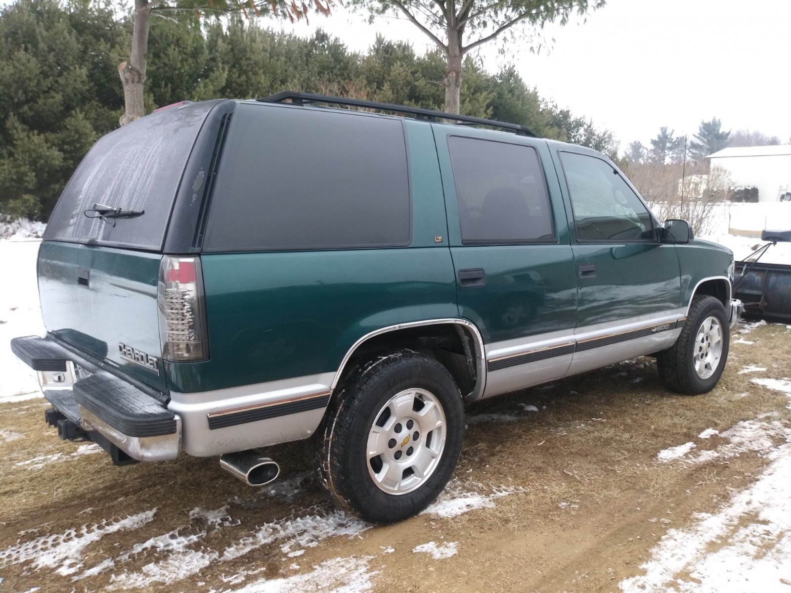

The time came to look for a replacement for my cancer riddled '95 Tahoe. Came across a '97 Tahoe that lived in Arizona forever until a few months ago. Solid and clean and for $3500 it was a good buy. With anything that is that old its going to need some incidental parts. It has the rear hatch and tailgate, not barn doors.
The rear hatch actuator works but about 1 out of 5 tries it will actually unlock the window. All the parts have been lubed well in the past and seem to work freely it just doesn't seem to trip the latch. Does anyone know if there is an adjustment or is it more likely the actuator isn't cycling the correct stroke distance?

I was able to tinker with the window latch today and I think I got it fixed. Combination of a couple things. While the latch itself was well oiled it still would stick closed periodically. Flushed it well with some PB Blaster and after some minor coaxing it was all freed up. I suspect our cold temps weren't helping the situation with some gummed up oil in the works.
The main culprit appeared to be the strike bar. While it does have a slight bend in it, the main problem was that when it slid closed it was rubbing the upper catch side of the latch fairly hard. I lowered the bar about an 1/8". Works perfect now. When the release it tripped the window moves out about a 1/4". Tried it with the key fob and dash release about 20 times and never failed so I'd say its fixed.
