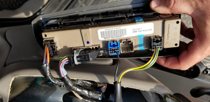

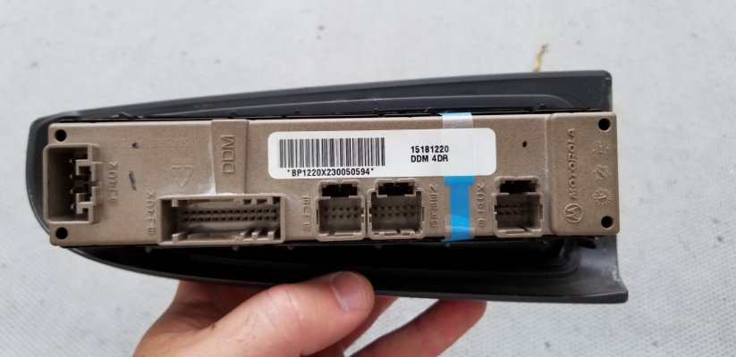

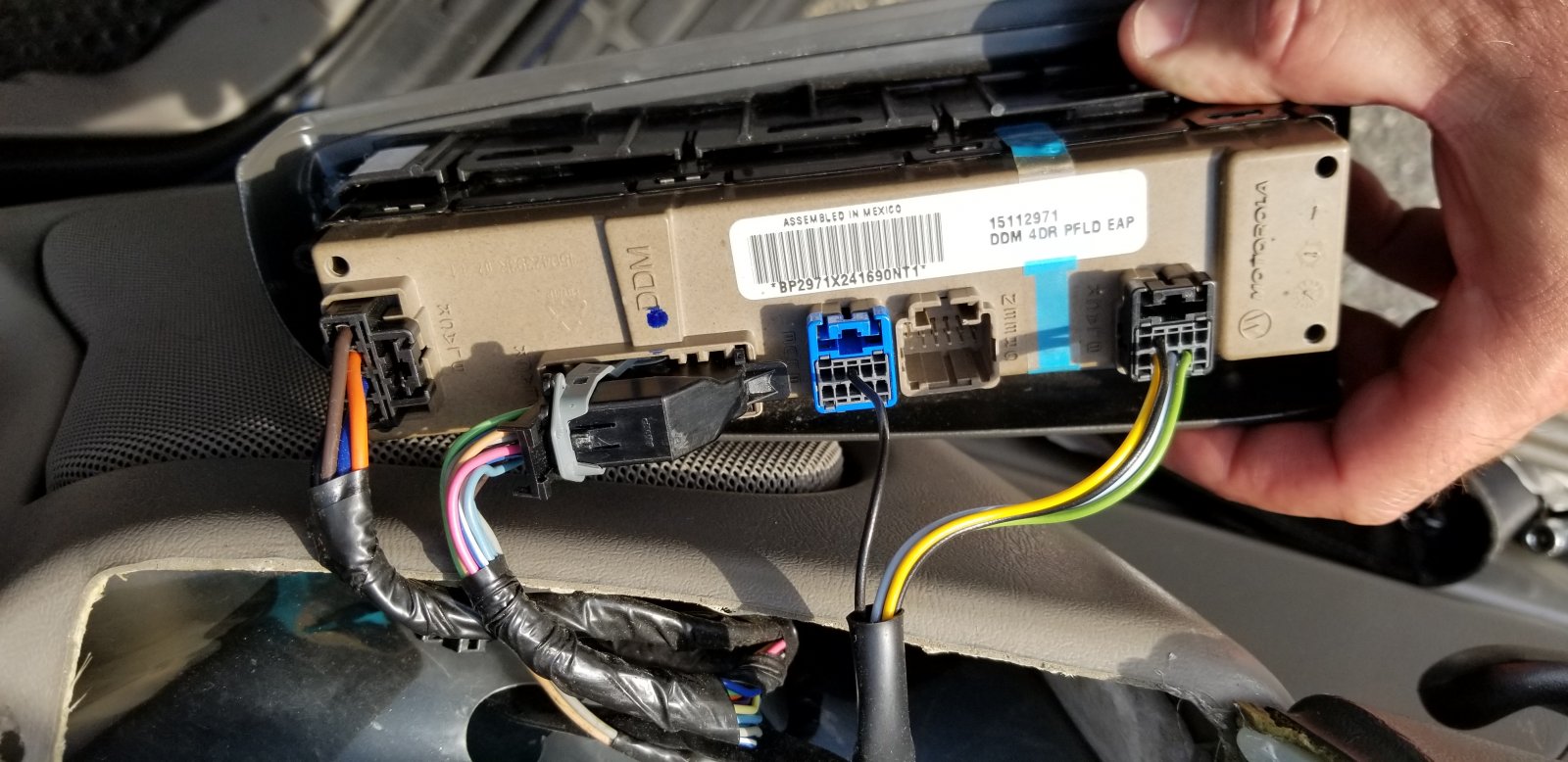

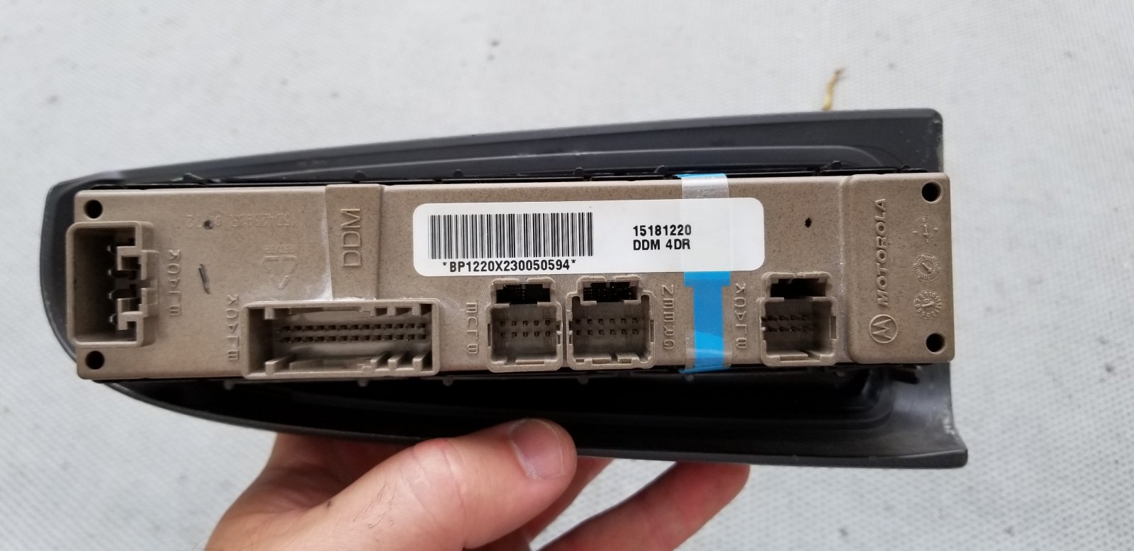

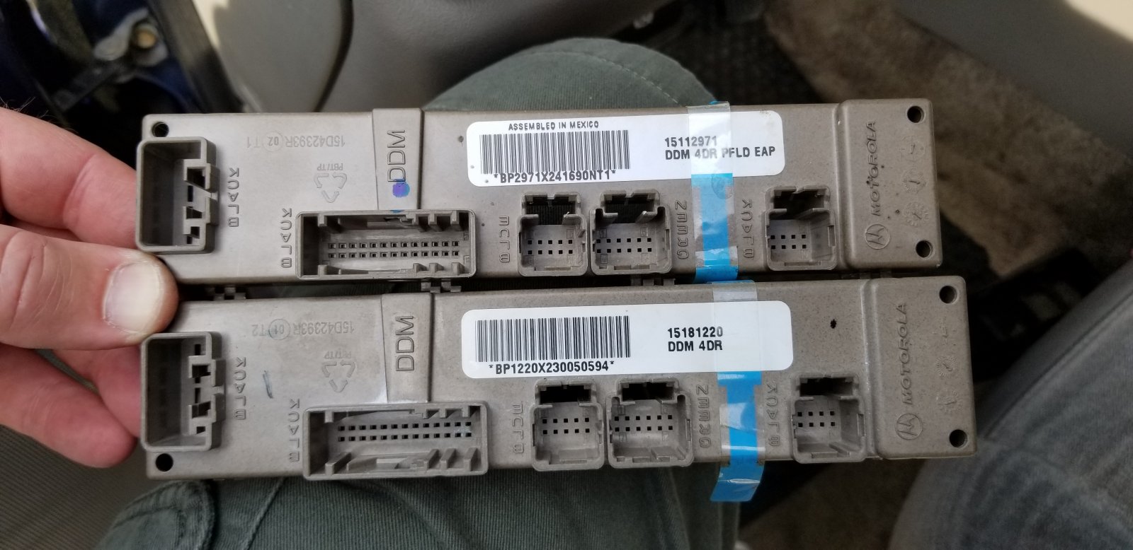

My 03 only had pwr/heated mirrors. I added power fold and blinkers.

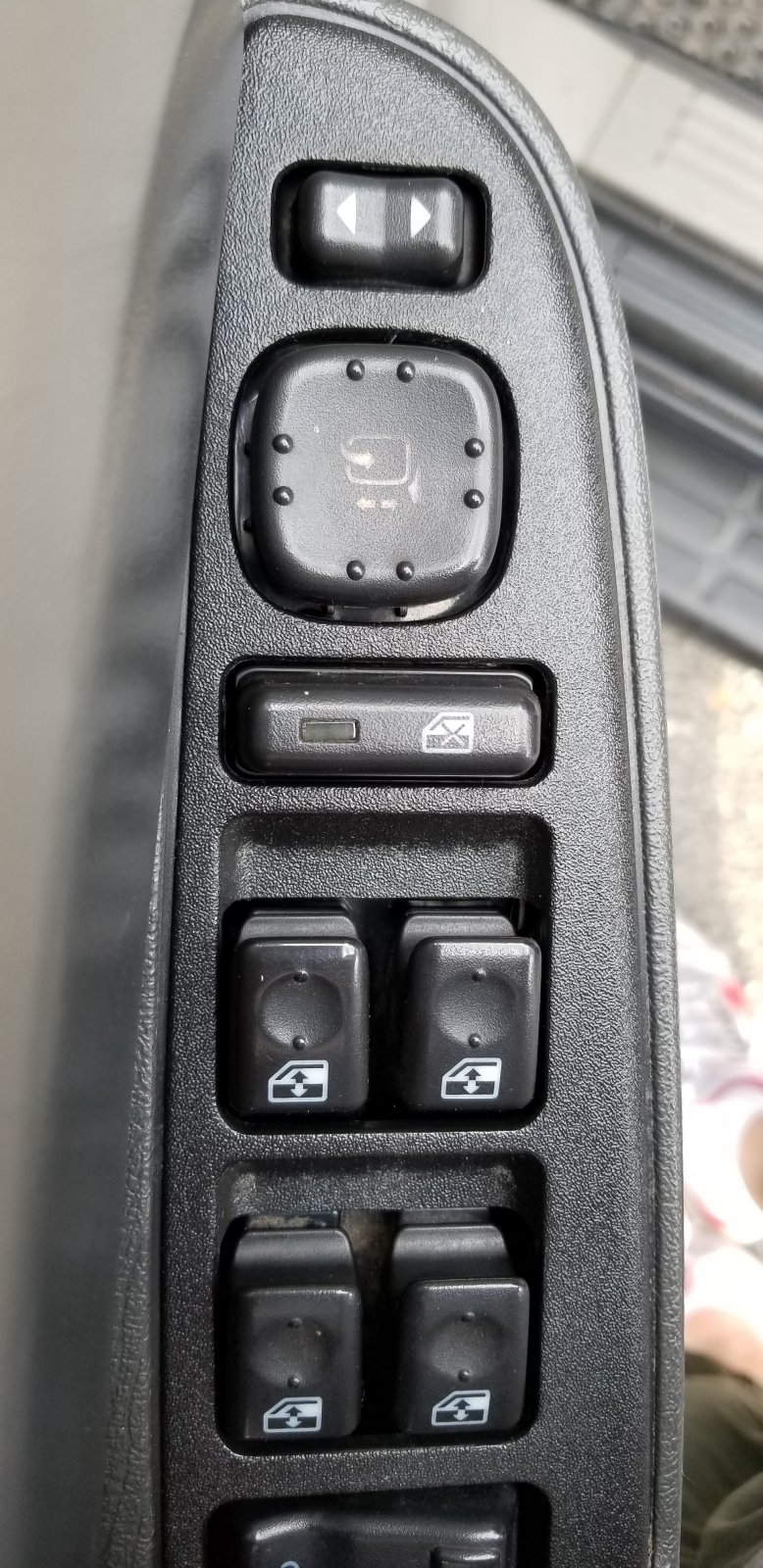

This is the original master switch on the bottom, powerfold on the top. 20180608_164456.jpg
Not 100%, but I think they'd work with your original master switch.
And if you wanted to switch to powerfold too, get some from the junkyard along with the passenger window switch and the master switch with the power mirror switch that lights up
