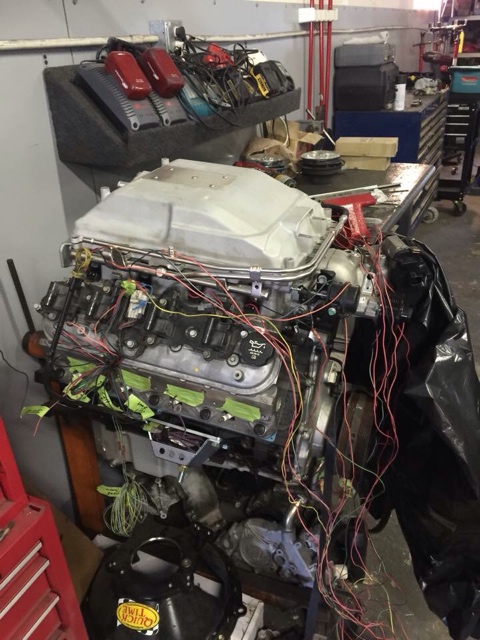

Ls9 cam, smaller pulley, zl1 lid, and a good tuner you should be able to push 600 real quick. A friend and I are currently collecting parts for LSA 5.3s. He hopes to have his done by end of December and plans to be over 500hp with the 5.3. I'll be happy with anything over 400rwhp. Just wake up the passing power.
Friends build, but with my CTS-V lid. 5.3 with 241 heads, 4.8 flat top pistons, and ls9 cam.

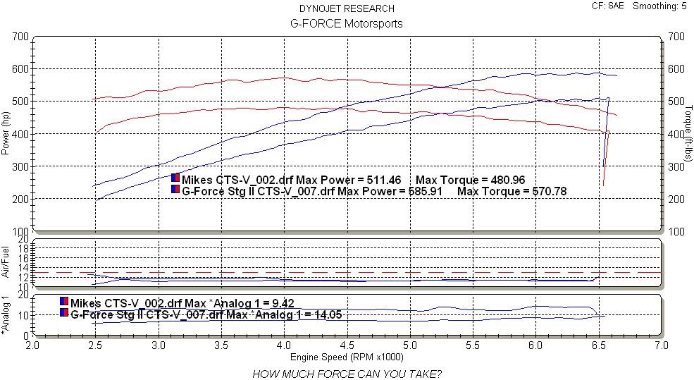

I've actually decided on the LSA cam. Slightly better low-end power and torque, but drops off at 5,000 rpm where the ls9 continues to pull to 6,000. Don't need that in the ole suburban. Hopefully just got a cam and throttle body off of a CTS forum.
The fairly flat lines are the LSA cam, the rising lines are the LS9.
