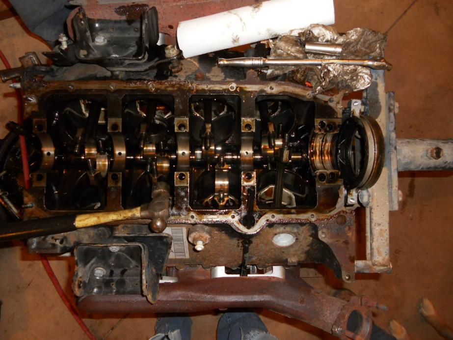

got it out, spun a barring the jurnal for 7&8,#7 was shaved down a couple 1000s of a inch so a good cleaning new crank kit and oil pump and shes goin down the road

?You spun a main bearing and you are going to throw new parts in without a line bore??

I think at this point it's time to either send this motor out for machining and rebuild or swap it out for a new or new rebuilt. You're already over halfway there. You can probably get one for around 1200.

its fine i did the same in my old truck samething happened and it went for anothe 40,000 till the tranny took a shit.
